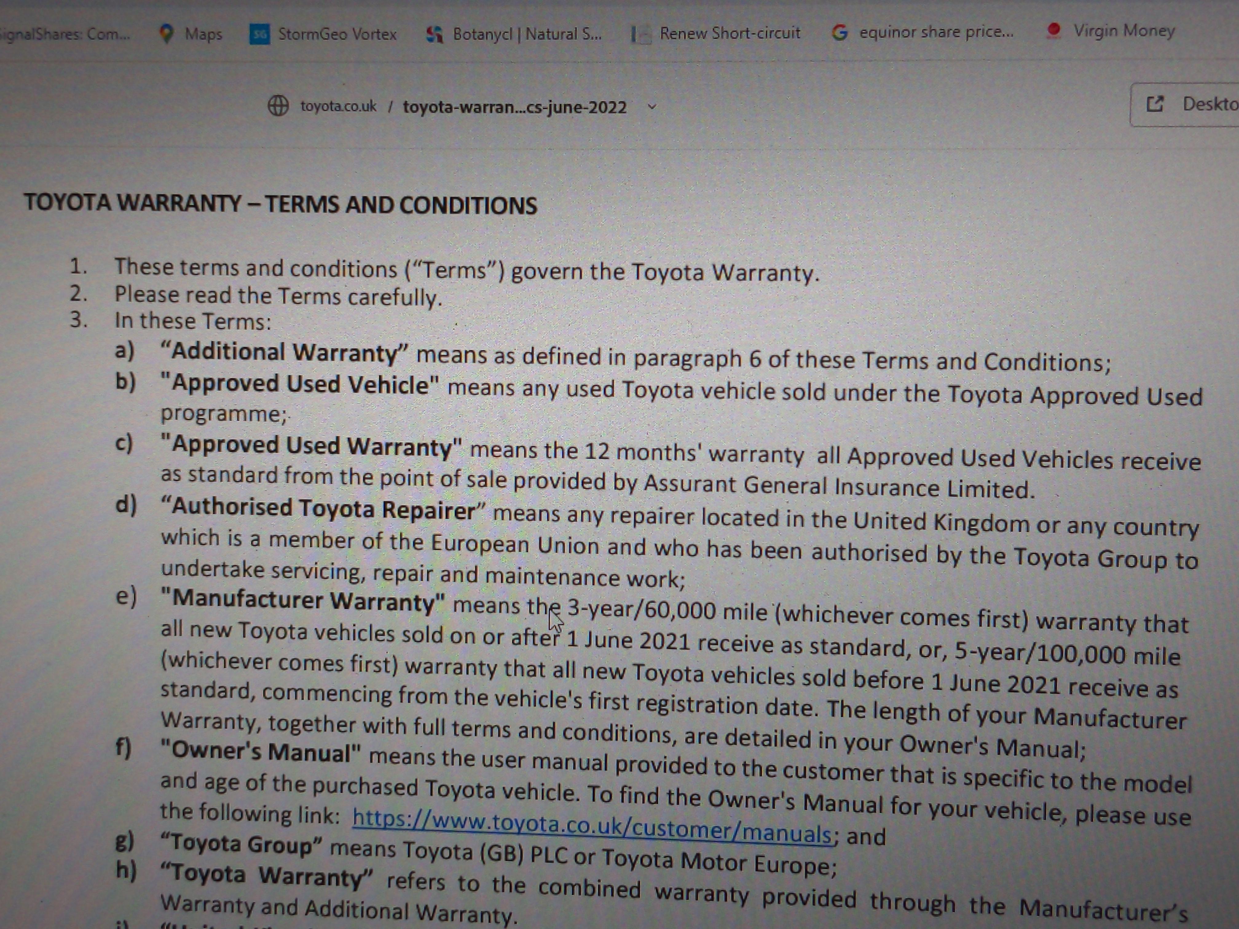

Just found this online and under section 3 E it sates it has a 5 year warranty because it was sold before June 2021.
I can't see any conditions on this tho???
TBH, I don't think that is quite correct, but who am I to argue with what is written in black and white. Toyota UK are saying that you have a 5-year manufacturer's warranty - that won't expire until June 2024. So, you are covered. The "Gears and Shafts; Synchromesh" are covered even under the Additional Relax warranty so you should continue to be covered up to 2029!
