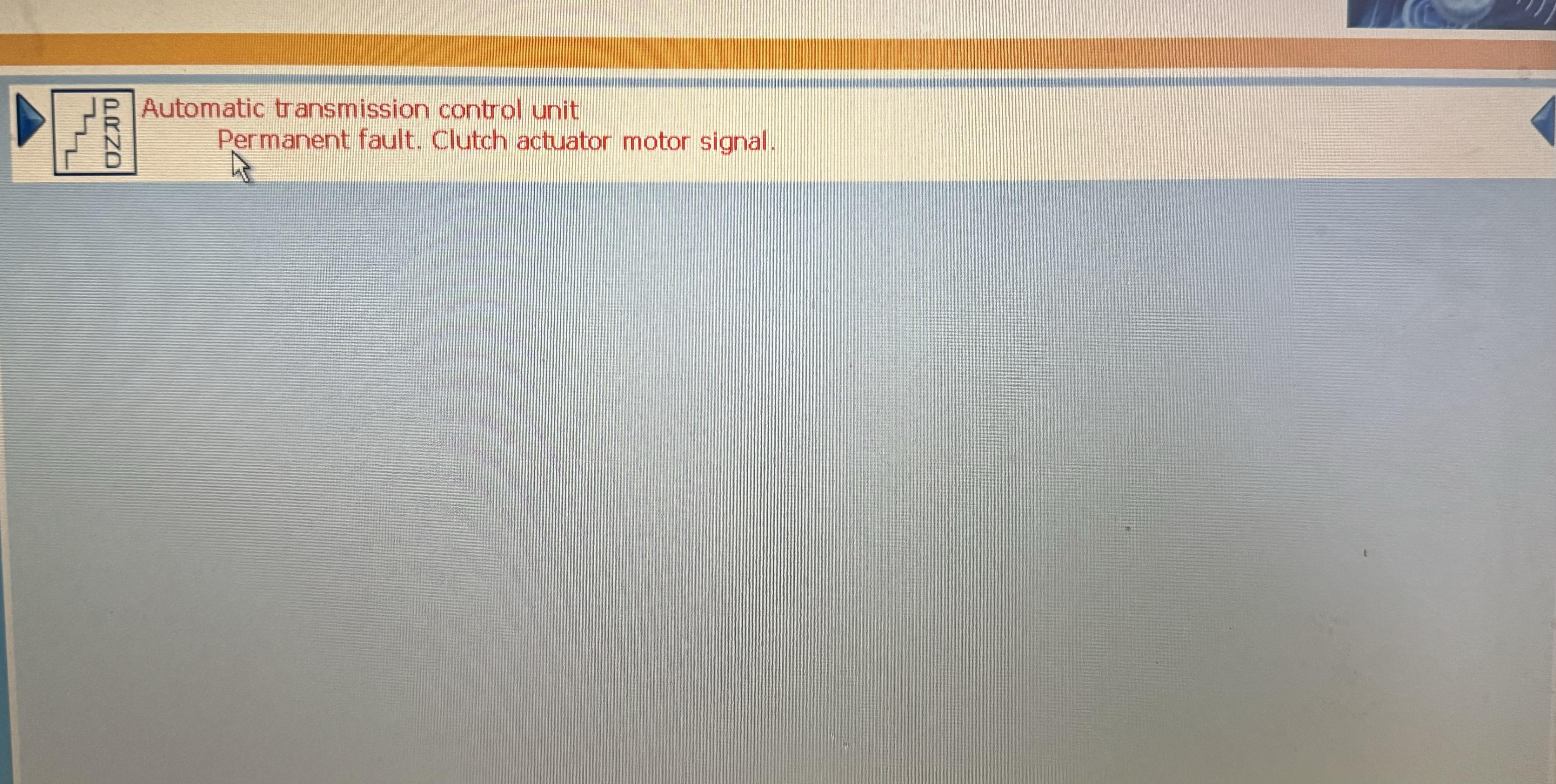

I recently bought a Toyota Aygo MMT with a gearbox issue. I connected it to a diagnostics computer and received the following error message:
"Automatic transmission control unit
Permanent fault. Clutch actuator motor signal."

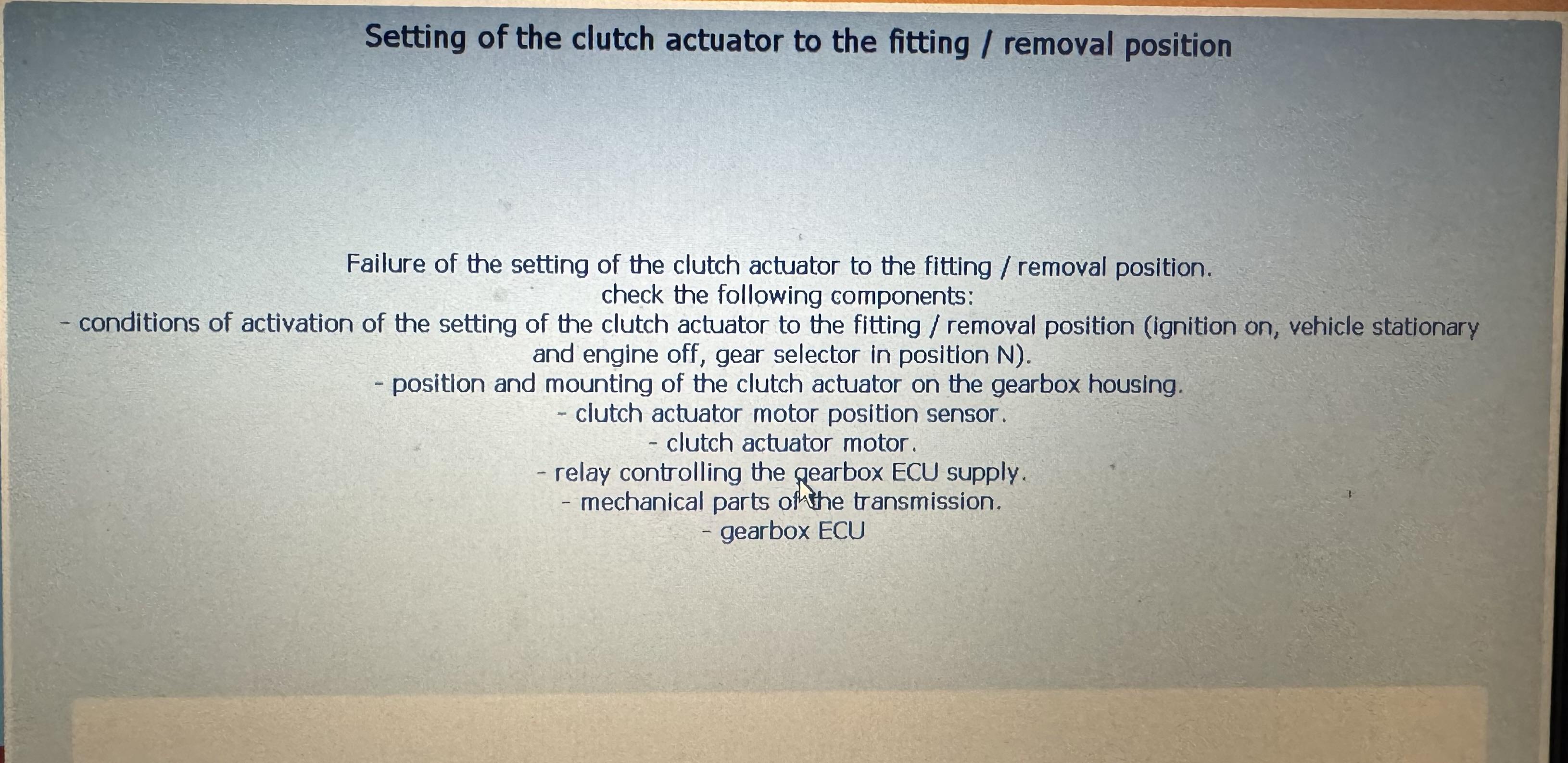

I have already replaced the actuator with a known good one, as well as the gearbox relay and checked all the fuses. However, the same fault persists. Additionally, when I run a gearbox actuator test, it shows as successful but none of the actuators actually move.

It's maybe a dead MMT ecu, more than likely the outputs have been fried
i take it you have done a full relearn

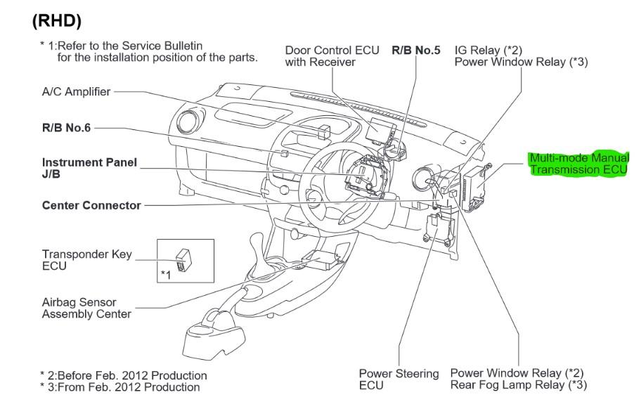

there are early and late mmt ecus and replacement parts
it should start with 89530-70xxx  the last 3 digits are important, please post the part number on your unit iirc it lives under the dash on the driver's side
My number is 89530-70021.
I appreciate all the help 👍
@Flash22
The updated mmt ECU for your car will be 89530-70100
