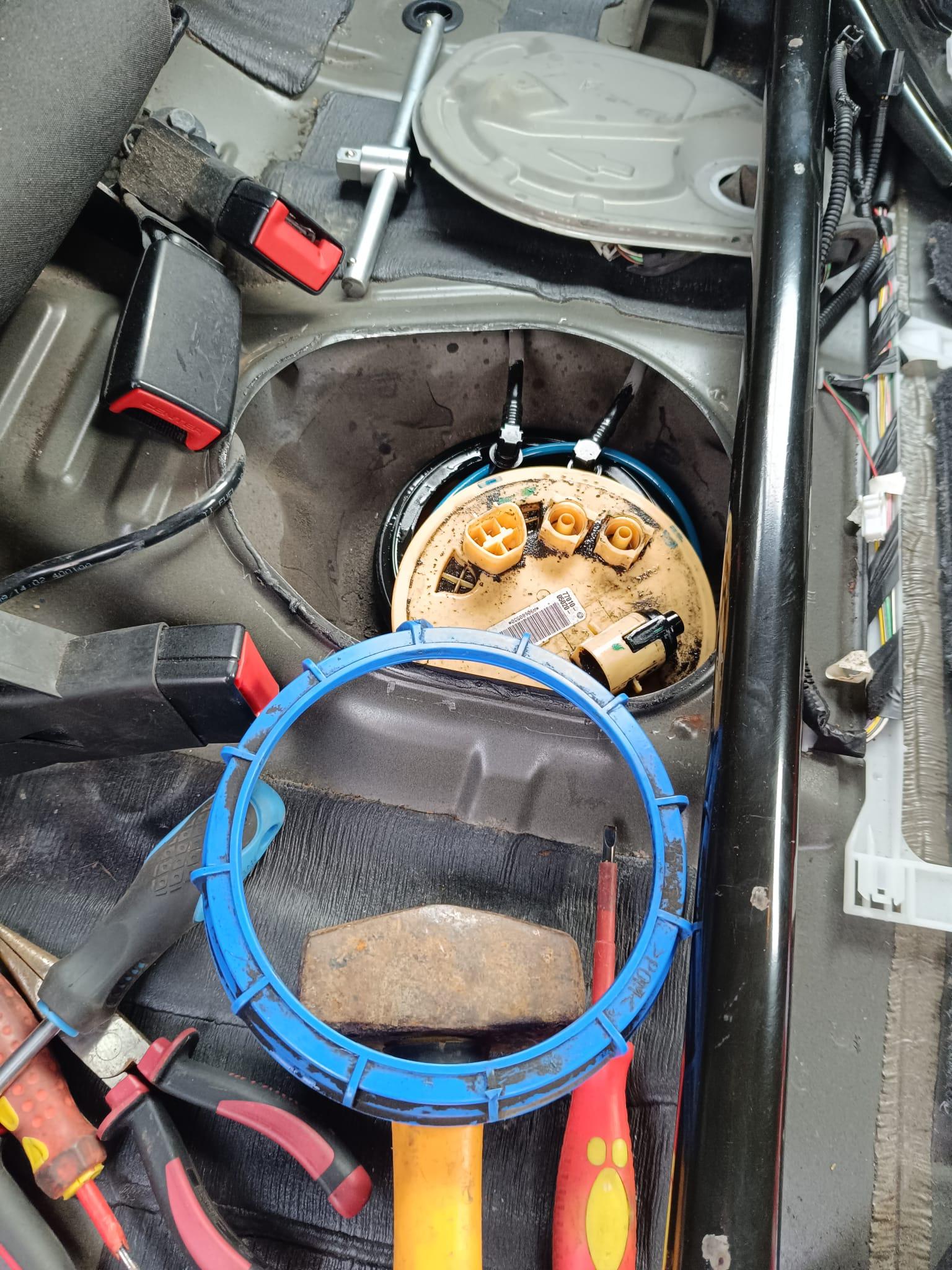

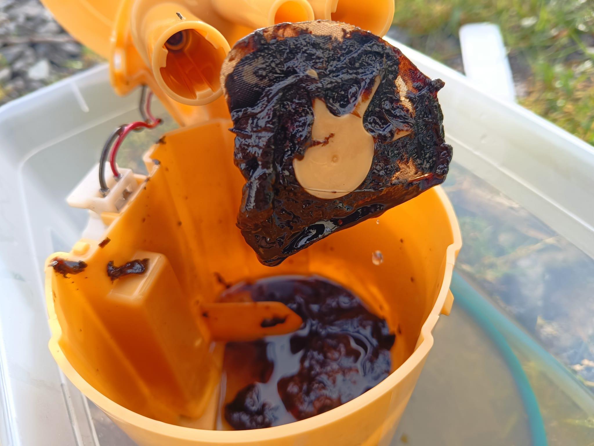

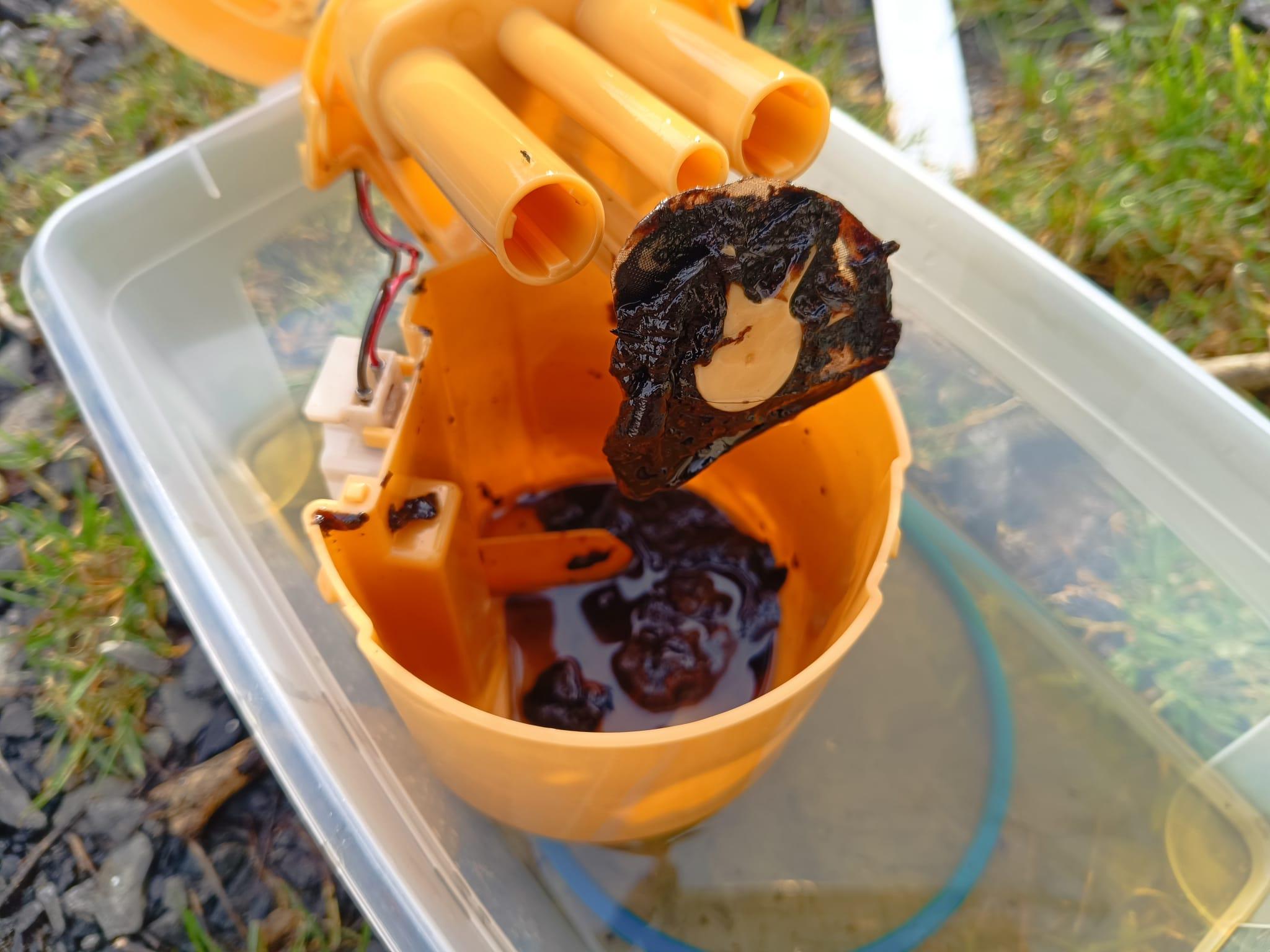

So Tuesday, i took the day of work, removed the back seats of the Avensis and after some colorful language, got into the diesel tank of the car via the hatch. I removed the fuel sender pump, disassembled it and found a load of thick black gunk inside and all over the filter....this crap had effectively choked off the supply of fuel going to the engine. See the pictures.
Soaked the lot in Redex diesel system cleaner, scrubbed with a toothbrush and rinsed with petrol. I then changed the fuel filter under the bonnet, pumped the 'bad' diesel from the tank (thank ***** Im stingy, there was only 20 litres or so in there). Then loaded up with fresh diesel and have not had a problem since!

Great post and well done 👏. Incidentally what did you use the lump hammer for ??. Did you have an electrical problem 😂🤣🤔
