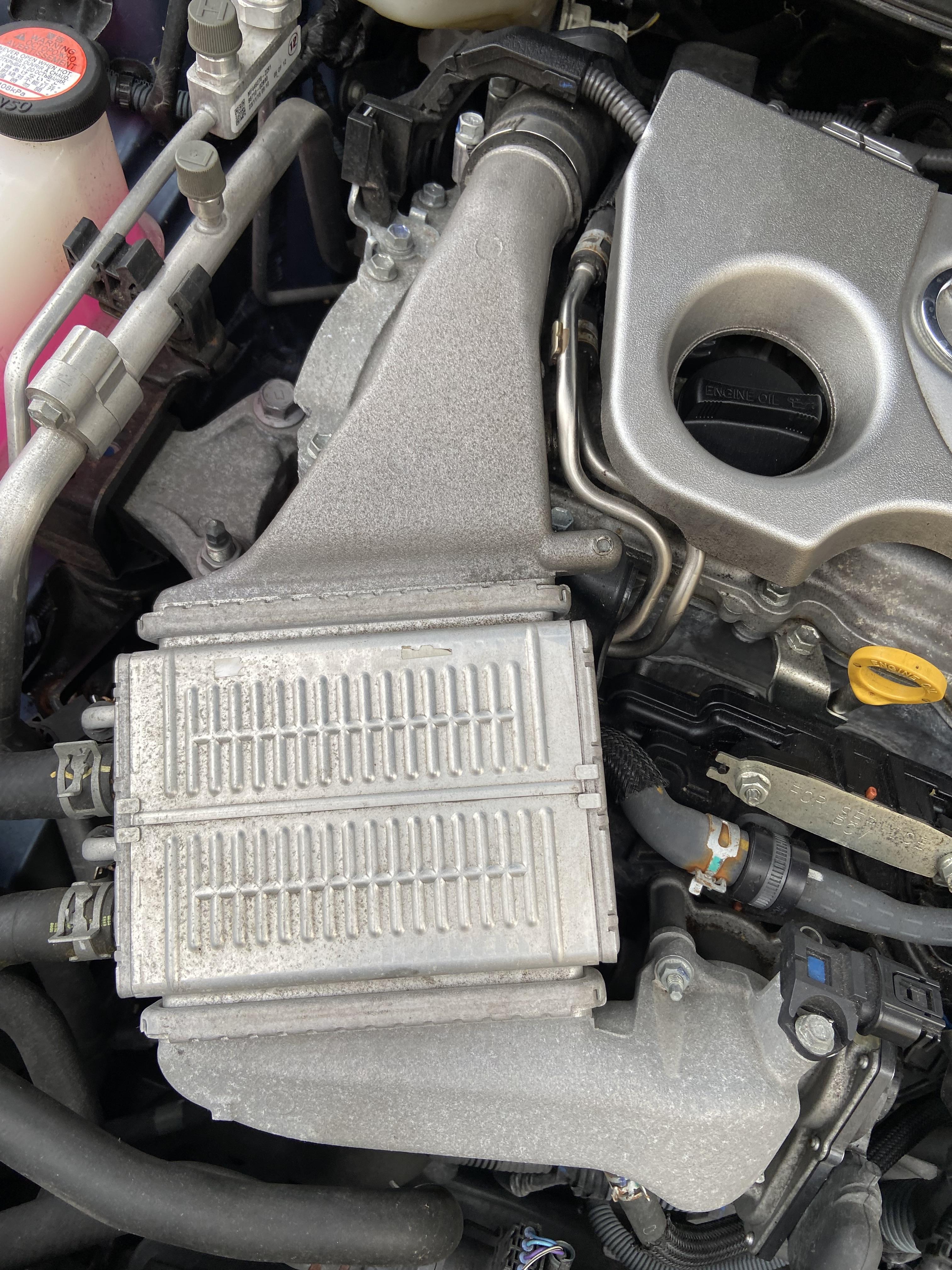

need to change the alternator on my 2015 1.2T auris .The problem is the intercooler for turbo is mounted above it
Do i need to remove intercooler to do this job.If so is there a procedure for same ,also the serpentine belt seems to drive 5 pullys

Can you get to the bolts out without removing the intercooler. Have you looked at the access from under the wheel arch cover you should then be able to see the pulleys and belt config. Hope this helps.

up date my buddy done the job replaced water pump,belt tensioner and alternator with used parts also new serpentine belt
He had to remove INTERCOOLER to get access ,said it is not a big deal
just needed new gaskets from main dealer
So that’s the story will keep the car another year or 2 now
