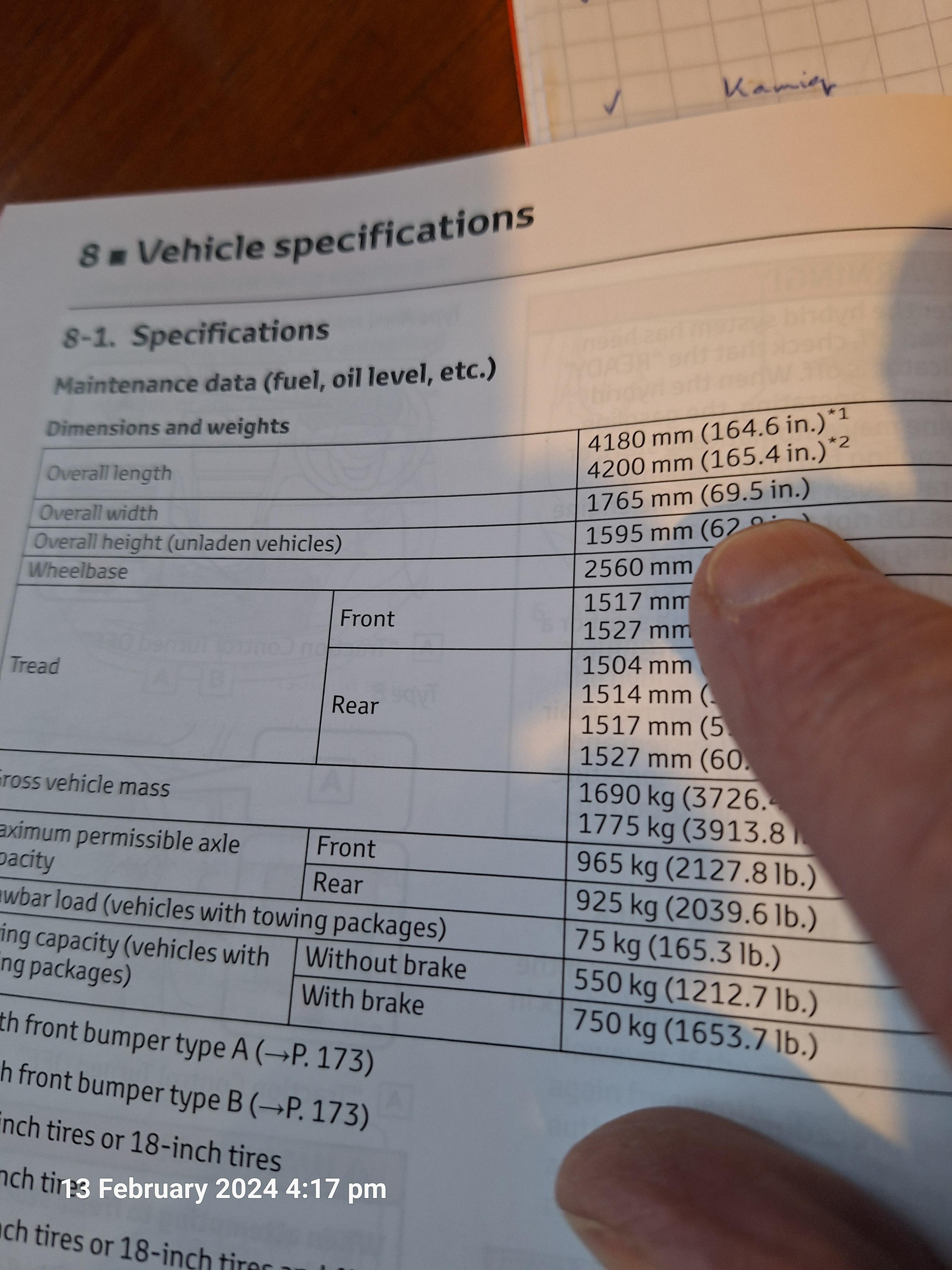

The "overall width" quoted in the handbook for the yaris cross is 1765mm.
My garage door opening with the up and over door frame is 2200mm so getting the car in is pretty tight but doable. The garage is bigger once through the door.
In order to get the pebble out of my shoe I have been looking at other cars the same width or narrower than 1765mm.
I sat in a skoda kamiq and I was pretty sure it would go through the door but then I looked on the skoda website and it appeared to be 223mm wider at 1988mm.
I measured the yaris cross width today with the mirrors out and it is 2000mm which in my opinion is the "overall width" not the 1765mm quoted. Just goes to show, you need to check everything.
Completely mislead by the handbook. There a number of small suv's which will be suitable if I decide to change.
Sometimes the quotes are without mirrors, and some with mirrors. Hope you are doing better at getting info for the 12v 🙂

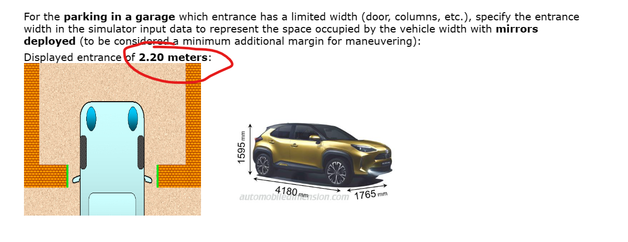

Have a try with this. Select Make and Model, scroll down and click on parking simulator:
Car dimensions of all makes with size comparison tools (automobiledimension.com)
Yaris X:
Toyota Yaris Cross dimensions, boot space and electrification (automobiledimension.com)
Simulator, pick make and model and enter your garage dimension including any entry width restriction:
Simulator of car dimensions in its parking space (automobiledimension.com)
