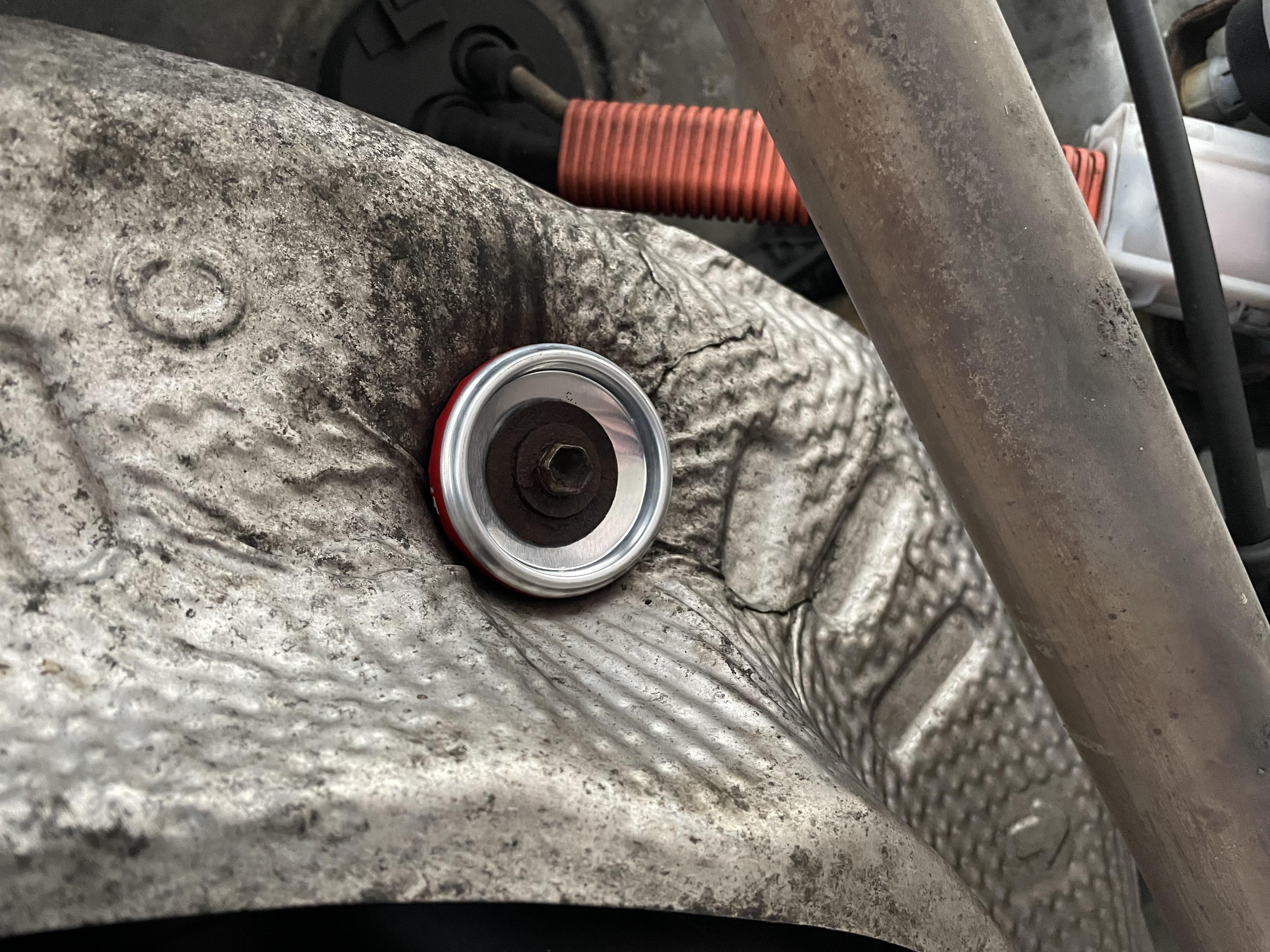

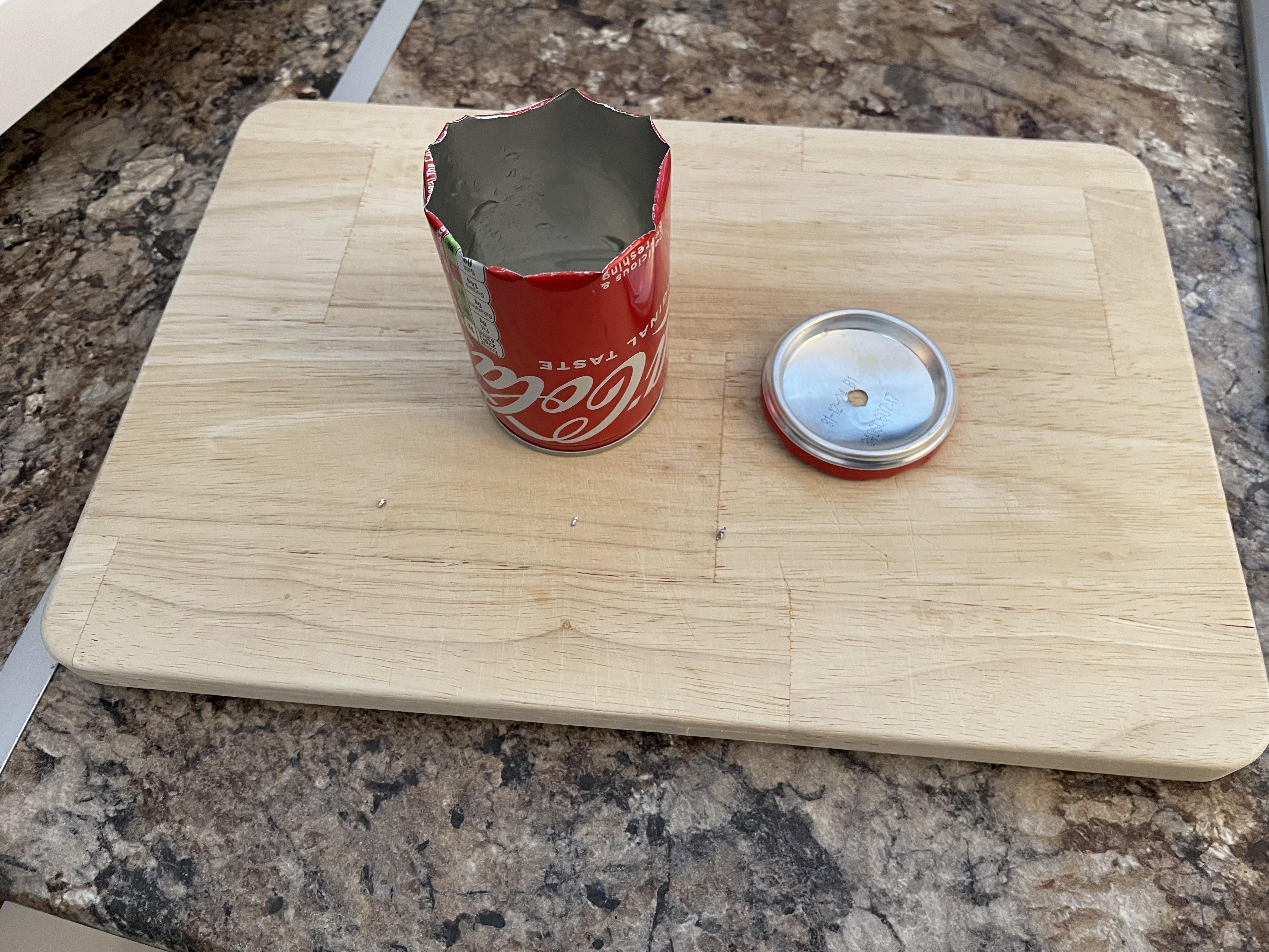

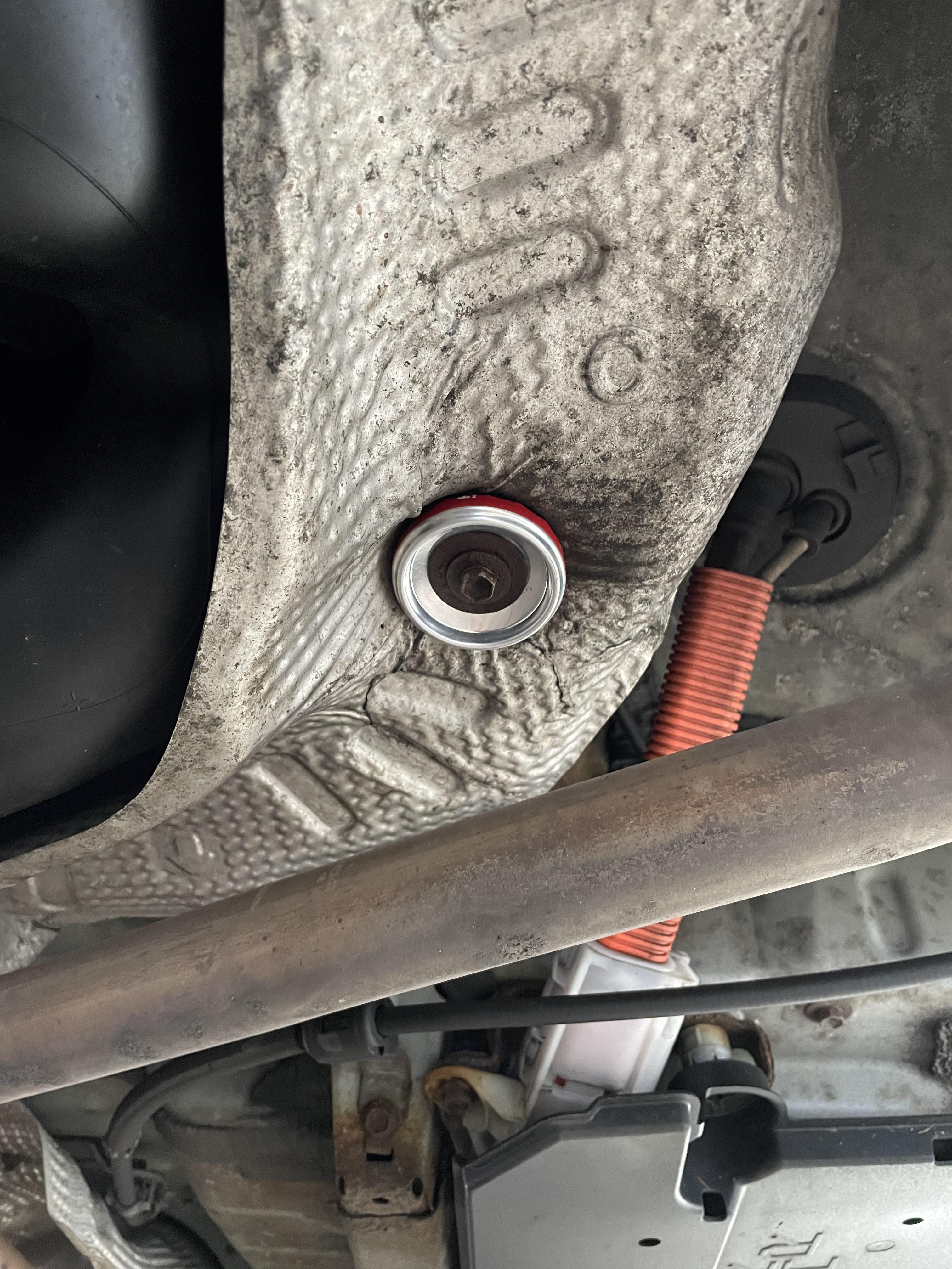

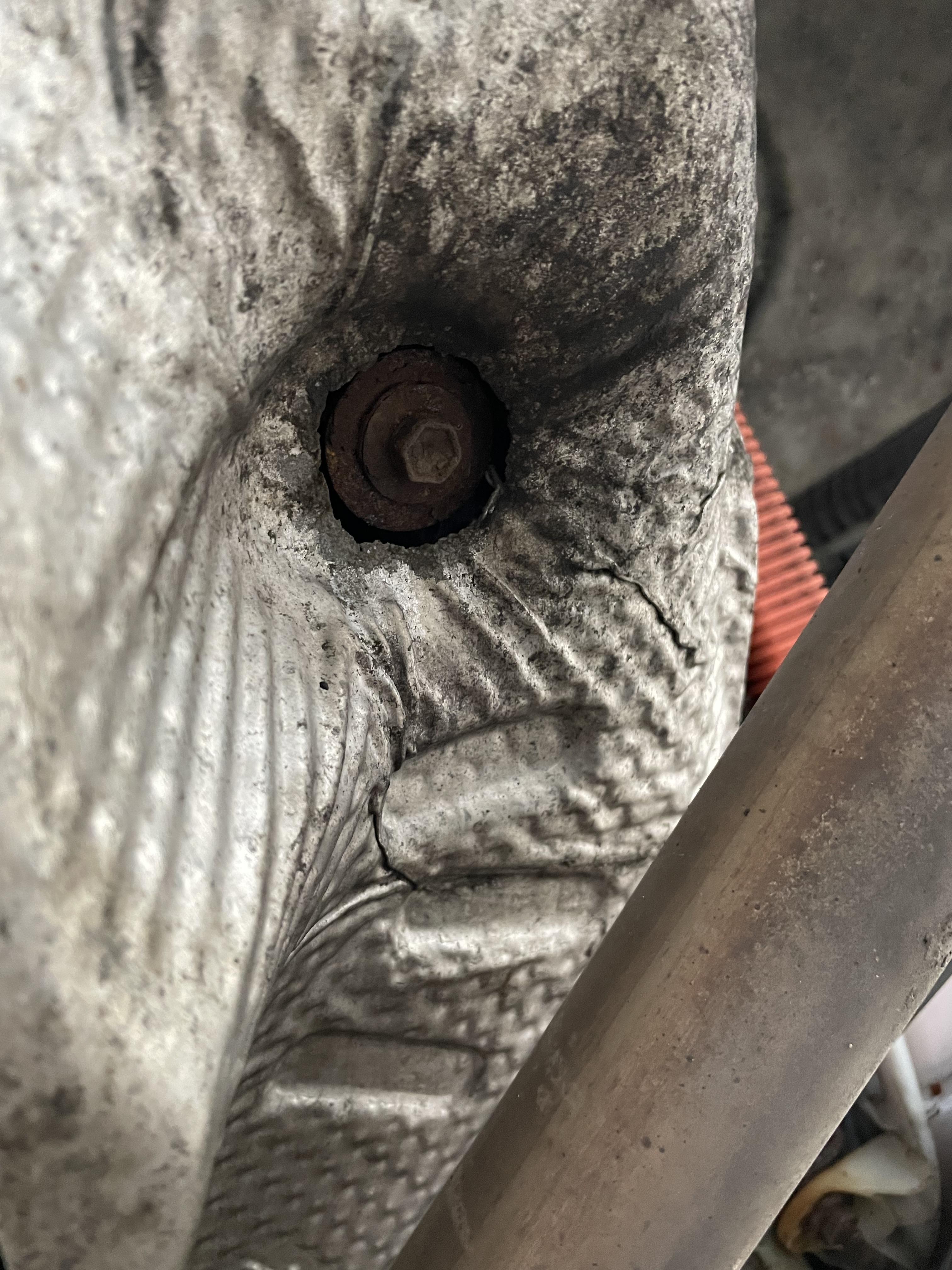

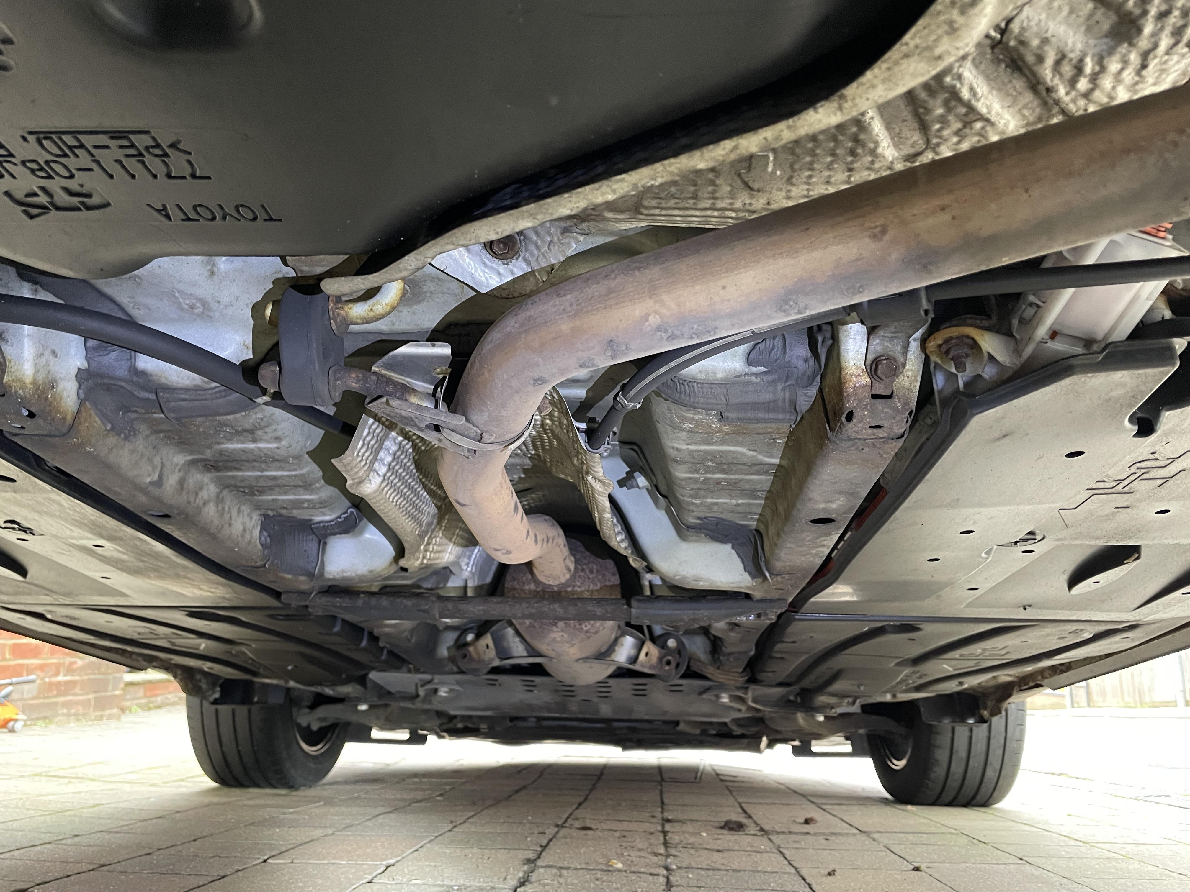

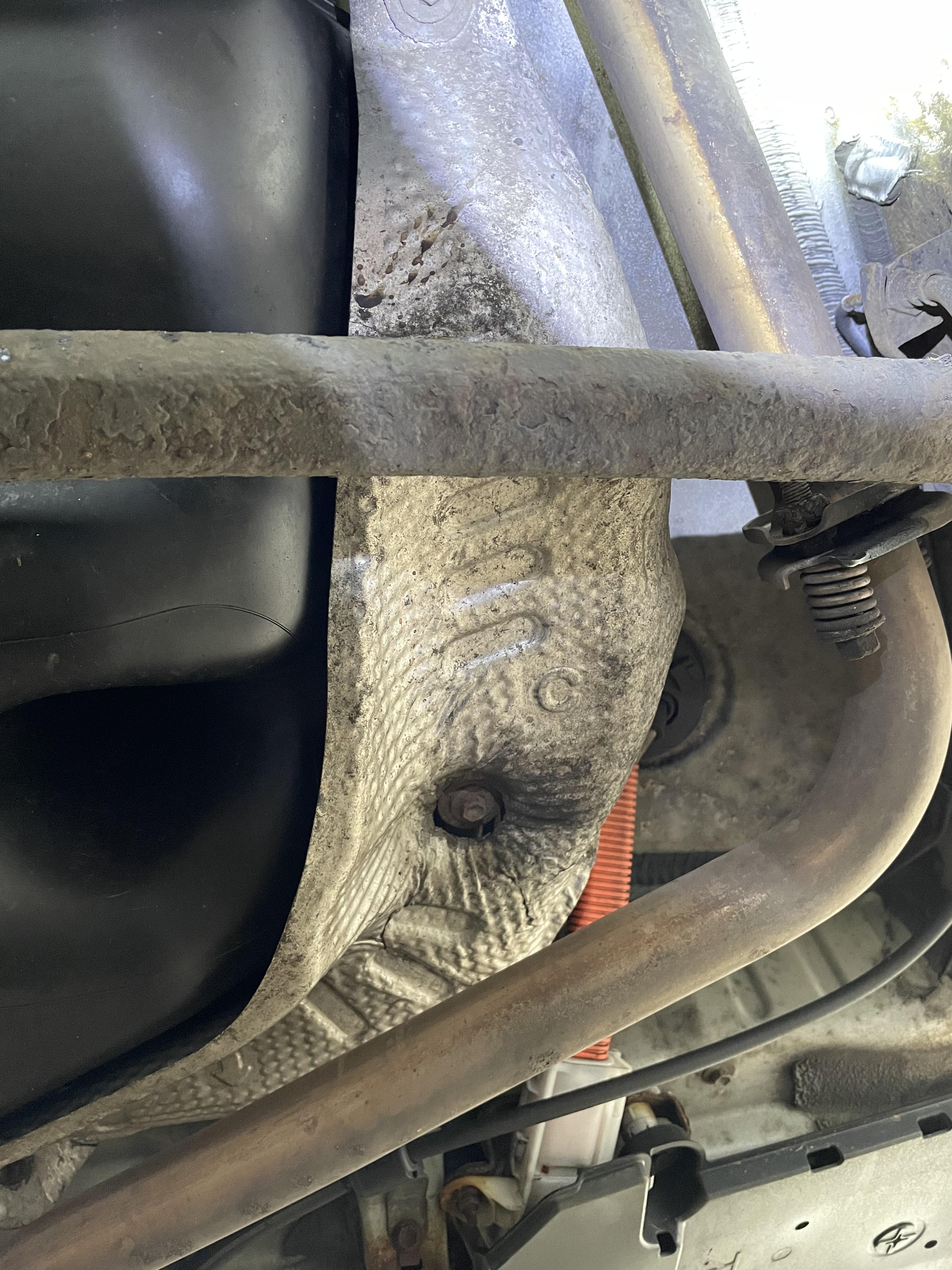

burning smell is never a good sign and often brings more trouble if left unfixed. These cars especially at age as yours suffer from broken heat shields and exhaust brackets due to a corrosion, similar to what you had already experienced. If the heat shielding in question is missing or it’s not properly attached can let heat into to places where should not be, can even melt something or start a fire. I have same car as yours and recently had some grinding noises and yes was the heat shielding on the fuel tank at the rear, previously fixed it needed fixing again. I use a Coca-Cola can but job done nicely and no more noises. Also I had to tighten up a previous repair with hose clamp, something I did at 42000 miles, now the car is almost 267000. Here some pictures.
For your car I will recommend someone who knows these cars well to look under and carefully examine your exhaust system and all heat shieldings, front to rear.
