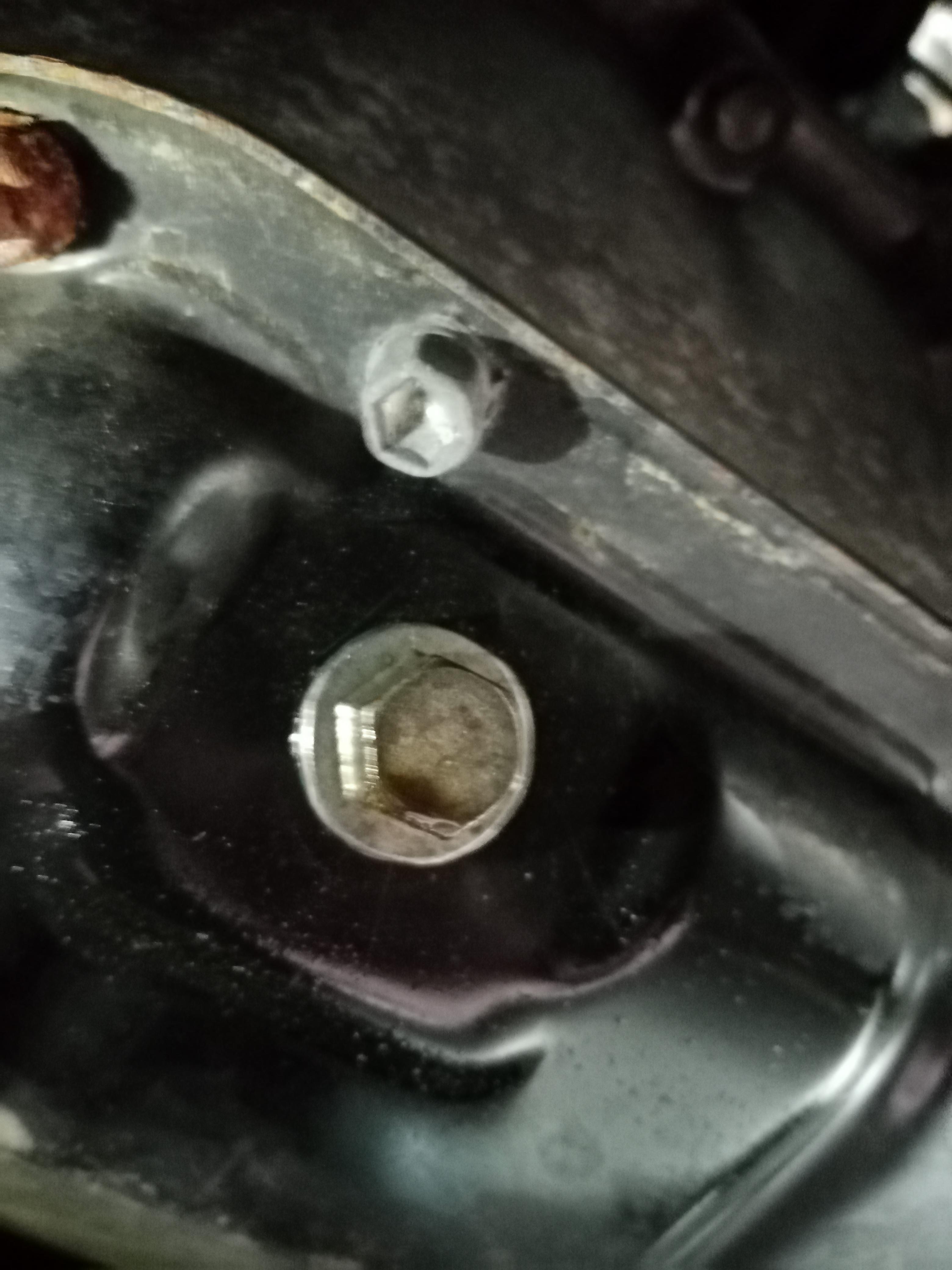

Evening all, a bit of a crystal ball question, but I noticed today on the (very) wet drive some tell tale fluid drips when I moved the car today. Not huge amounts but not seen them before. Not been able to investigate further at the moment due to the horrible weather. When we get a dry day I will get straight underneath. In the mean time, what would be a potential suspect to look straight for? Oil and water levels look fine from the quick look I had. Any suggestions would be appreciated. Thank you
Need to go under the car clean it well and then you can see from where it comming from, send some pics.
If where a wheel was then maybe a leaky brake caliper?
Whilst I have got a garage for shelter, its full in there at the moment, so with the weather being just wet, wet, wet this week, its been frustrating. My two 'go to' firsts will be just to check the oil filter housing is tight and secure (not weeping) and then check for a weeping water pump (as ani-freeze will give fluid stains on wet tarmac I believe). I will keep you posted....tomorrow looks a dry day!
Quick update all, a dry interlude, quick look underneath, can you believe as simple as a dripping sump plug! I do love a easy fix, torqued back up, job done. Shame all jobs are not so simple!
