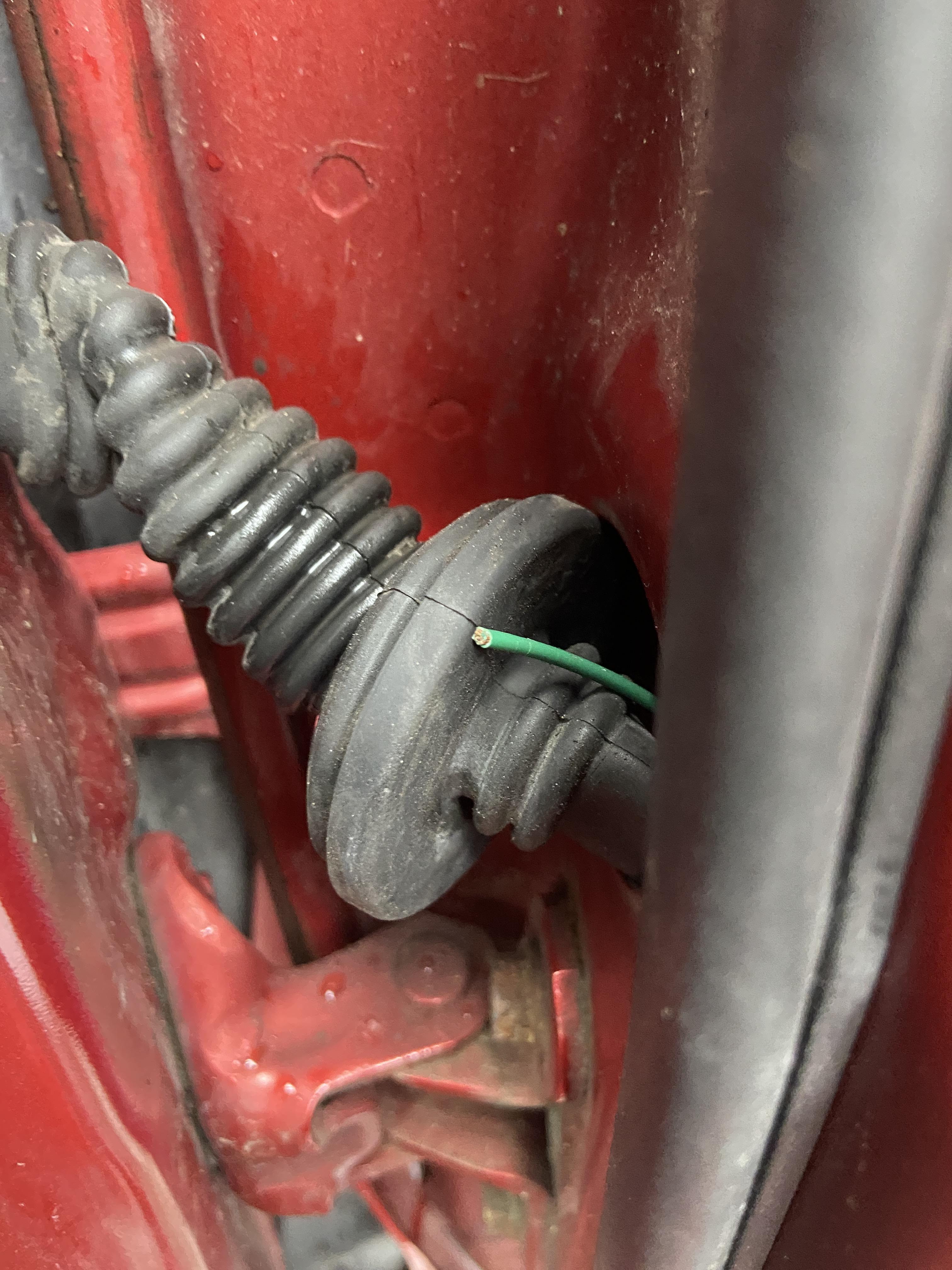

Good evening. I thought I would just let you guys know that I think I might of found the issue that I was having. I found a broken wire between the door and car ? Please see photo 🤞🏻this is what is causing the problem.IMG_3062.thumb.jpeg.835b4fea9e7f7a6713d00ae4428768a1.jpeg
Just now, Thomas76 said:
Good evening. I thought I would just let you guys know that I think I might of found the issue that I was having. I found a broken wire between the door and car ? Please see photo 🤞🏻this is what is causing the problem. Just got to some how get to the other piece so I can splice them together.IMG_3062.thumb.jpeg.835b4fea9e7f7a6713d00ae4428768a1.jpeg
that will do it at a guess that is either a 12 supply or LIN bus
edit. looked it up its 12v Battery supply to the switch
run a new wire from inside the door to inside the car
