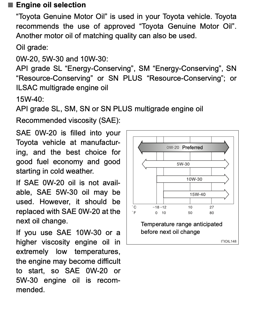

Argh. I told my mechanic to use  OW20 oil, per Toyota's recommendation, and he put in OW30.
It's a warm area (Portugal), but I might drive to colder areas. Also, bearing clearances are set by the factory to accept a certain viscosity, so thicker oil can cause bearing damage.
Should I have it re-done?
I'll attach Toyota's recommendation (from the manual).
This is a 3rd generation hybrid.

It shouldn’t matter as long as the API grade falls within those listed.

IMHO the viscosity is close enough it's not worth changing, maybe just give your mechanic a stern talking to and/or next time buy the oil yourself from the dealer or something and tell them to use it (Which is what my dad always used to do in the old days as he never trusted the oil third-party garages used)
The important thing to check is the API oil spec as mentioned by others, as it's the additives in the oil that matter more, but unless they're willing to show you the spec sheet or bottles/drum used I'm not sure how you can check that as it's not something usually documented...

It will be fine, I had 5W30 at one point in my 3rd gen Yaris and no problem at all. Buy the oil yourself next time as others have said.
By Toyota dealer I was recommended to use 5w30 instead of 0w20 in my Corolla.The 5w30 is less expensive then 0w20 so the dealer was not trying to rip me off. I’m using it since the second oil change, no problems at all and as a bonus the engine is more silent .

Using thicker oils shouldn't be too detrimental as long as it's rated for in the manual and it meets the API specs, but it will mean you need to be more careful when the oil is cold and the more efficient cars, esp. hybrids, tend to see a noticeable drop in mpg with thicker oils.
Not an issue if within the same spec API .
Next change perhaps you can go back to 0w20 A5 GF-5 , or GF-6 as is latest standard.  Using 5w30 oil in 0w20 specs engine imo is one of the reasons why some cars developed earlier high oil consumption. Semi synthetic oils which is Toyota own label 5w30 is not so good against heat and gets burnt quicker than other fully synthetic oils all that causes buildup of carbon on piston rings, cylinder glaze and oil consumption.

Cost apart, 0W20 could be better on cold climates but quickly looses lubrificant capability when it warms.   Maybe in North Europe 0W20 is ok, but in the South of Europe ( and I expect that Portugal climate is more similar to Italian tha UK one ) is very easy to reach more than 30 C in summer and 20/25 in spring.
Probably a 0W30 oil could be the more equilibrate but I don't think that Toyota offer this grade.

The thing with viscosity is it has to be matched to the engine - PSA were lazy, like a lot of marques, and just specced low viscosity oil to get their CO2 down without bothering to modify or redesign the engine to properly accommodate it, which naturally causes problems, as the engine was designed to use a thicker grade of oil! Toyota designed their engines to use thinner oils, and have the opposite problem - using too thick an oil will actually cause more wear over time! My Mk4 uses 0w8, which is hilariously thin, but the level is practically unchanged over a year because the engine was designed for it.
In an engine that has large tolerances, you have to use thicker oils to support the larger gaps; Thinner oils will let the components flop around too much, esp. when its not been fully pressurized. However, in engines designed for thinner oils, the tolerances are much tighter, so thinner oil works better as it can get in the gap easily and doesn't has the right film strength for the smaller distances; Thicker oils will struggle to flow through the tighter gaps and will just generally get in the way, causing unnecessary drag.
The key thing is thicker or thinner oils isn't good or bad for and engine per se - The important thing is to use the oil the engine was designed to be used with.
