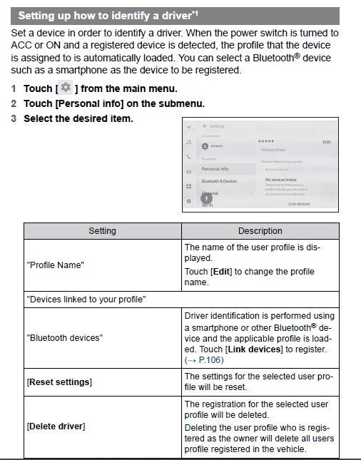

I think there is an option in there somewhere to factory reset it and wipe all data from it.
TBH the dealer or previous owner really should have done that before selling it to you!
Taken from the Multimedia User Manual
Thanks for the info.
I had found the "Reset" option before, but it was low lighted and wouldn't do anything.
Interestingly - I emailed the previous "Primary driver" and got a reply where he said that he had removed the car from his MyToyota account.
Tried the reset opion again today, and it was highlighted, pressed it, and did what it was supposed to. 👍
