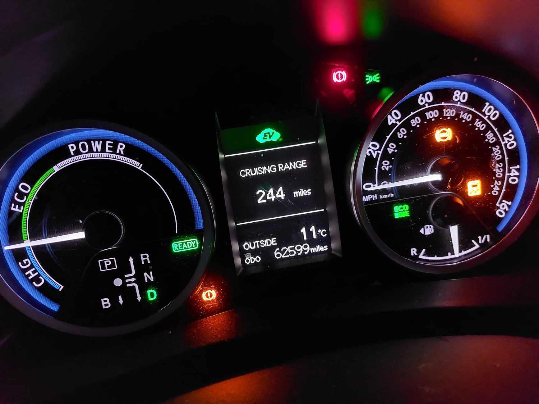

The car starts and runs fine. It drives ok, it stops ok! However, there are lights illuminated on the dash - ABS, Traction Control, Engine Warning Light, and I think there was one other as well.  A friend of mine has a Code Reader and it gave C1203 and C1345 error codes He could not clear them - they kept coming back.

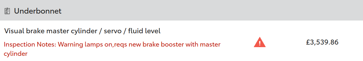

The Toyota garage made this comment on my vehicle inspection Warning lamps on,reqs new brake booster with master cylinder - (hopefully I've attached an image from the healthcheck form as well! ) and as you can see they have quoted over £3500 just for the part.
