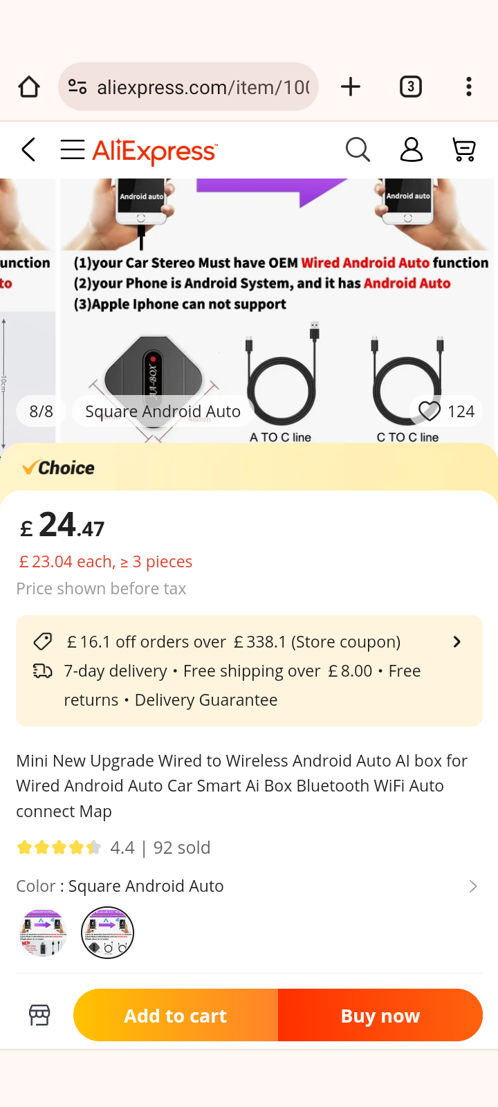

I use this bluetooth adapter from Ali express after advice from this forum works well in our 72 plate Yaris iconScreenshot_20240313-085830.thumb.png.3f5c58dd0e9ecf0248df9a7dba6f45ca.png
