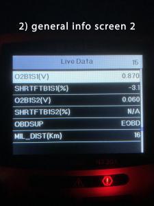

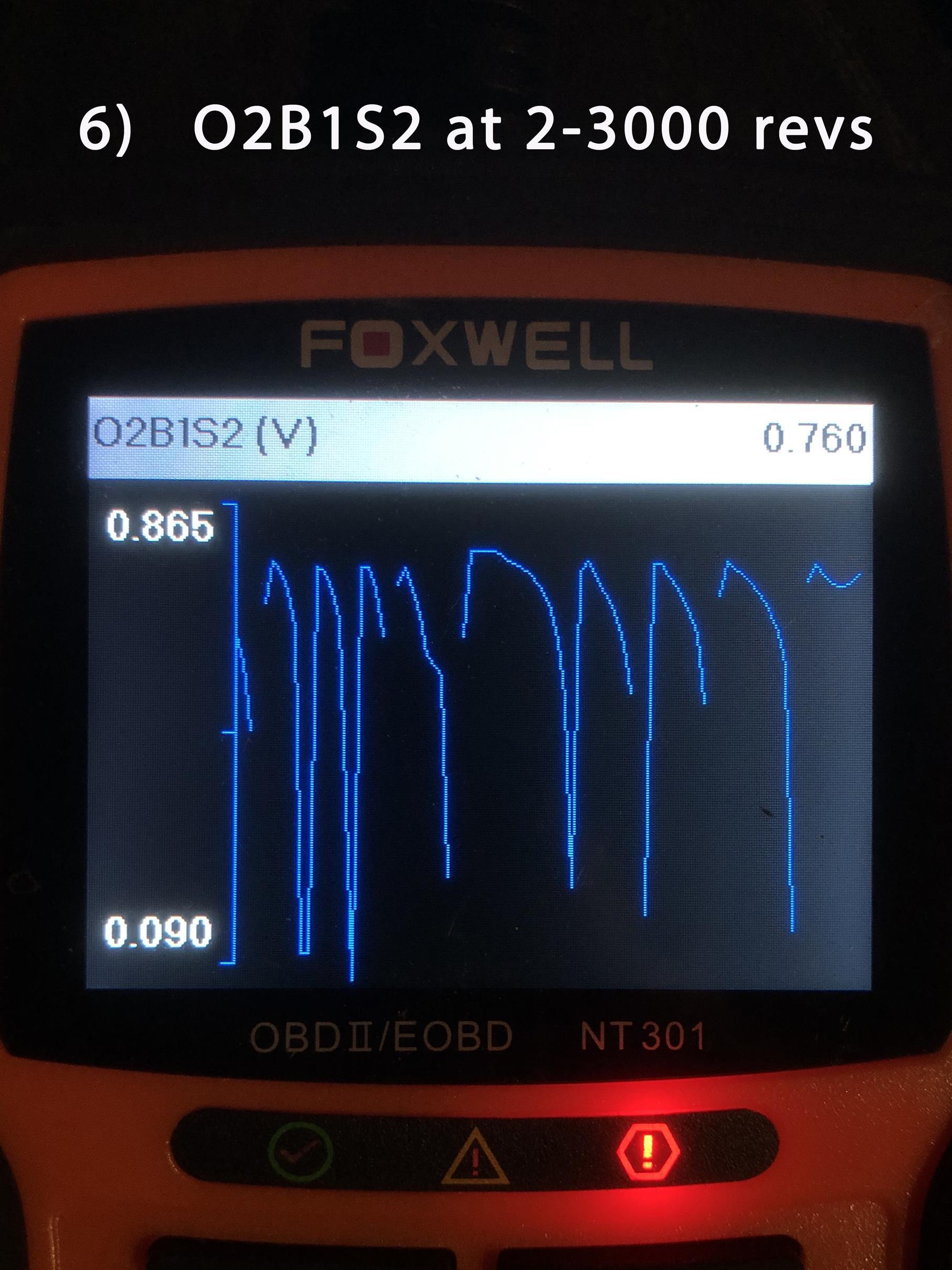

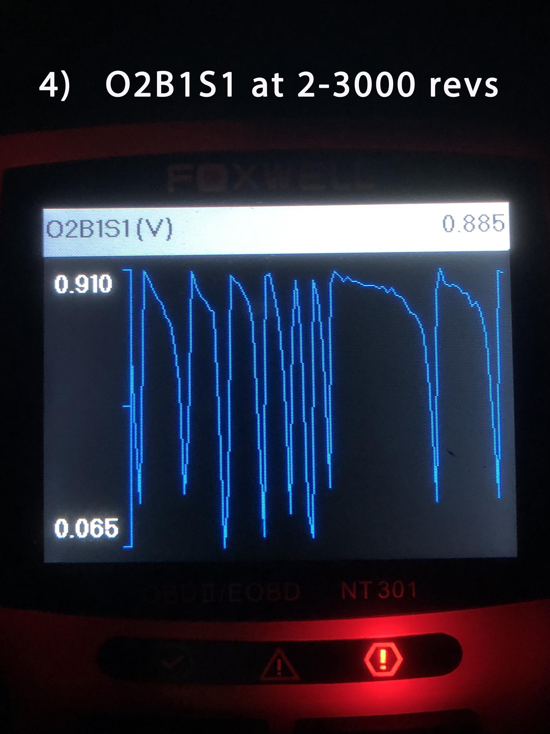

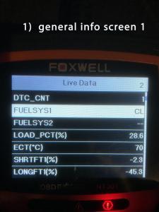

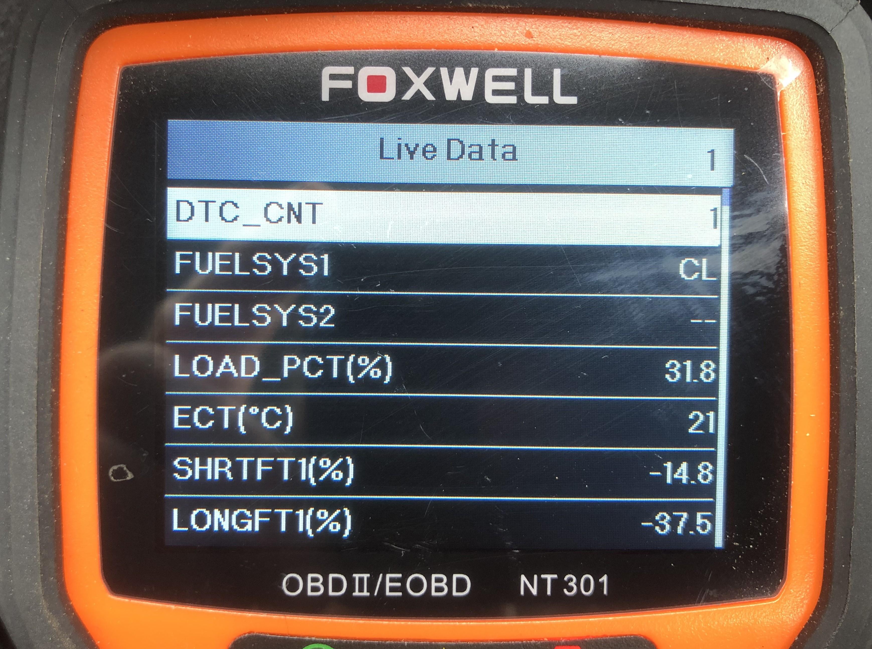

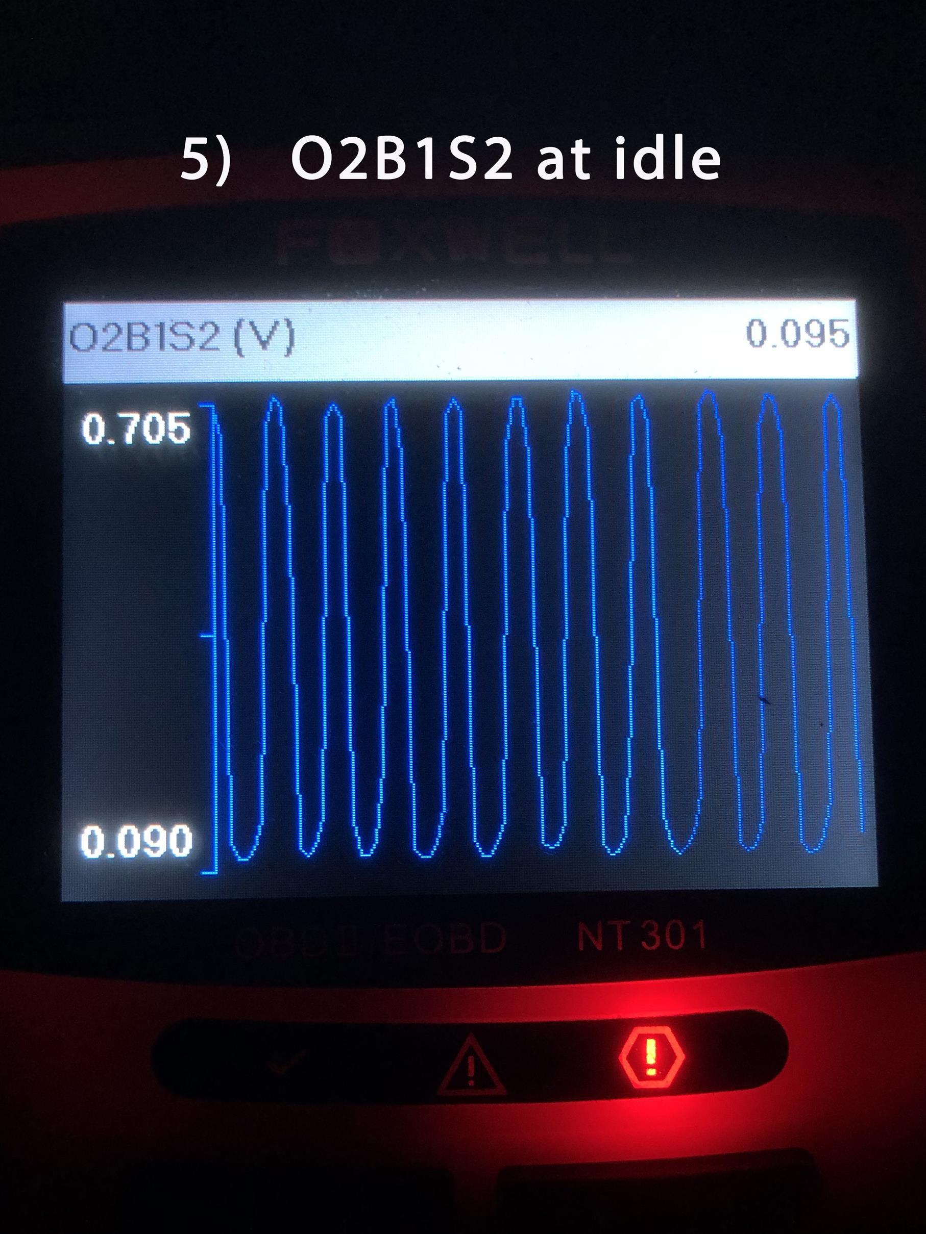

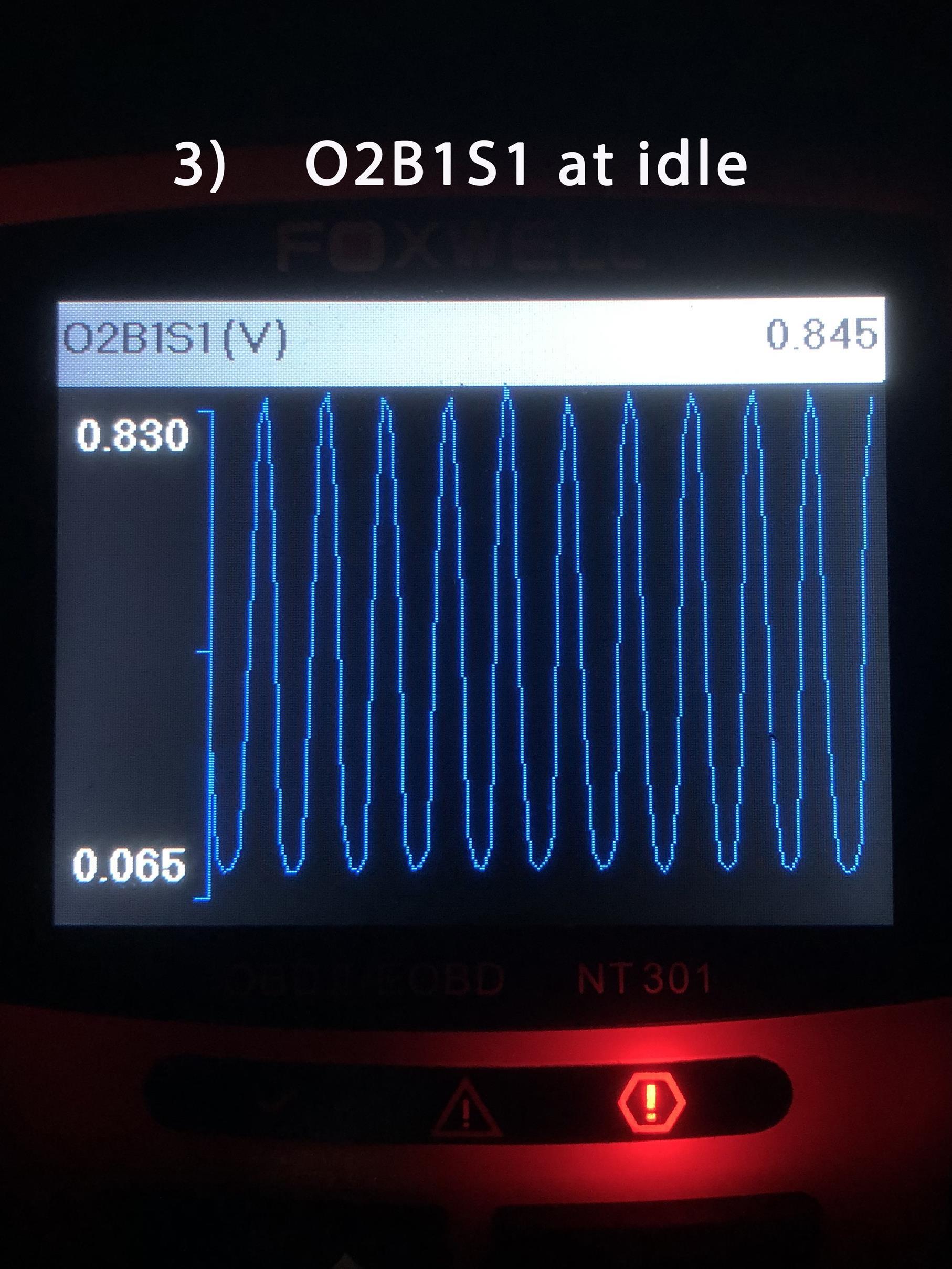

recently i got an new OBD2 reader which gives live view.  initially i thouight it must be the MAF or an O2 sensor, however ive looked at the graphs for the 02 sensors and they look ok to my untrained eye between 0.1v and 0.9v in a nice up and down wave form, can anybody confirm if my thoughts are correct and if they are looking like they are working, below is screenshots from the obd2 reader for general info and both O2 sensors . For example i can see the long term fuel trim is -45% shown on image 1

as per your previous post it is running ultra-rich and the ECU is pulling fuel like mad

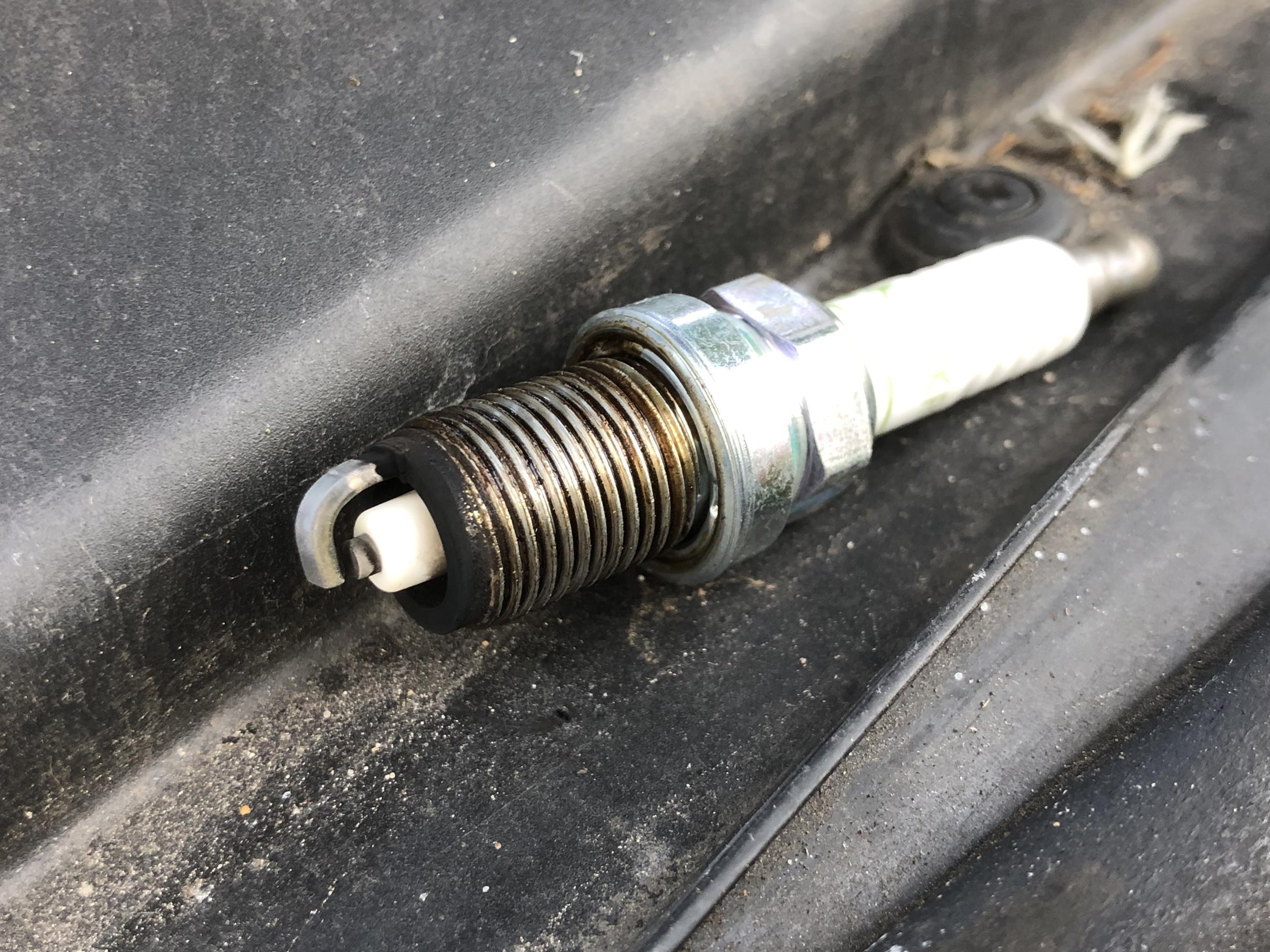

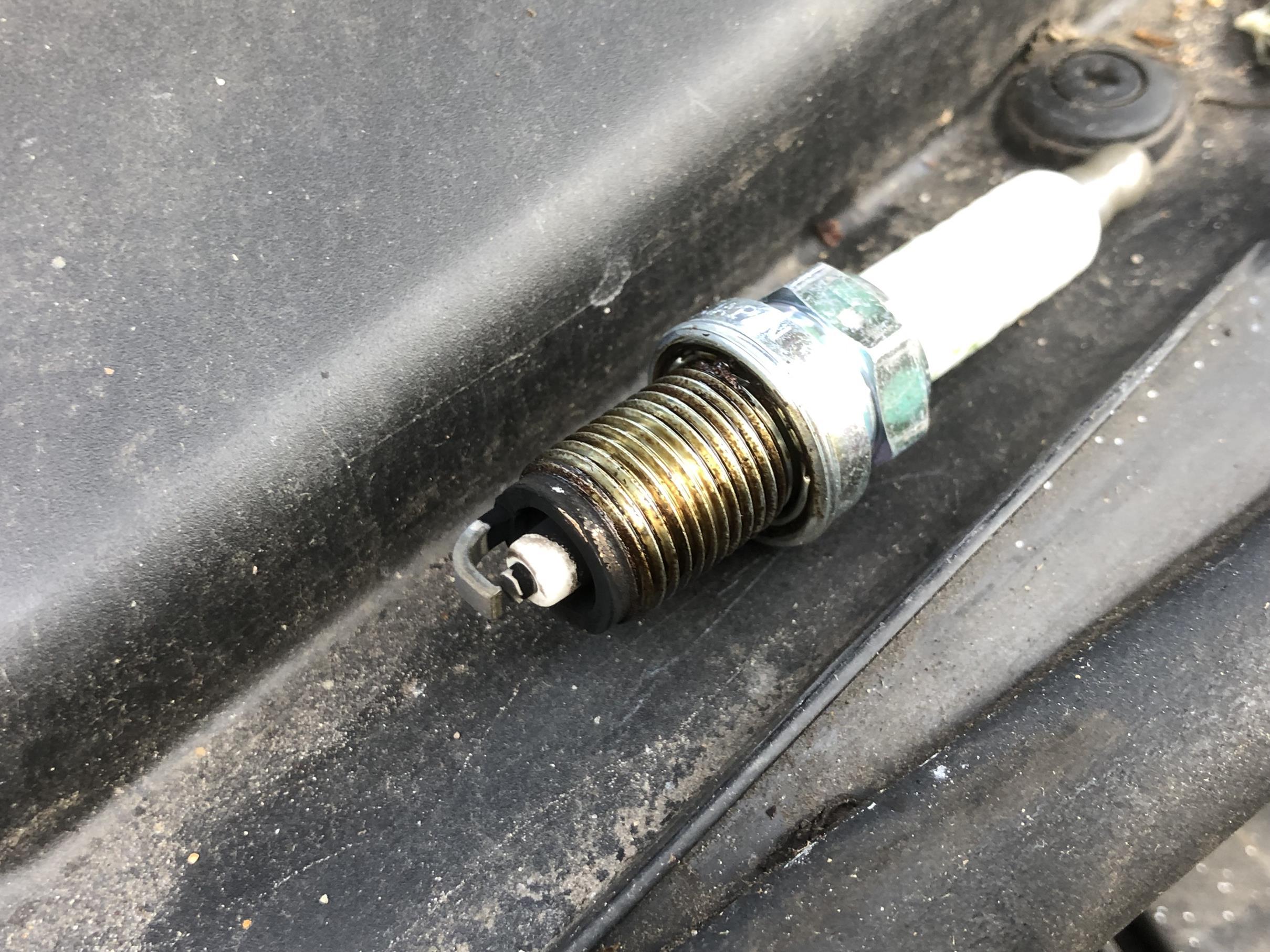

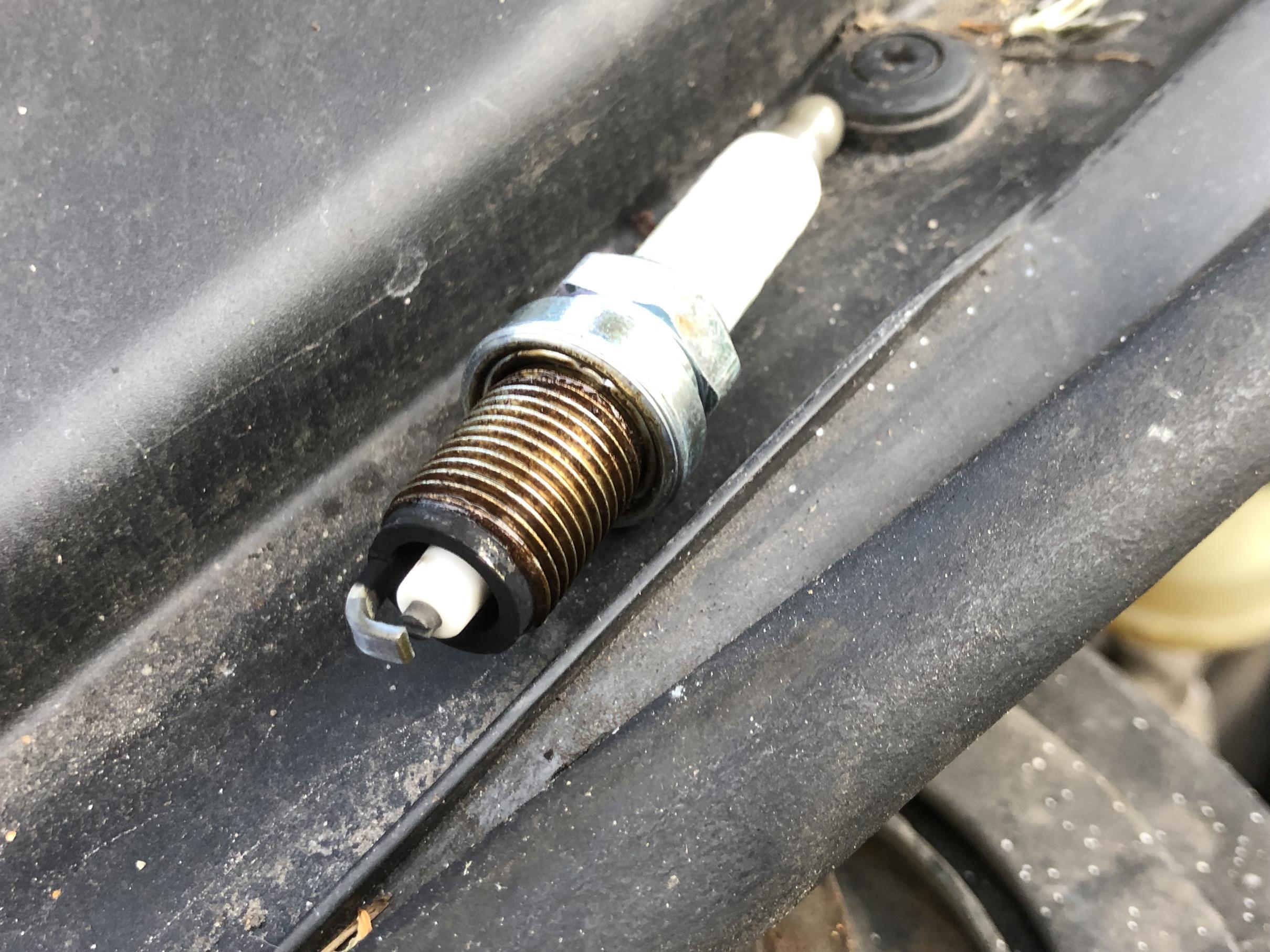

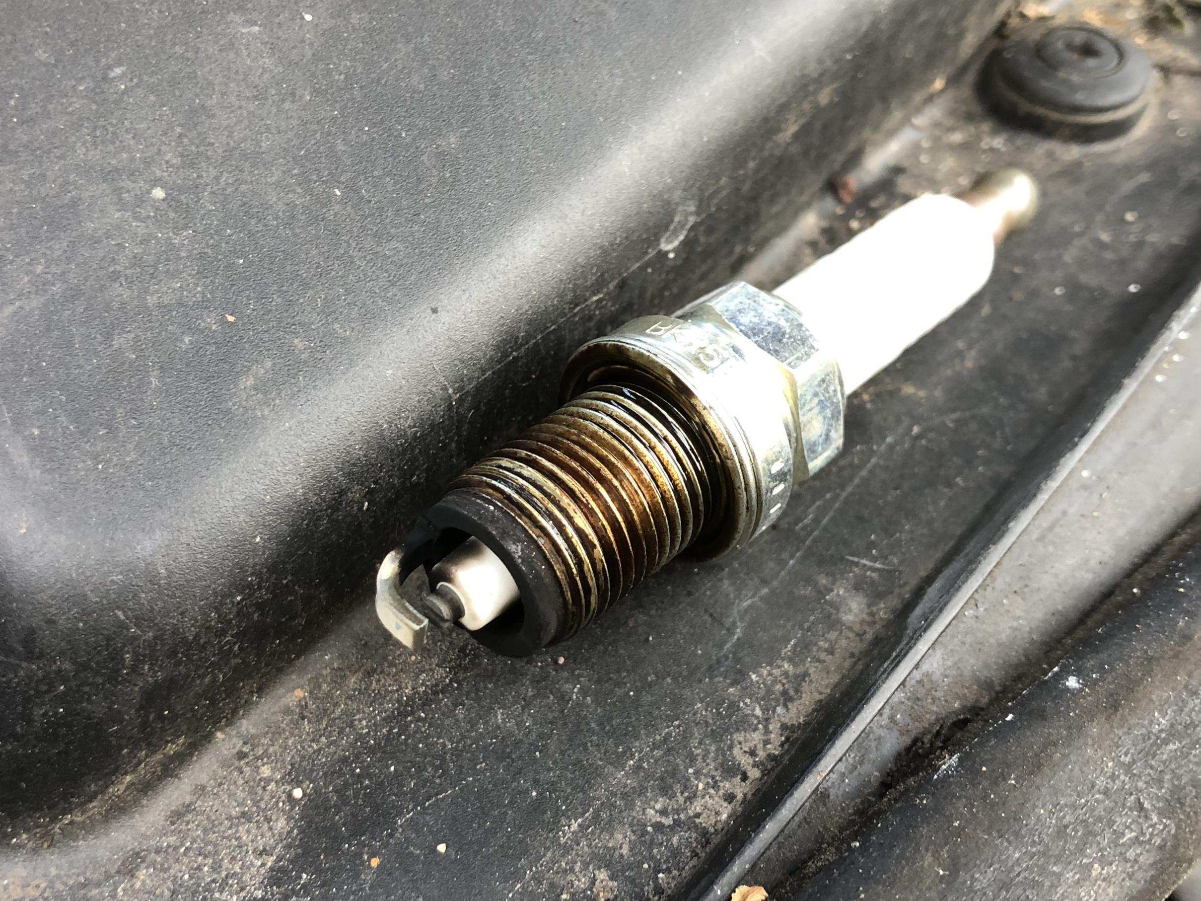

pull the plugs and check the colour do them 1 by 1 so not to mix up the order, post some pics
screen one is that ECT after it has been running a while what Is the ECT on a cold engine eg. not started over night?

Flash, i took a picture of the spark plugs, they were new about a month and a half ago.
previously i showed the Engine coolant temp when it was a warm engine.  i attach a screenshot of the engine coolant temp at start up cold. In fact it took a few moments to get the obd2 reader going so shortly after startup.

it sounds like the cat you have is junk there is not much difference between the 2 o2 sensors almost like it has no cat - these cars run rough on anything but Denso plugs (K16R-U11) the black soot shows it is very rich
