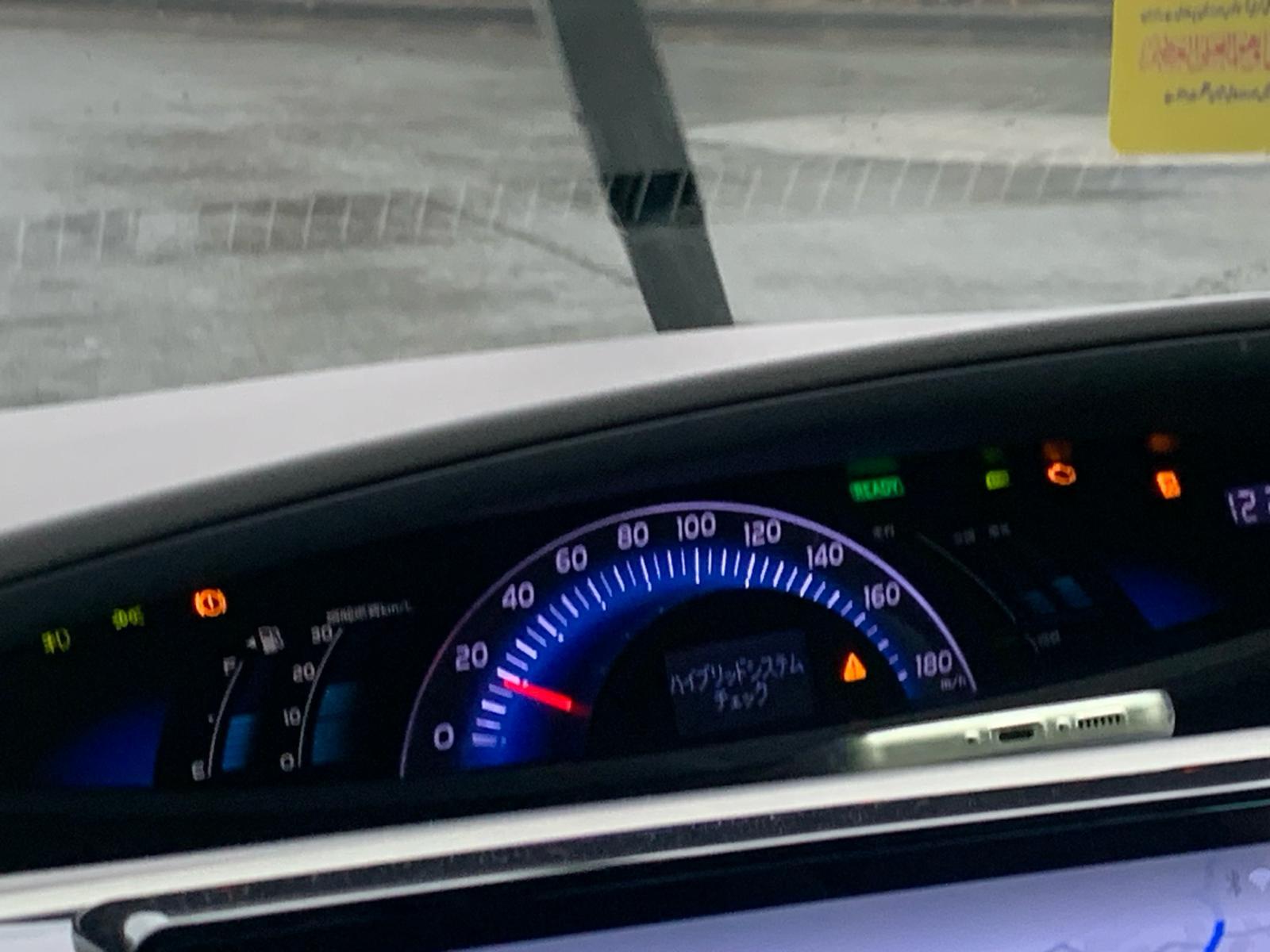

I bought this 2010 Estima Hybrid last 1st February, while driving two week ago, these four orange warnings lights did show as per the image, lucky I have the warranty still live, after waiting for the dealer over a week finaly he sent me a specialist home last night, all it was this thin cable which supposed to be attached/sticked on top of the usual car Battery situated at the back left of the car, the scan did track this issue, after switching off then on, all fine, test drive the car on the motorway this morning, all good...
I never knew a thin electric cable needs to be attacked just on the top of Battery and it was the cause for this 4 warnings lights...

I didn't understand the text that well but was it an additional earthing?
Temperature sensor to monitor 12V Battery, it is part of the Hybrid system.
