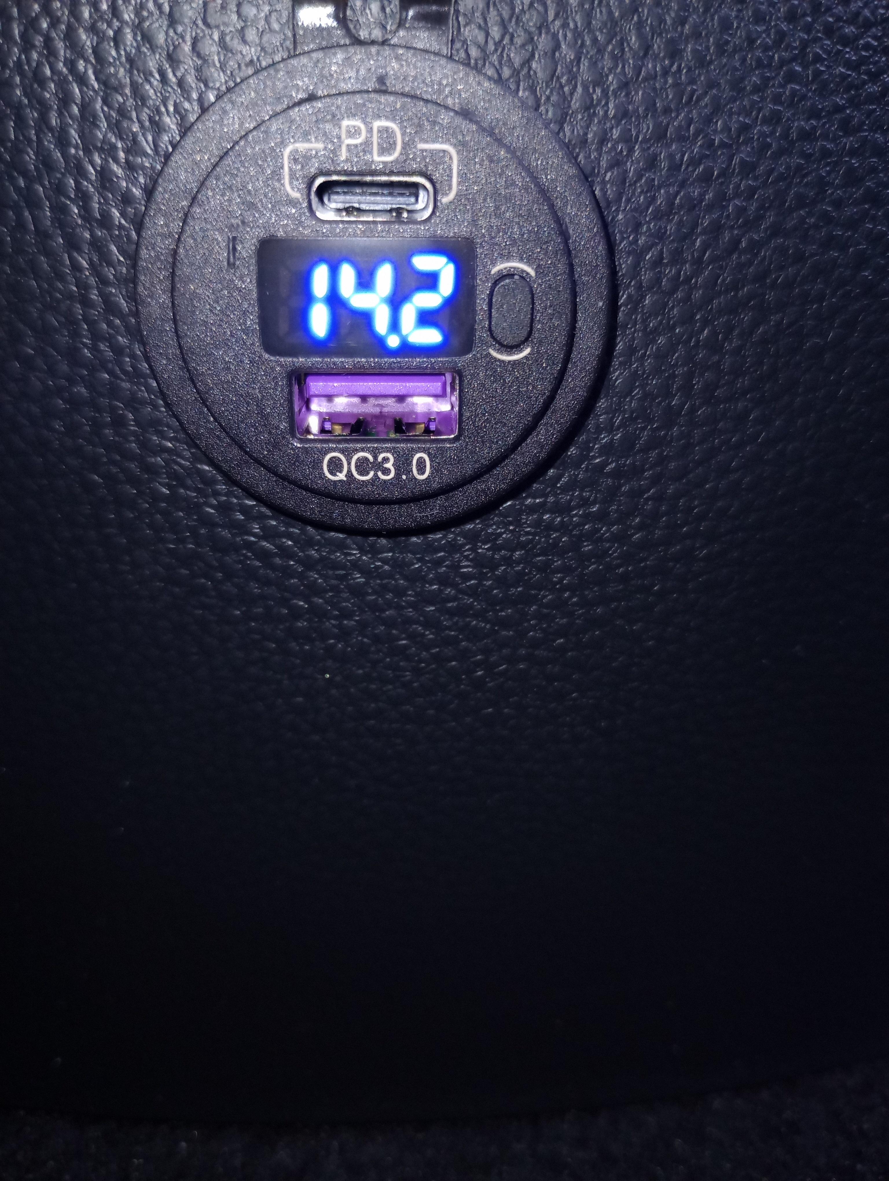

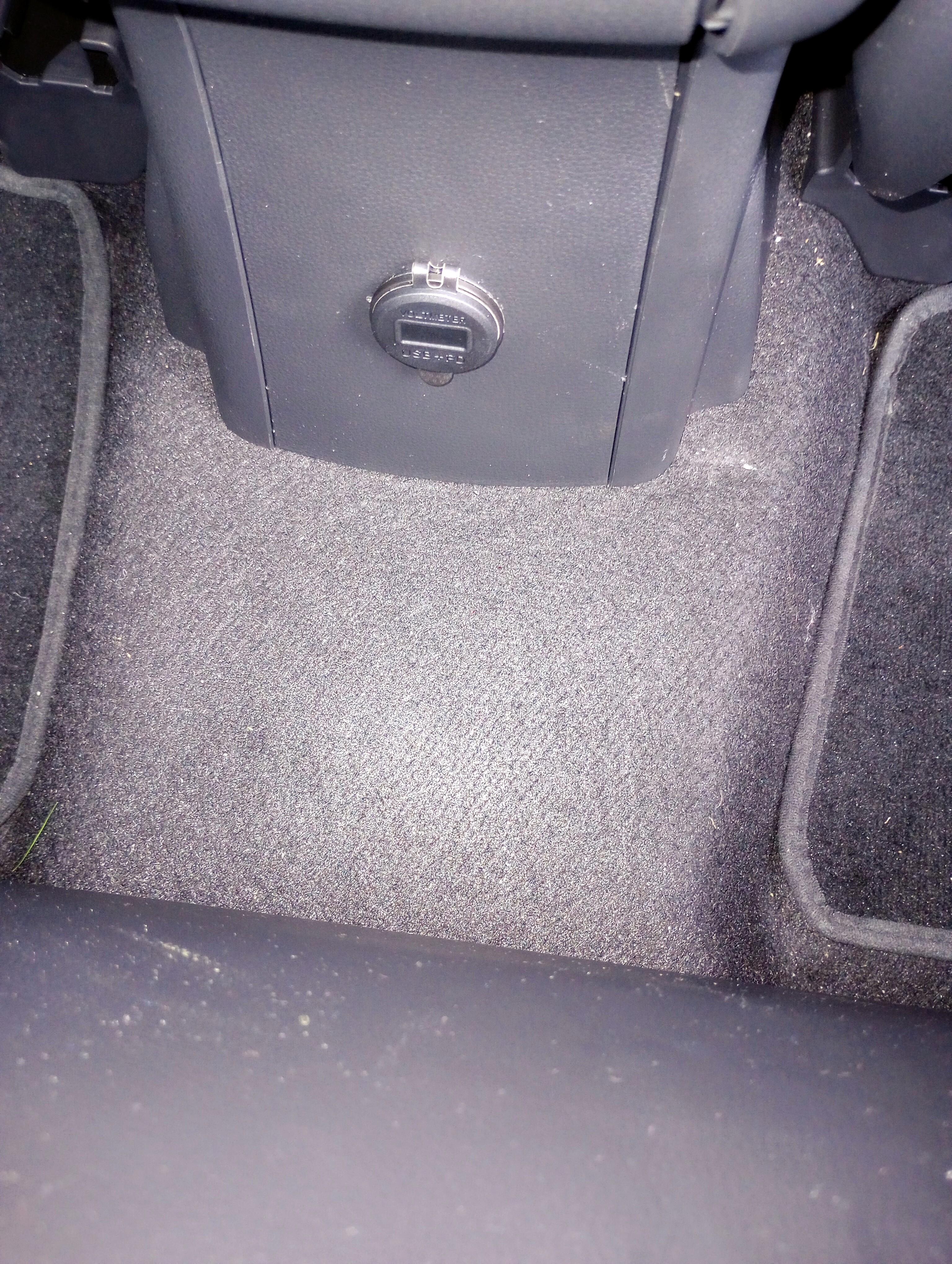

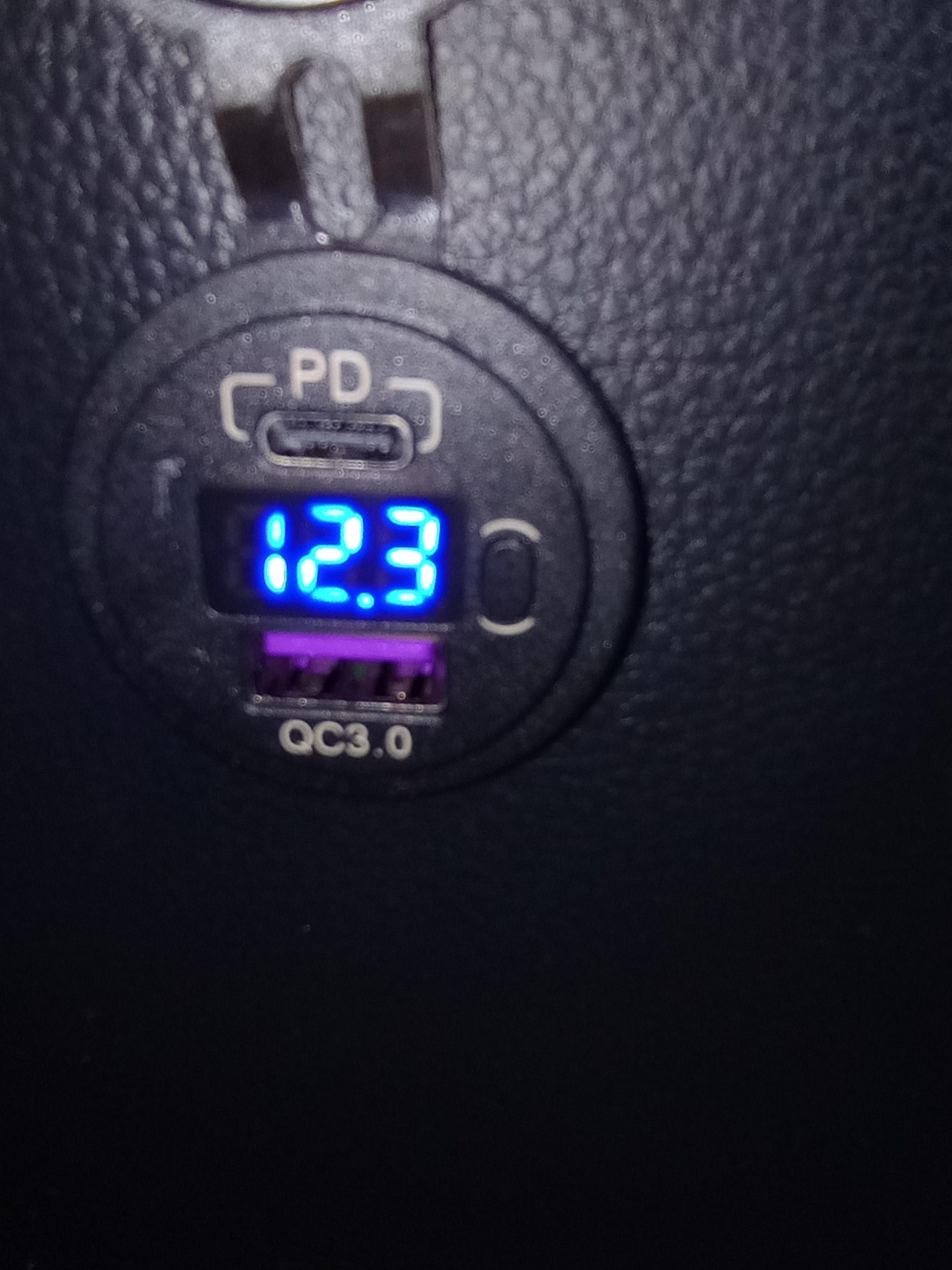

uIMG_20240321_142009338.thumb.jpg.dfab54feb6295622422094ef03ac0ae5.jpgIMG_20240321_142543677.thumb.jpg.1f6f7c148472ec79cf925a74162b5c04.jpgIMG_20240321_142100482.thumb.jpg.05b5b0525f9907076d06e04b5420b13b.jpg
  • Like 5
  • Thanks 2
Showed location of socket, it can be mounted higher up but then cables need lengthening. Voltages shown are at rest and with engine running.
Haven't tried pd fast charge but usb works ok.
I ran cables supplied under carpet to the Battery tray then extended up to Battery terminals.

No it is switchable, so is only on, on demand! First photo shows it before I've switched it on!
The switch is to the right of display.
