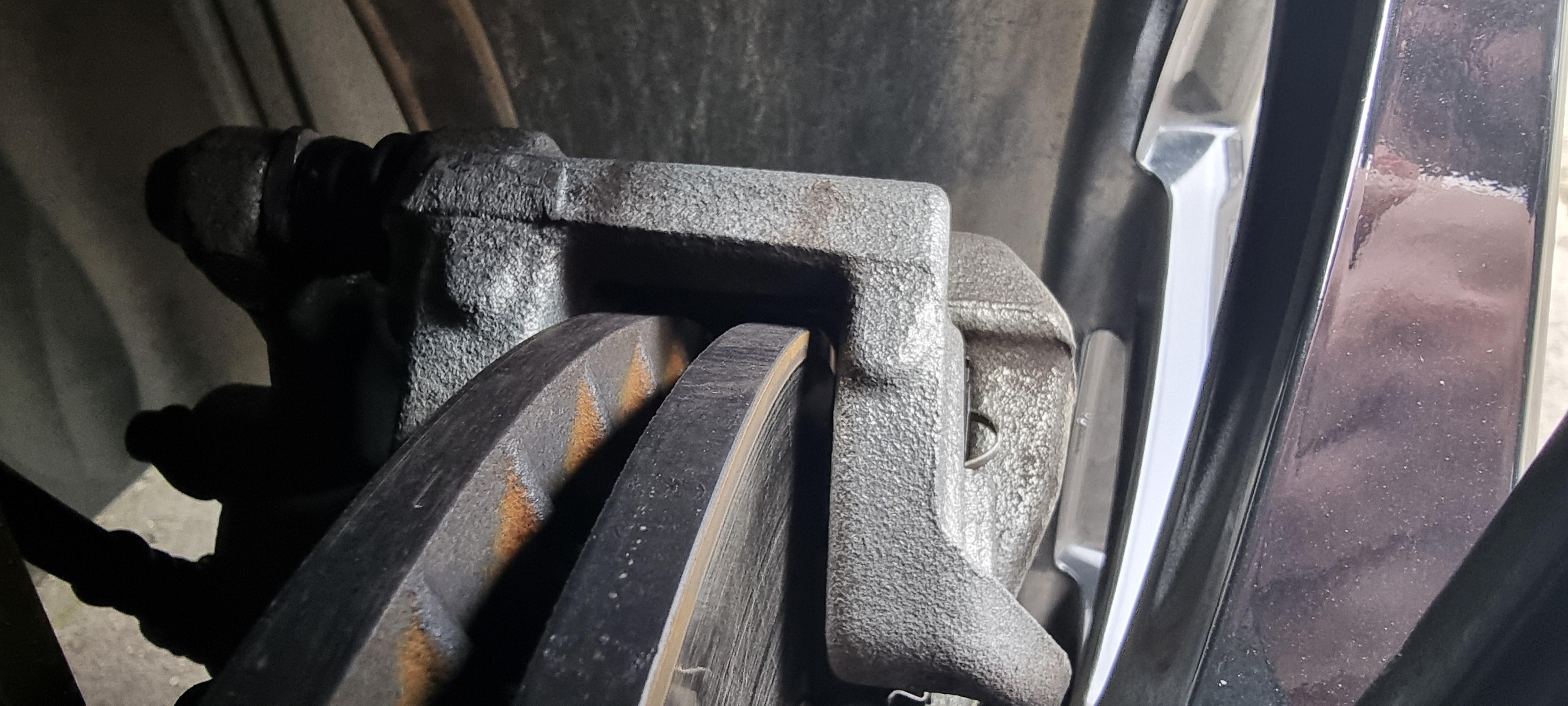

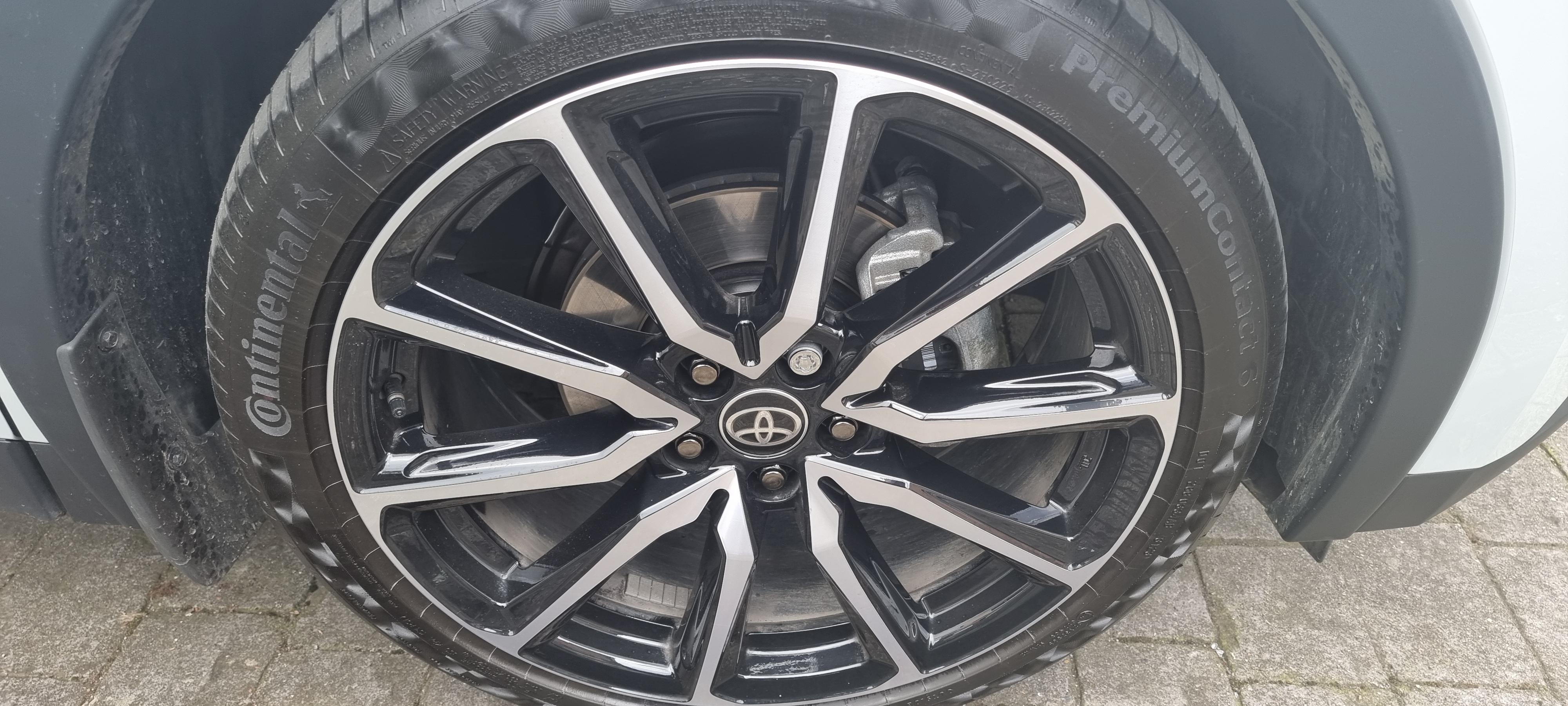

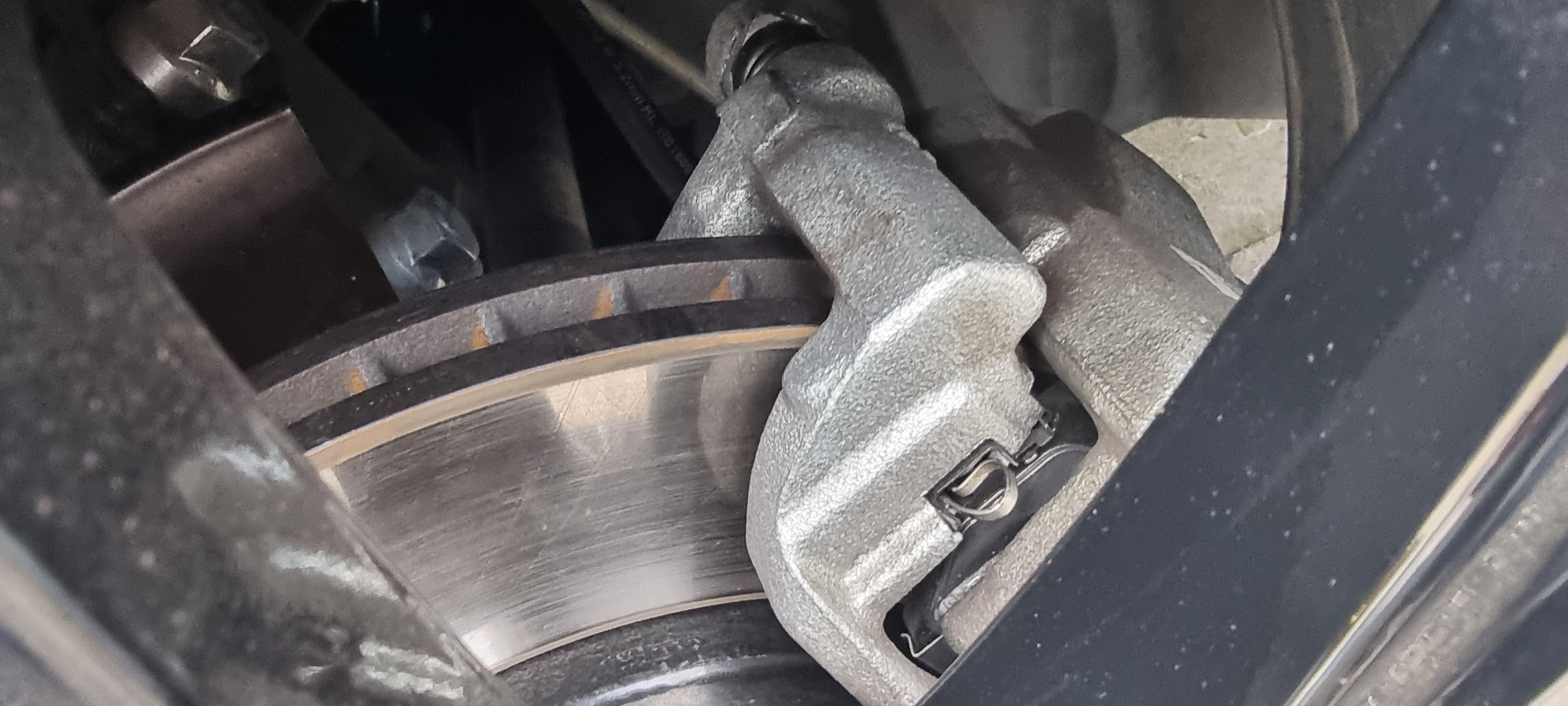

Any pictures of the brake discs and pads plus the wheel.?
20240404_111654.thumb.jpg.71799f52c65c8243bb749788ed008f47.jpg20240404_111646.thumb.jpg.87fca1964bc3fec62cb3cb8b41df9674.jpg20240404_111637.thumb.jpg.cb10df7ba3913cb17c86665c692d39ac.jpg

Hi and thank you for the pictures.
It looks like the discs surface has some glazing and probably with the time it will go away. What you can try yourself is to have a spray bottle filled with clean water and spray all brake discs thoroughly and leave the car for overnight or two days ideally so the docs can get little bit rusty. Then drive as usual and the rust will clean away and eventually remove the glazing and your brakes will quietened a bit.
This is best intervention on a new car without need of any repair or parts replacement.
Toyota Ireland have had the car, they tried getting rid of glazing, they say some sort of film keeps coming back and building up.

Let see what deal will do and then you can use my method with corrosion to remove glaze. What you had experience can be because of poor quality brake pads or bed in process. However with the time and mileage all those unpleasant noises can go away and no need to do anything., in many cases this is better solution than visiting dealer and let mechanics work on the car .
