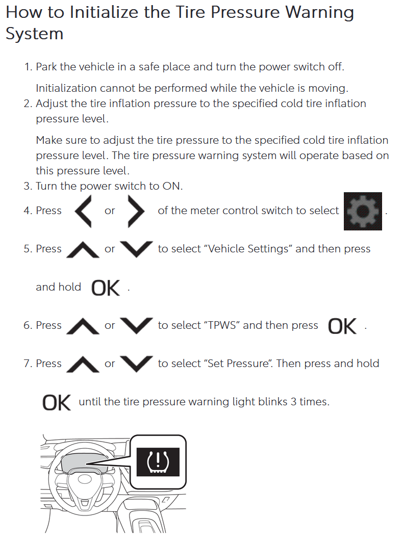

I wanted to reset the tyre pressure and I do not have anymore the vehicle settings on my central screen.
I looked on google but I find anything about it. I know for sure it was there before and I reset the tyre pressure.

IIRC it's hidden away in the dashboard. You need to go to the Vehicle Settings and long press until it says TPWS (tyre pressure warning system), select and then select on reset.

I seem to recall that the settings menu is hidden (or possibly reduced) if the vehicle is not in the correct operating mode. So try it both ways:
  • Sit in the vehicle and without pressing the break pedal press the power button. Now follow the process outlined above using the steering wheel to look for the settings.
  • Sit in the vehicle and while pressing the break pedal press the power button. Now follow the process outlined above using the steering wheel to look for the settings.
