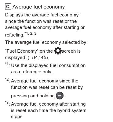

Can I set my Rav4 display to give a running average of mpg, rather than having it reset for every trip ?
If it is like the Yaris Cross you will find a setting using the steering wheel controls, left side.
Yes, of course you can ...
Have you downloaded the full Owner's Manual for your car? It's all in there ...
Edit: Page 142

I eventually found the setting to set the Total Average, it wasn't easy as the only video I could find varied to
my 2020 vehicle.
