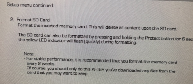

90% of problems are caused by people not formatting the SD card, format it and see how you get on. Weird things happen if you don't regularly format it. From the Nextbase Handbook

Both comments by Parts-King and Roy124 above are correct. The SD Card needs re-formatting about once a month. Its very very easy to do, just press and hold the yellow triangle shaped button on the front Dashcam, for 6 seconds.
Firmware updates are a bit more complicated and time consumimg, but not still not to tricky, will probably only have to do it once.  The Nextbase website takes you through it step by step, or the dealer might even do it for you. Good luck with it, cheers, Mark

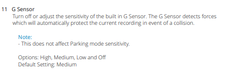

For some reason I have 4 videos from 2022 in the protected folder.  I've never pressed a button to lock any videos.
I suspect that those videos are protected, as recorded by the G force sensor, it does that if it thinks you have braked hard and possibly need to protect the recording in case of an accident. Check what the G force setting is set to.

@Iain_M is correct.  I have a 28Gb card.  I formatted it the other day to delete the Protected files.  I checked yesterday and there was a significant number of Protected files already.
Four files, front and rear, current and previous minute, were Protected.
As @Cyker surmised,  it was due to rapid braking.  My granddaughter was going to be sick and I had to make a quick stop.  Not an emergency stop but harder than usual.
@Parts-King suggests,  tweaking the g force sensitivity might be necessary, but how?
With two cameras, one minute recording cycle,  you can soon get into an overwrite cycle,  especially with an excess of Protected files.
