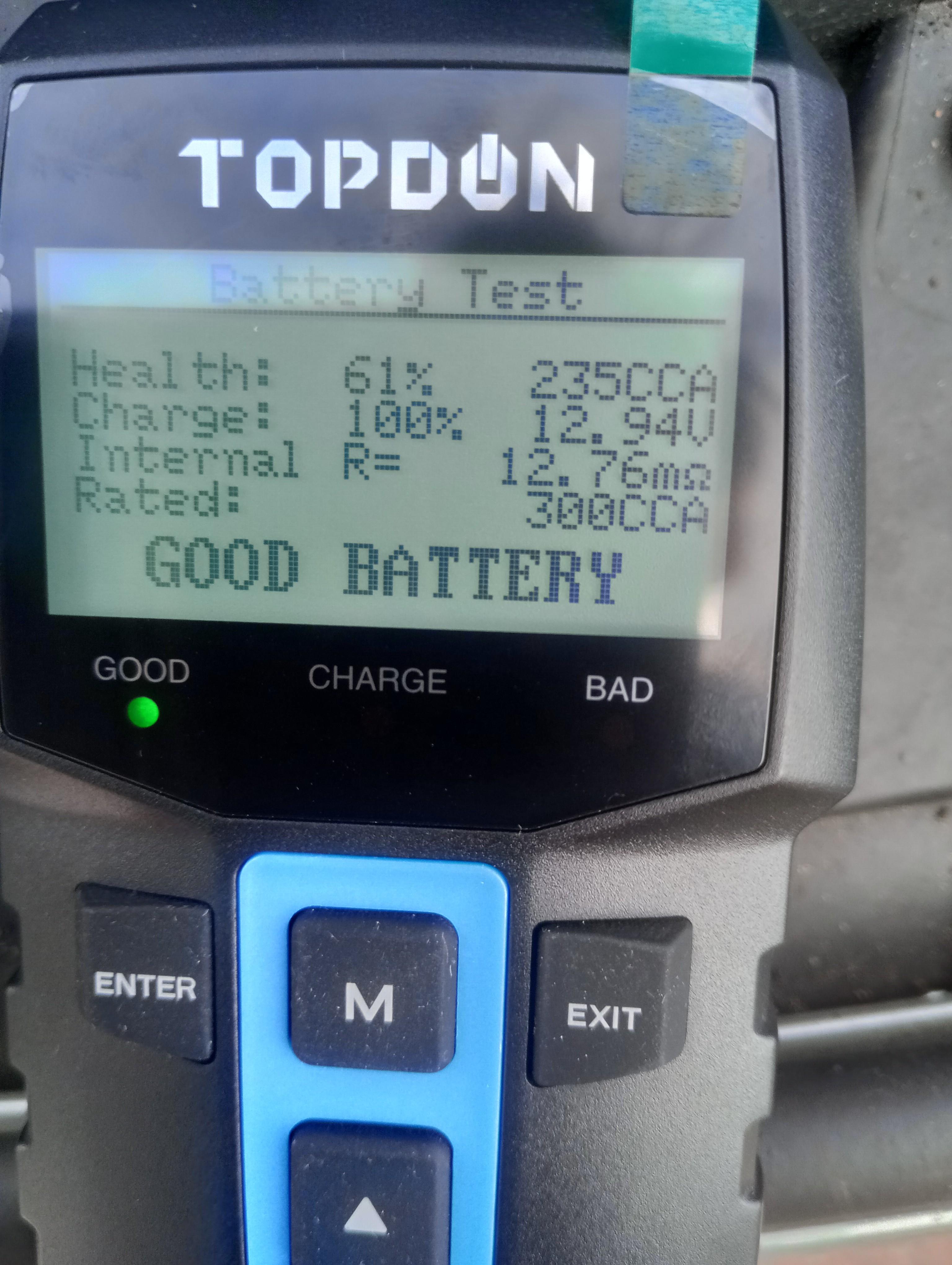

I tried the Battery tester this morning Vandals01, instructions didn't say wether to remove the Battery leads? Which I did anyway, connected it up, I left the setting of type of Battery as 'Regular Floode d' (rest were AGM flat plate, AGM spiral, Gel or EFB).
My battery had a sticker just hanging on with:-
Fullman 12V Lo 35Ah 300A EN
Set the tester to 300A, and the photo shows the results.
The crank test says the engine must be on, so will run the engine and connect the charger to the terminal if possible as there's not for them to latch on and get back to you on my progress.
Hopefully I've done the battery test correct so far?
Best regards Keith IMG_20240511_080554_HDR.thumb.jpg.e2bd71c34979c7973af780f5950979fe.jpg
You will get another year out of the Battery
