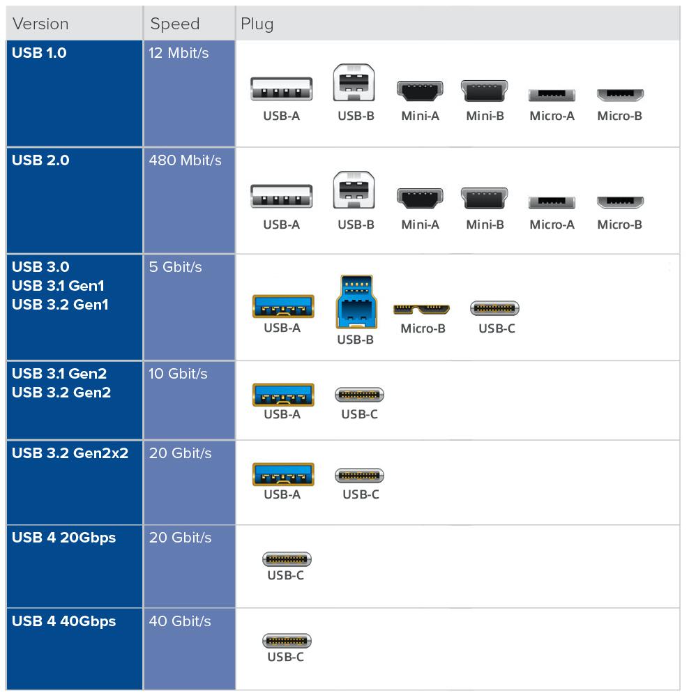

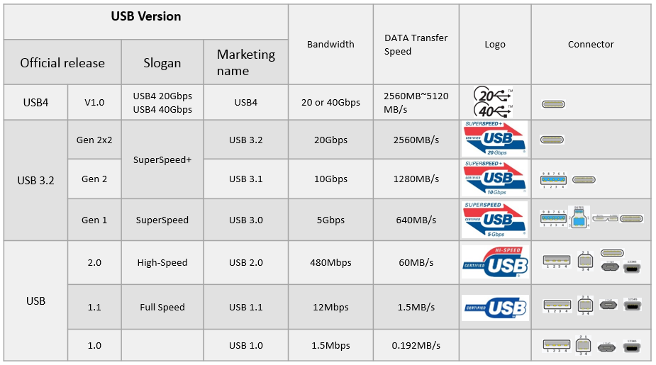

The USB “standard” is only about the shape of the connector. Eg type-a or type-c being the common ones of 8 “standards”
like hdmi the cables will be rated for speed so it is entirely possible to buy a 2m cable from ali express with the correct connectors for usb-c but wired with resistance values that underperform the speed index of usb-a v1 (12mbit/sec) and therefore rejected by phone.
