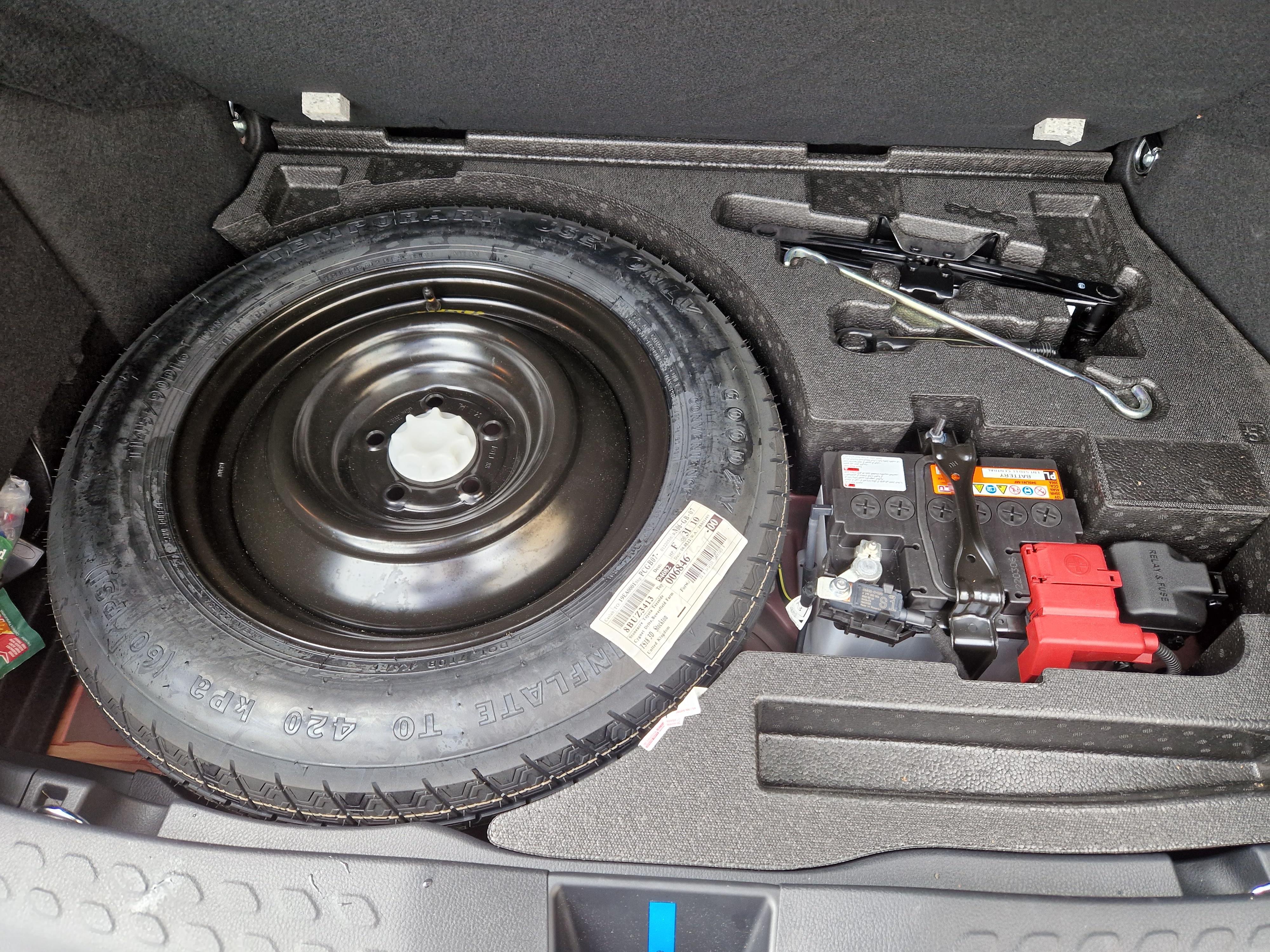

Hi can I change my boot foam to fit a space saver tyre
This was my 2 litre CHR. Not cheap but in the great scheme of things.
2 litre hybrid is cheaper to retrofit a space saver spare due to less parts required compared to a 1.8 hybrid.
The 1.8 hybrid will also loose boot storage space due to having to raise up the boot floor to the same level as the 2 litre hybrid version.
