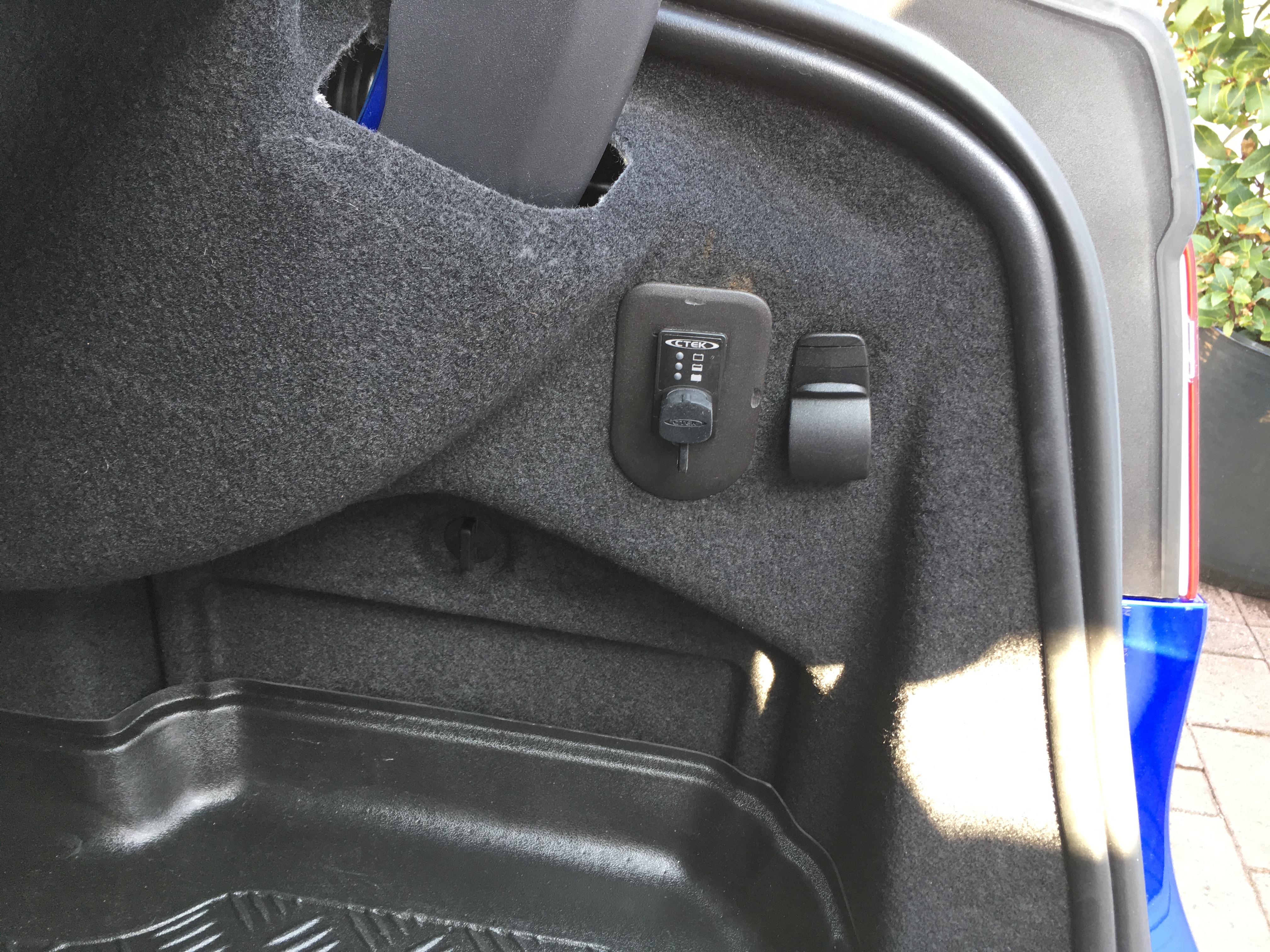

Is it best to connect the CTEK to the terminals under the bonnet
Yes
That's what I do - 'cos it's easy ... 😉
That’s what I thought 👍
My previous car was a Jaguar R-Sport and the Battery was under the spare wheel and a nightmare to get to, especially when the boot was loaded up, so I fitted a CTEK panel socket, which made things much easier.
