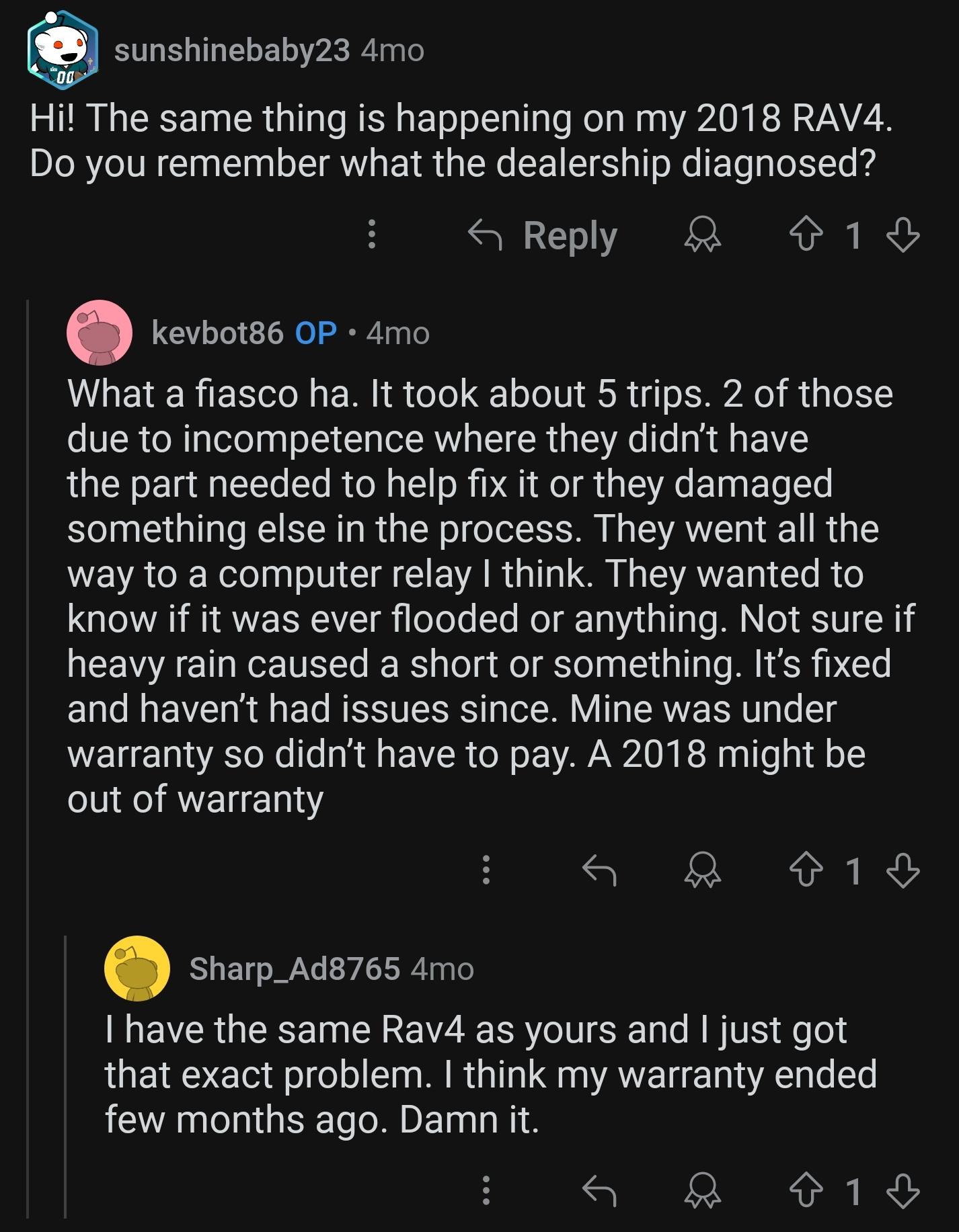

Reading a lot on Reddit. Seems that water can get in the door and be a potential cause. Relay switch would explain the click clicking sounds.

Thanks Nick for all your research and help, plenty to think about and to talk to the dealer about, fingers crossed they can get to the bottom of it.
