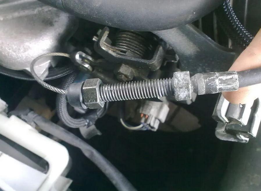

If yours is a cable operated carb then you should be able to adjust the cable stop to hold the tickover at slightly higher revs.
It is a cable operated fuel injection system.
As above, clean the throttle body/butterfly and should be adjuster screw probably set it round 850-900 rpm.
May get better assistance  on a Starlet forum, guess that engine common in Starlets?
Do not know what type of cable adjustment you have, various images on the web,  but this video shows how to do it on some models,  if you can follow Peters broken English.
