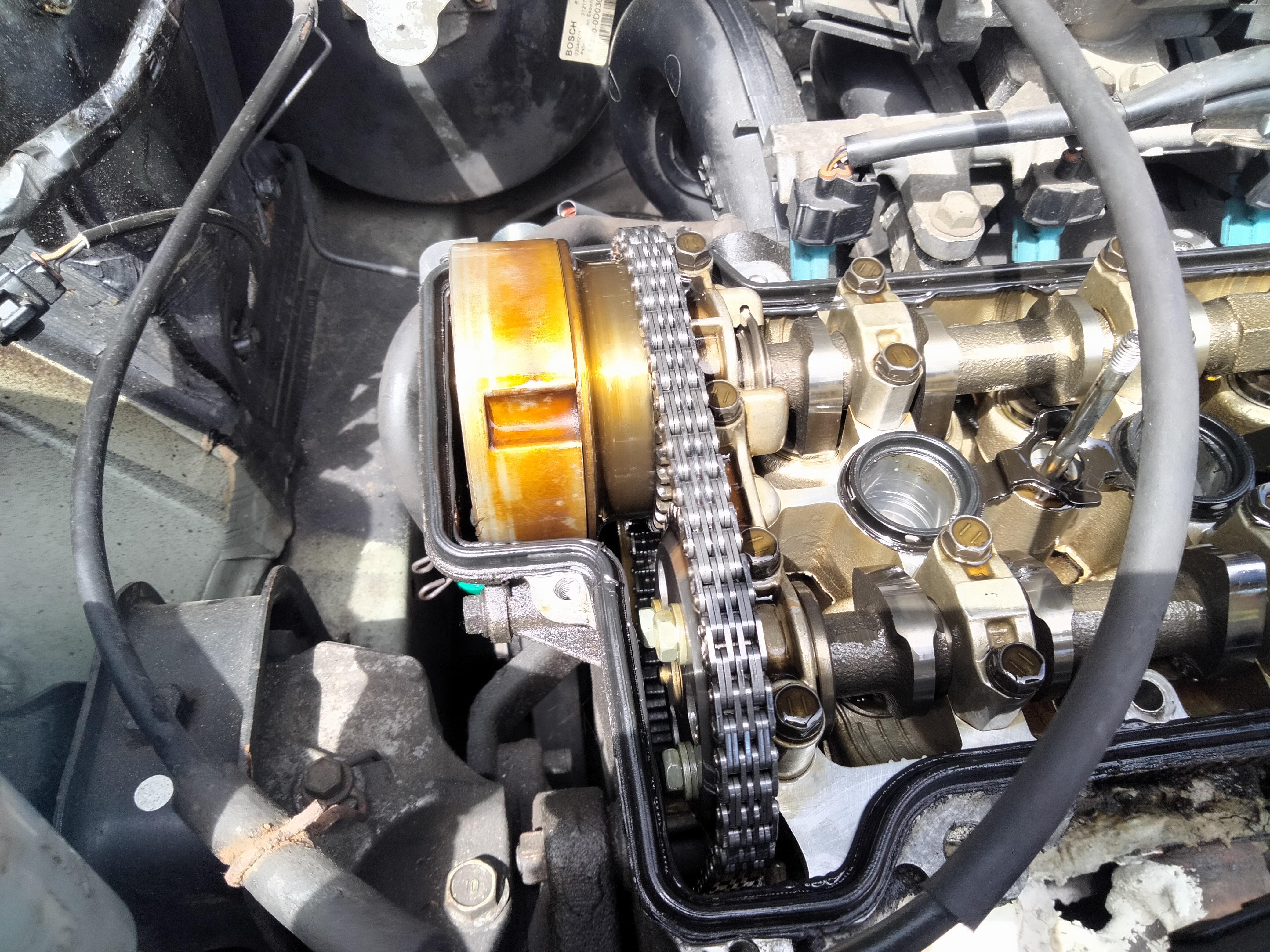

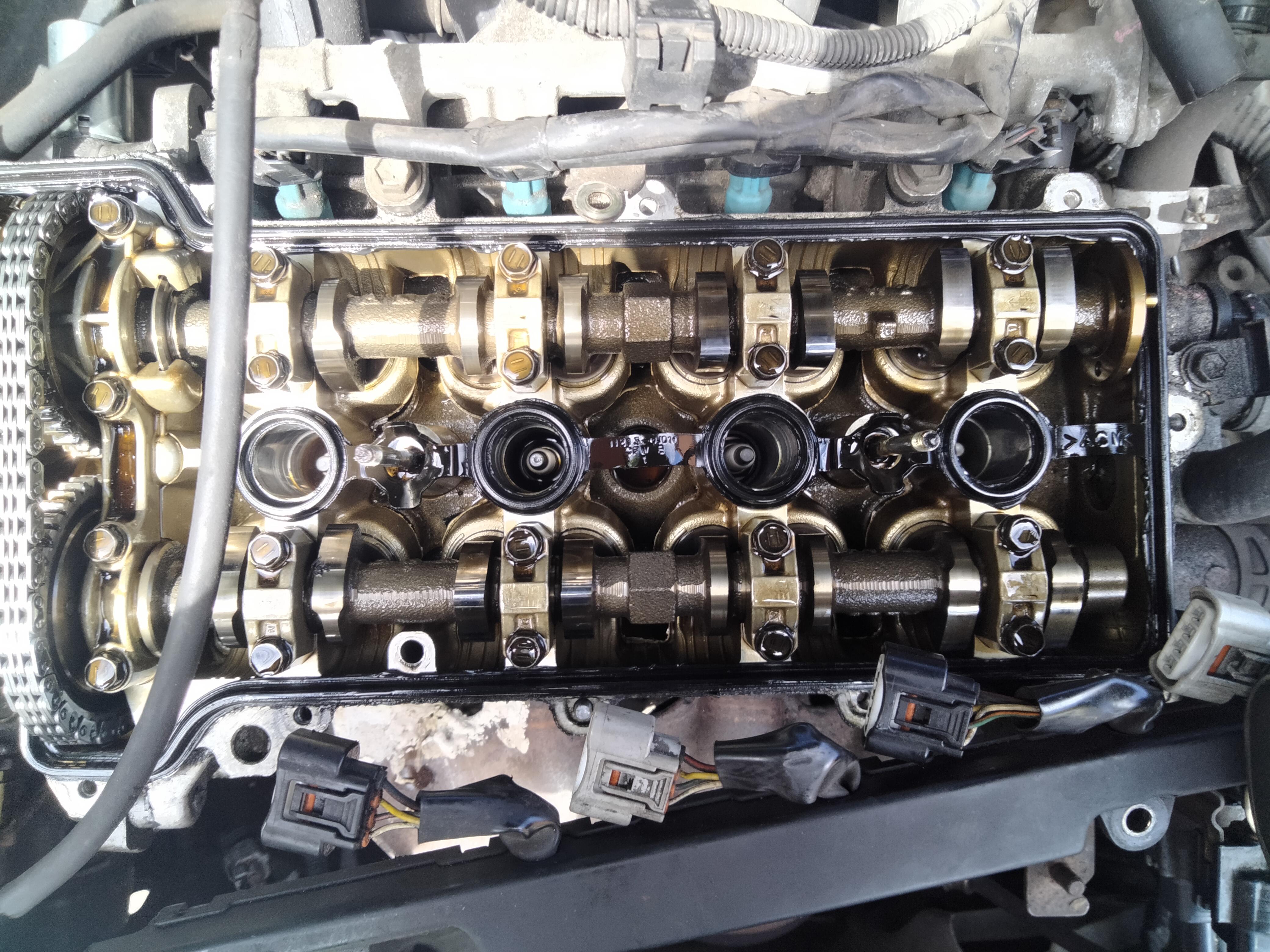

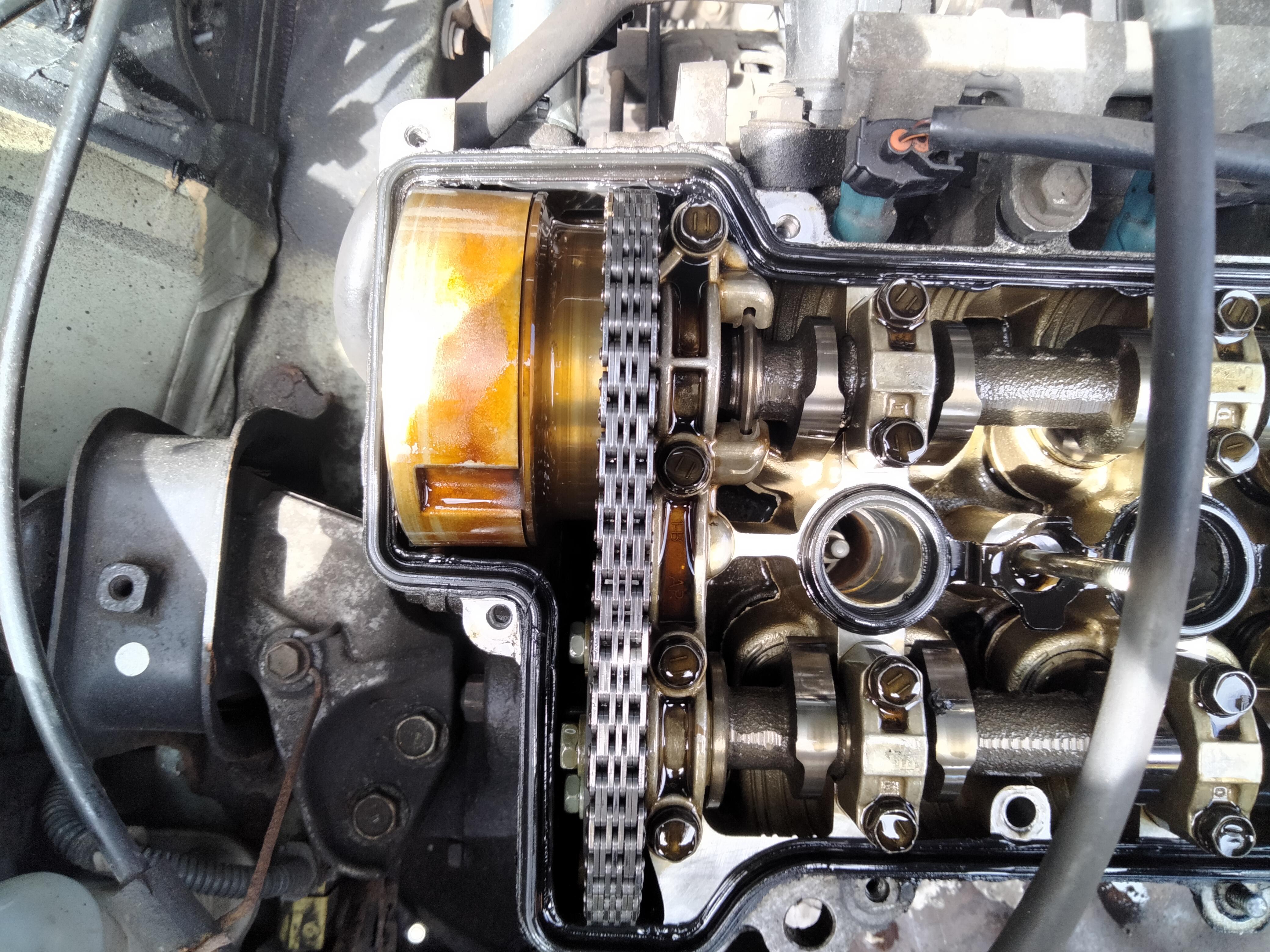

So I've removed the valve cover today and change the gasket as it was leaking oil onto the spark plug wells. I had the opportunity to check the engine condition while I was there. Very clean engine but I knew this because I service my car regularly with quality oil so I knew it was clean. The chain is tight and it appears that the timing marks are aligned the gold plates on the chain lined up with the timing marks on the camshaft and vvt pulley though I didn't get a picture of this. I took some pictures of my engine when I took my valve cover off.
Looks like my P1346 lies with the ocv circuit wiring somewhere. I'll keep looking....
The VVT gear stays in time with the chain it's the cam that advances or retards through oil pressure
maybe the OCV has mechanically failed but tests fine
Certainly possible. Though when I remove the connector from the car but leave the ocv in situ and go for a drive, my car severely loses power and the code for the ocv circuit pops up. Once I reconnect the ocv clear the DTC codes and go for another drive, the performance is restored but P1346 comes back after an engine restart or 2
Surely this will mean my ocv is working? Was thinking about getting a BluePrint ocv as they are a really good brand, OEM spec. Maybe that's what I'm missing?

*Update* So my car was leaking oil quite badly after I did the rocker gasket. Noticed after a long drive the other day with a patch of oil on the floor. Today I took it all apart and cleaned up the surfaces and redid it again and tighten the bolts more tight. I decided to check the timing marks again by turning the engine over very gently, I discovered that the gold marks on the timing chain did not match up with the timing marks properly. Looks like it's 1 tooth out.... So I think I may have finally discovered the problem. I can't say for absolutely certain. Not going to try it myself in case I destroy the engine. I'm going to leave it as my car still runs fine until the mot in November. Fate will decide what happens next. If the car fails with only the CEL, I will get it fixed. If there is a ton of additional work, I may have to weigh in options. So if anyone else is reading P1346 could certainly be timing out of sync. The garage I went to looks like they've fitted it wrong
turn the engine over 5 or 6 times if it is one tooth out when the vvti comes in it will over advance by 4-6º out of spec of what the ECU is expecting
