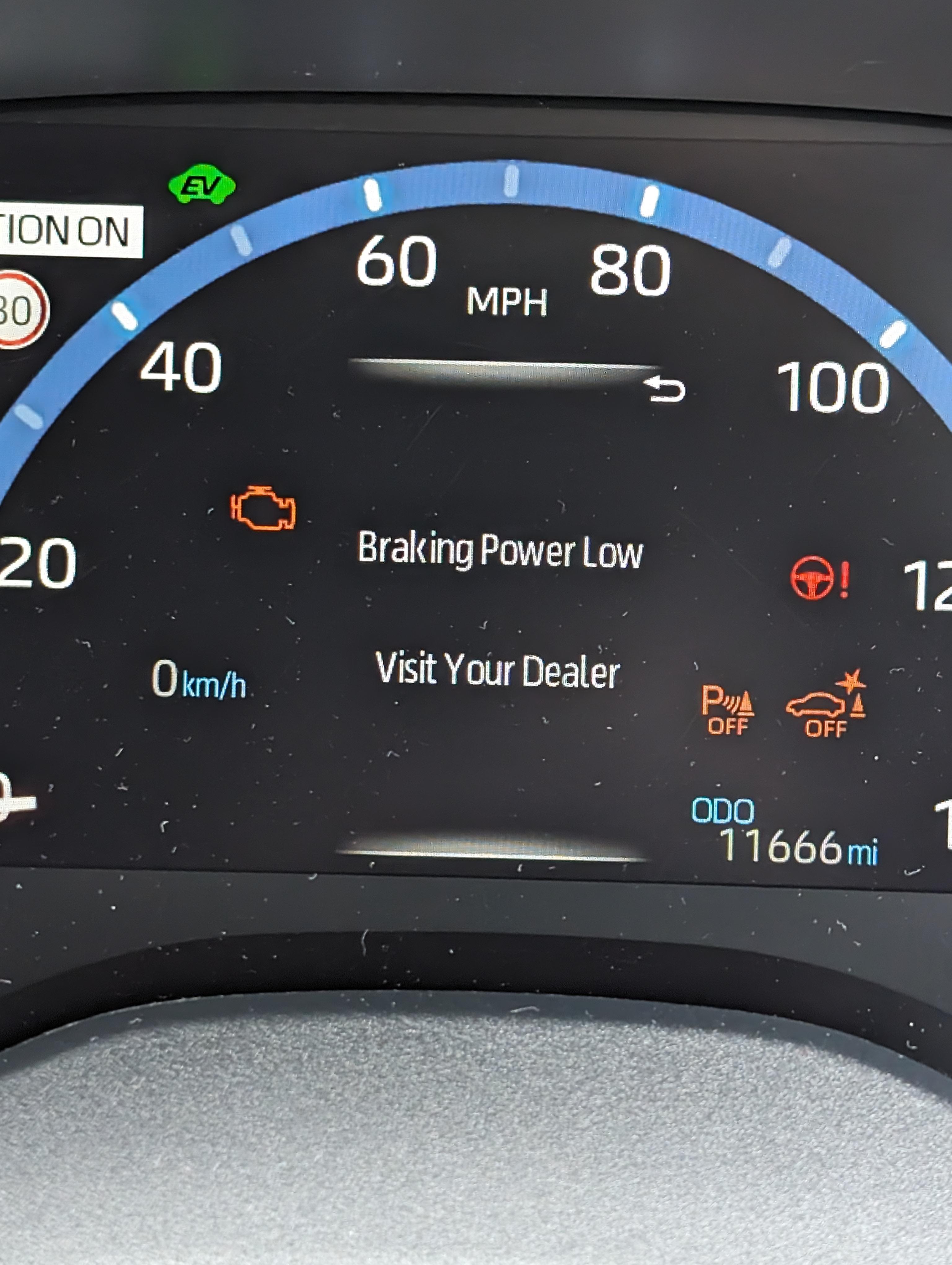

I was messing about in the YC today with doors etc and radio on (yes, I know) and I can't get it to start.
Should I jump it with my starter brick or trickle charge it ?

I think it's a bit of "scare mungering" that "Visit Your Dealer" pops up on the dash for what really is just a flat Battery that needs jumping or charging.

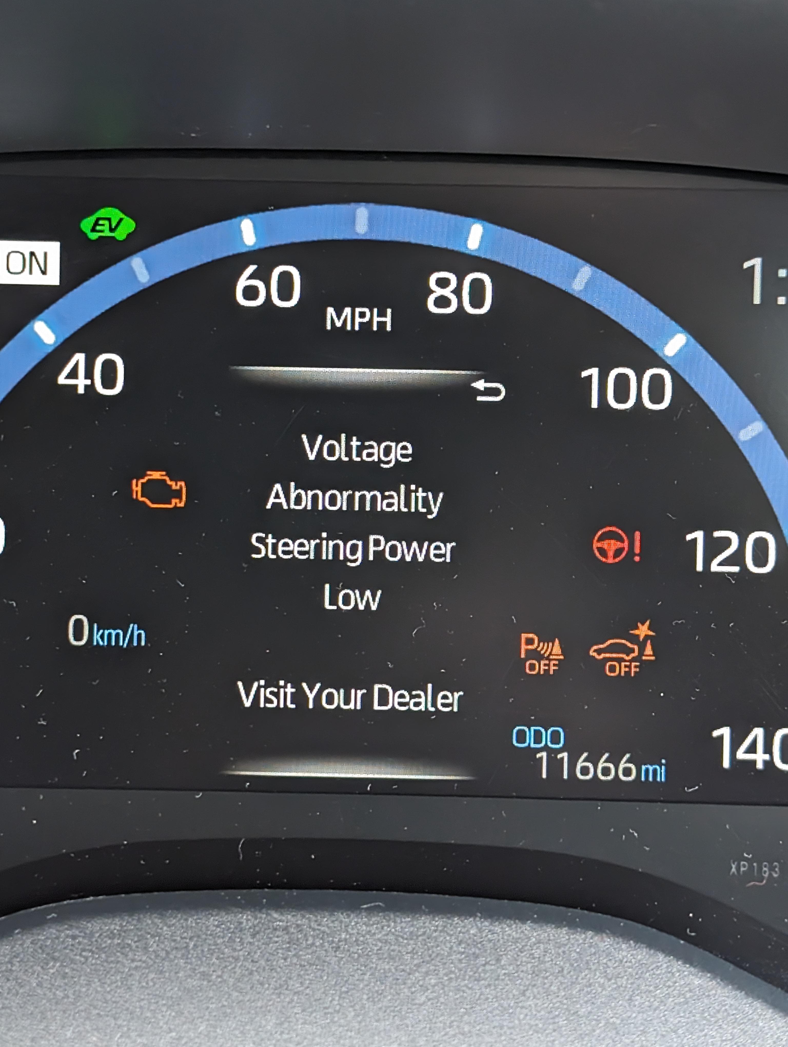

System doesn't know what exactly is wrong. It just indicates malfunction due to low voltage. If that was DC/DC converters fault which caused it to charge insufficiently or the Battery which is damaged and holds only a few Ah's then you should actually visit the dealership 🙂

Brake power low is because the backup capacitor under the passenger seat (black box) has discharged - this is used in the event of total power loss it allows the brakes to operate

The voltage abnormality appeared on ours this morning, called AA who turned up in 30 minutes and sorted with a booster pack. No need to visit dealer I thought and left it in ready for 90 minutes before going out to check. Car goes into ready now but large screen in centre no display so no radio or sat nav .... going into dealer tomorrow. Hopefully only a fuse and not a long job !
