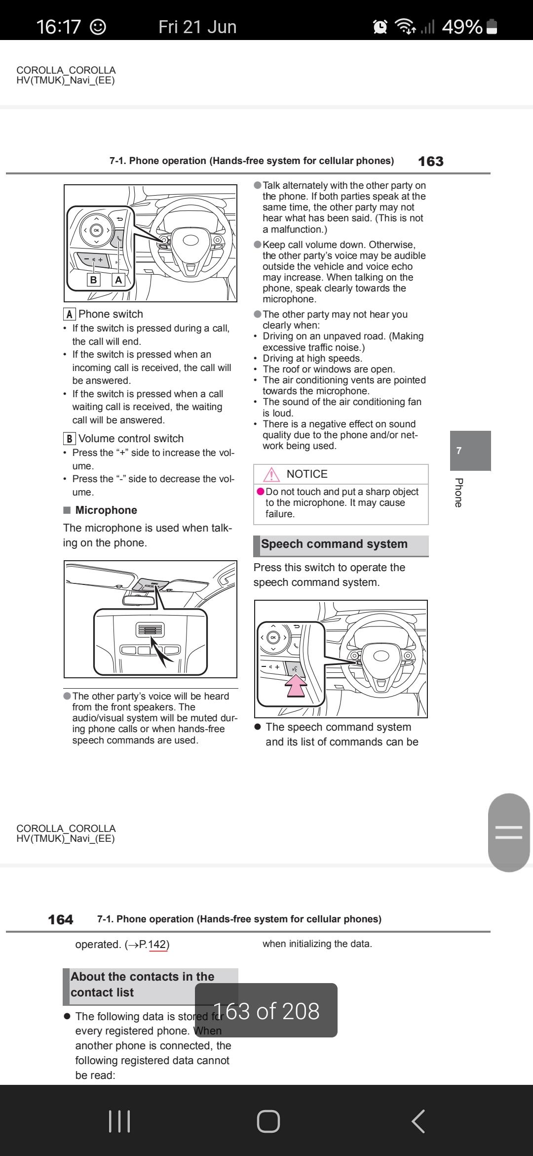

Have you tried the volume control on the steering wheel (LHS on my 2019 Corolla)? That's what my infotainment manual appears to say, though it may only apply to the incoming call?  Or is the  microphone location covered, or perhaps one of the reasons given on this page occurred at that time? Screenshot_20240621_161733_OneDrive.thumb.jpg.030a6f413fc19e0bb1cc35c8df1b27e7.jpg
Doesnt work with 2023
