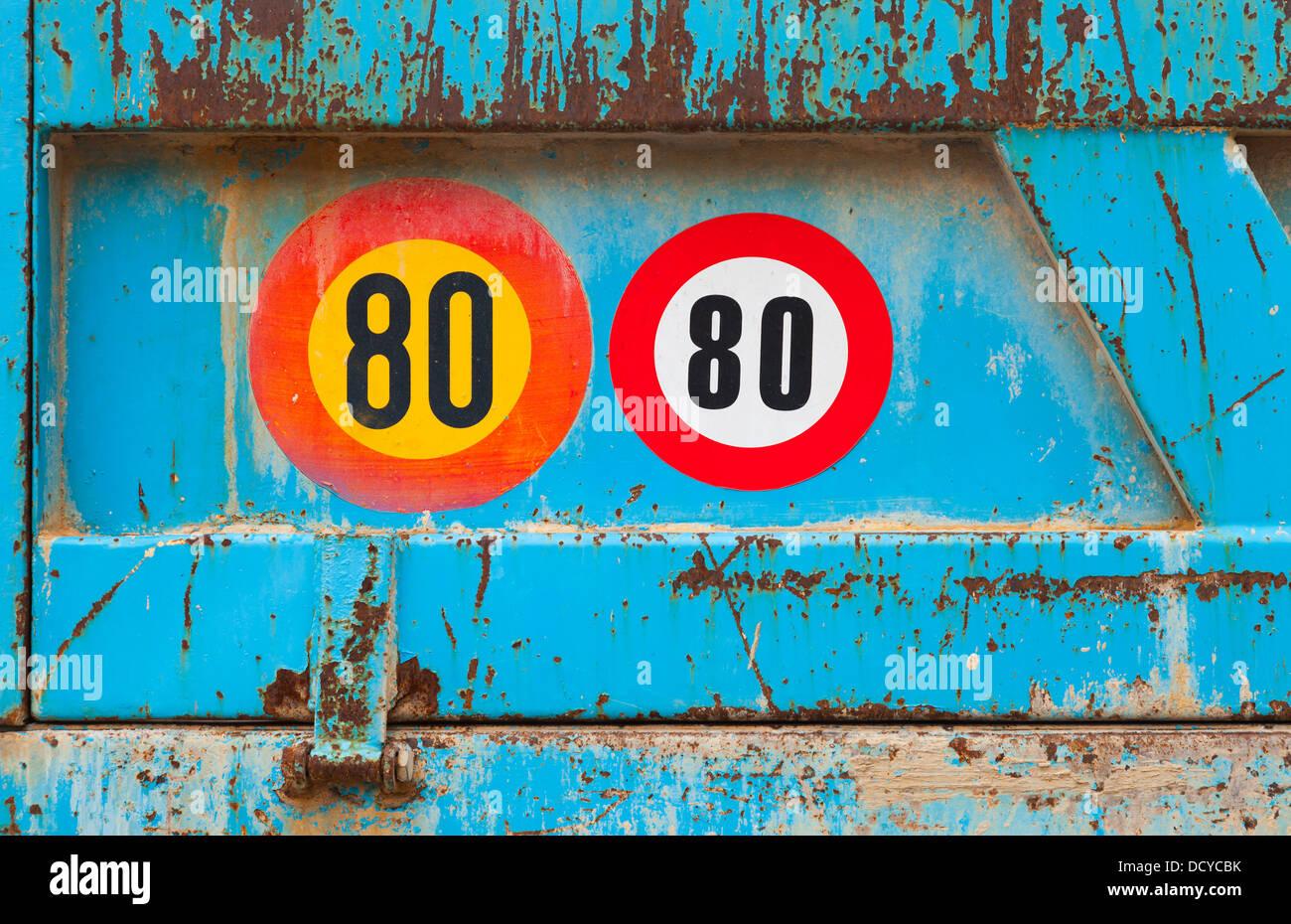

Nah sorry
back of a lorry is 100 in a circle. There is no indication of kmh or mph.
just a number in a circle
toyota system is dumb dumb dumb
speaking as a tech. It Would be better if the system had a “country database” with valid values for rsa , so 100 would be rejected as the “max” UK would be set to NSL (70) and therefore rejected if scanned as too high.
