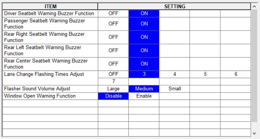

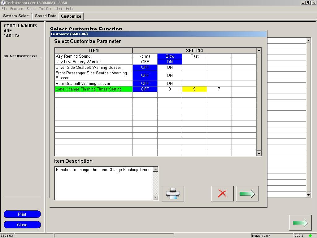

With the Techstream software, it's under the "Customize" tag.
Go to any ECU, then "Utility", and then "Customize -> warning".
Sad if this option is not available in your 2024 car. Sometimes it seems we go backwards...

setting from my 22 yaris
