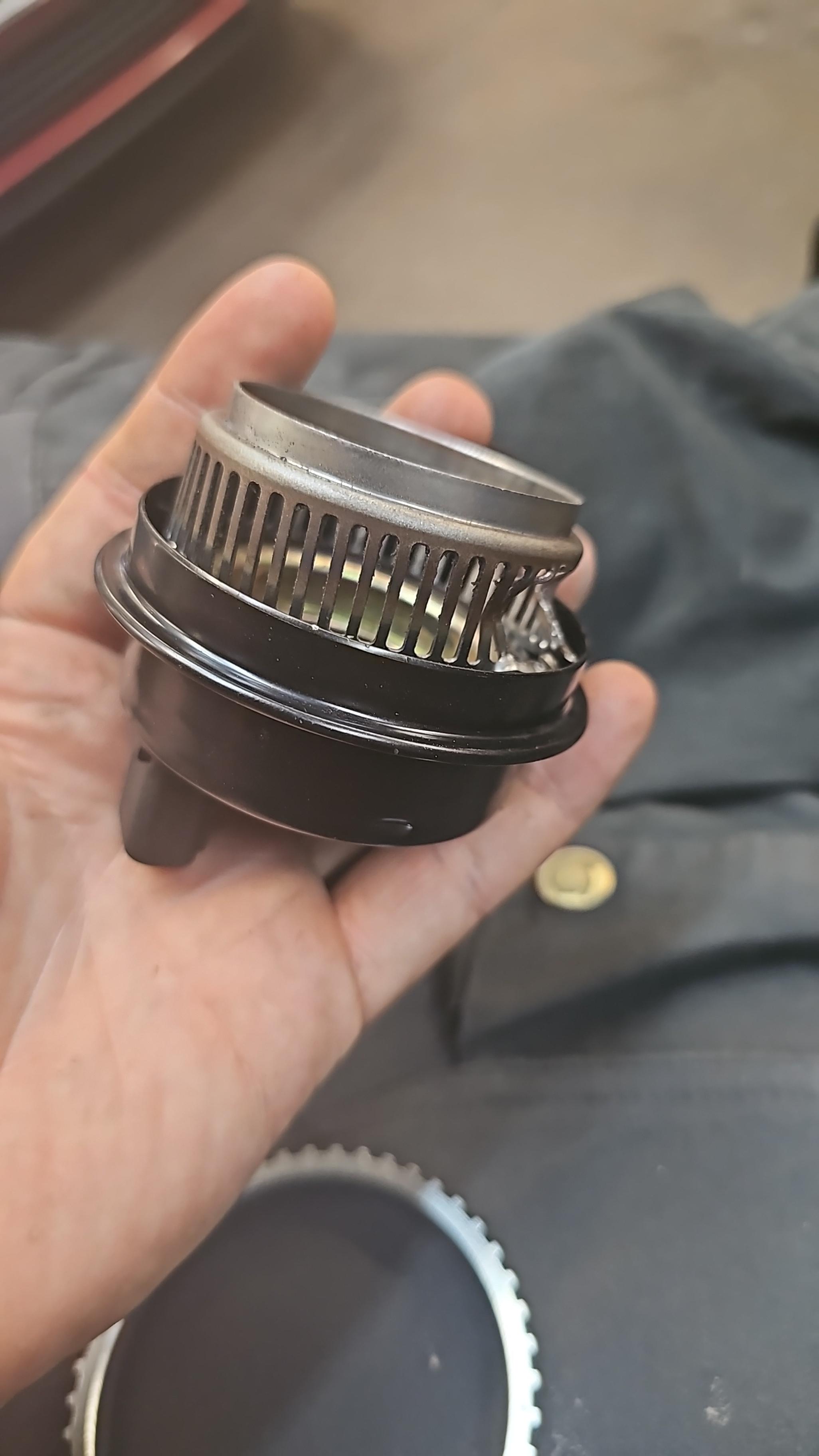

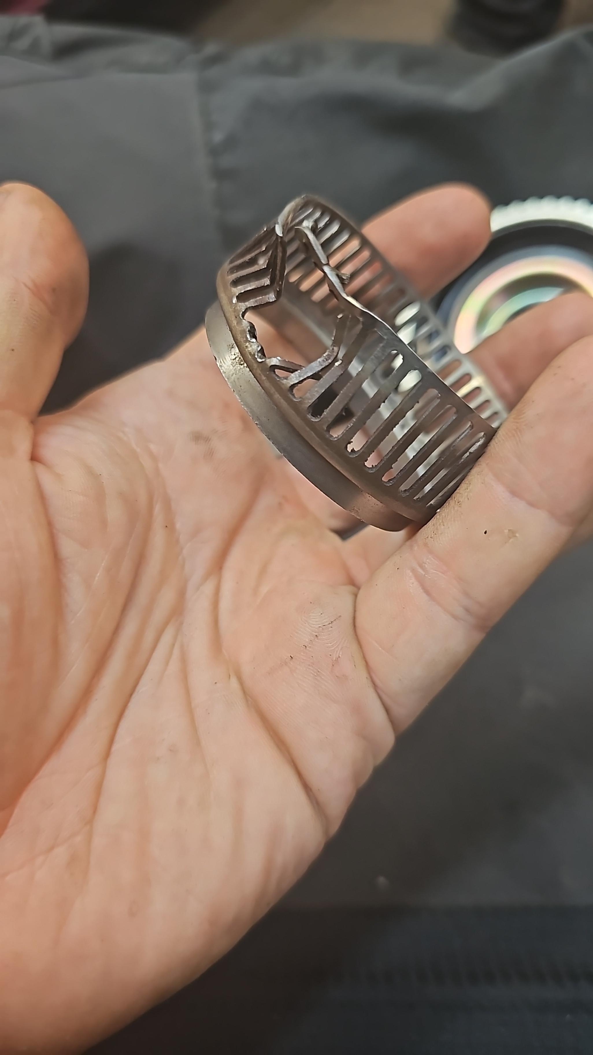

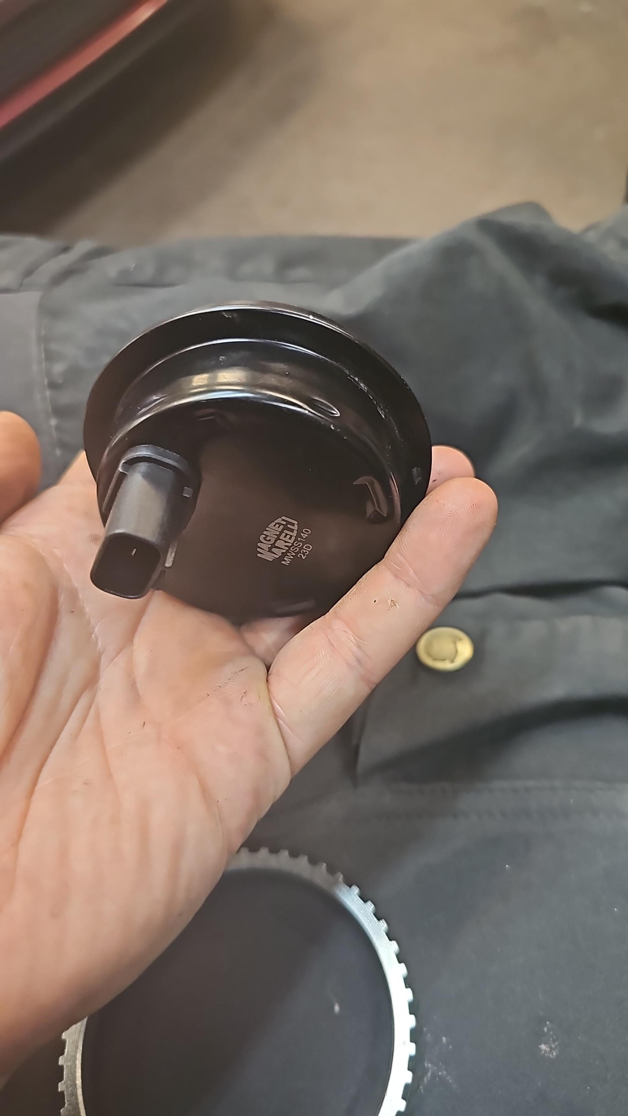

Abs-sensor ring broken.
riidi
That spinning wheel inside rear-right abs-sensor broke.

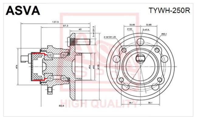

EDIT: Or it have to be with wheel hub (bearing)?
42450 05 040 FEBEST, A.B.S. Wheel hub, Wheel bearing kit, Wheel stud cheap ▷ AUTODOC online store
This ring is part of sensor (I painted it "red")
