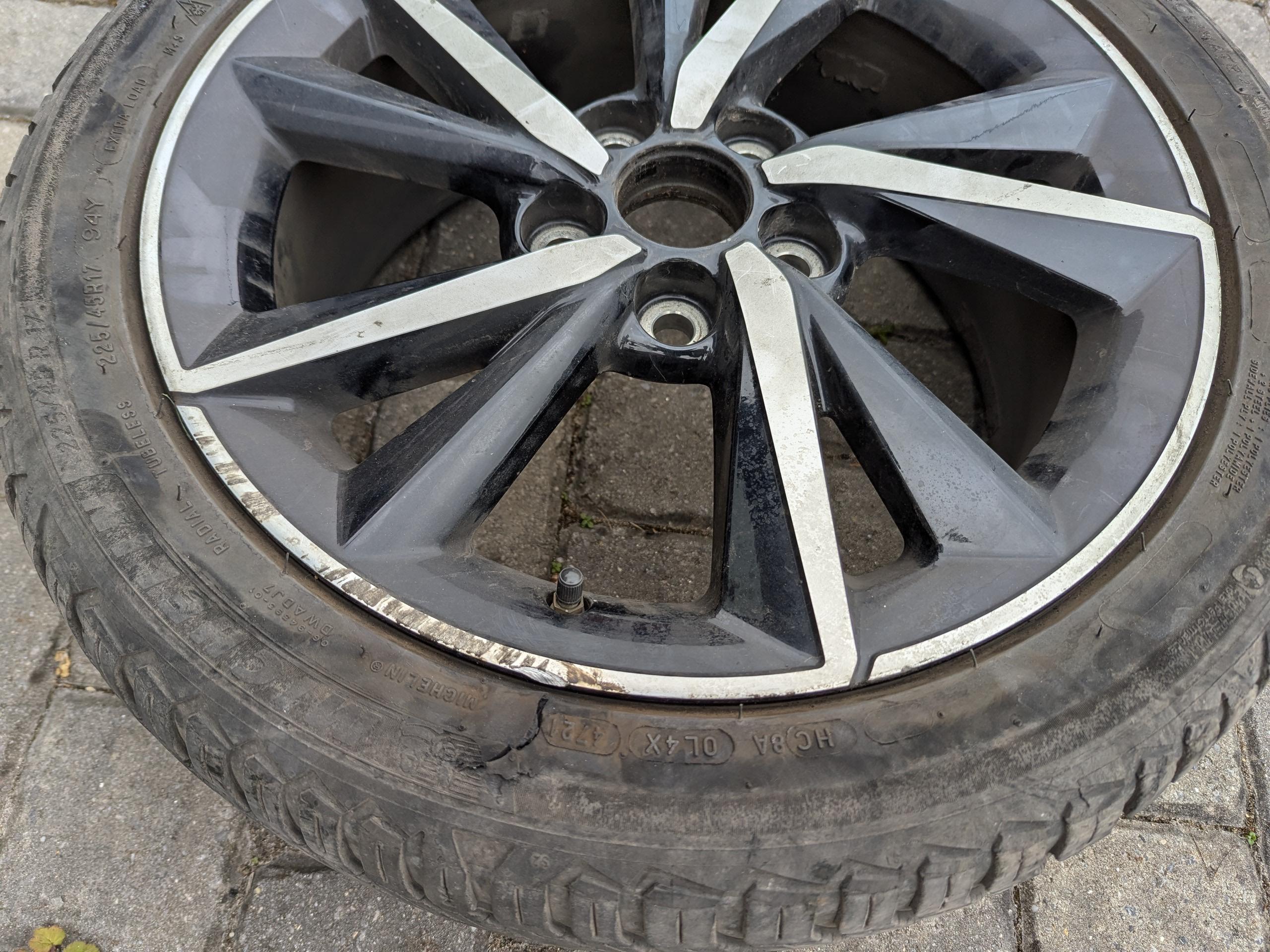

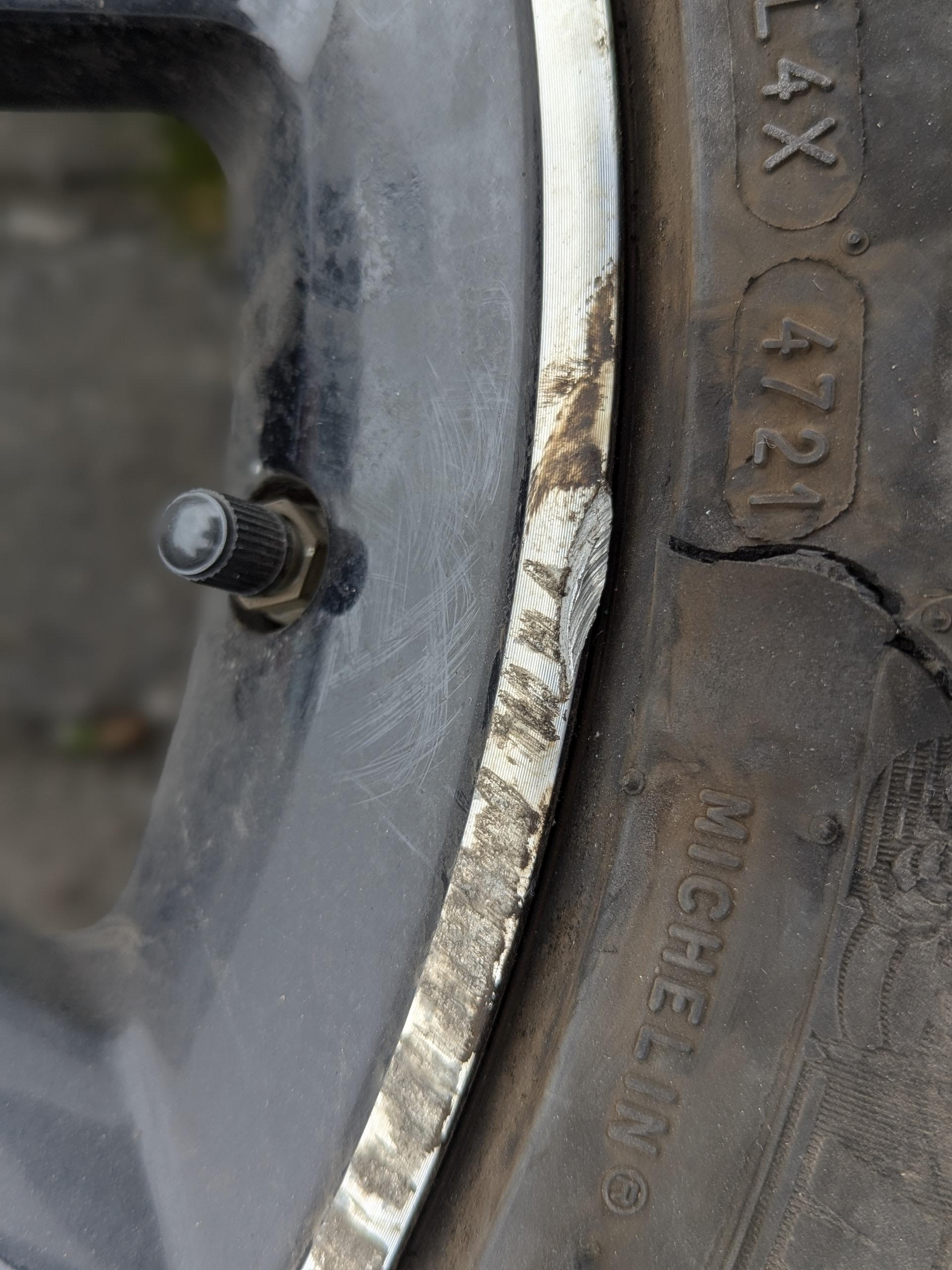

Thanks guys... i am going to get two new and keep the ok front one in my garage as a backup spare. The rim looks to be ok to me but will ask the mechanic. The darn road I was on has too many and deep potholes, drivers tend to swerve around to avoid them. This driver was almost in the middle of the road and instinctively i served a bit too much on the left.
PXL_20240630_095657375.PORTRAIT.thumb.jpg.02403e8032fc8cf55658fcee2bff4b1a.jpgPXL_20240630_095646963.thumb.jpg.b6b4f983ad909e2abe8e6d53e1463c40.jpg
How bad does it look?
  The outside of the rim is not looking too bad, more scratches than bends, with some sandpaper and a drop of lacquer it will look much better, but I want to see the inside of the rim...
It looks like the wheel is ok, just a small scratch.
