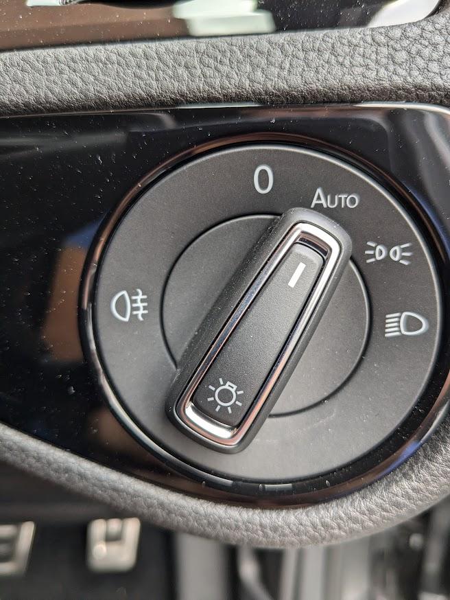

I don't think so.   All the recent VW Group cars that I have owned that have had DRLs have had an 'off' position on the light switch.   Including those with auto lights.   The light switch just didn't control the DRLs which came on with the ignition.
You are correct...my Golf has an off position BUT if i put it in that position and the sensor says it's too dark i get a warning on the dashboard to put my lights on...however like most people i leave them on auto.
