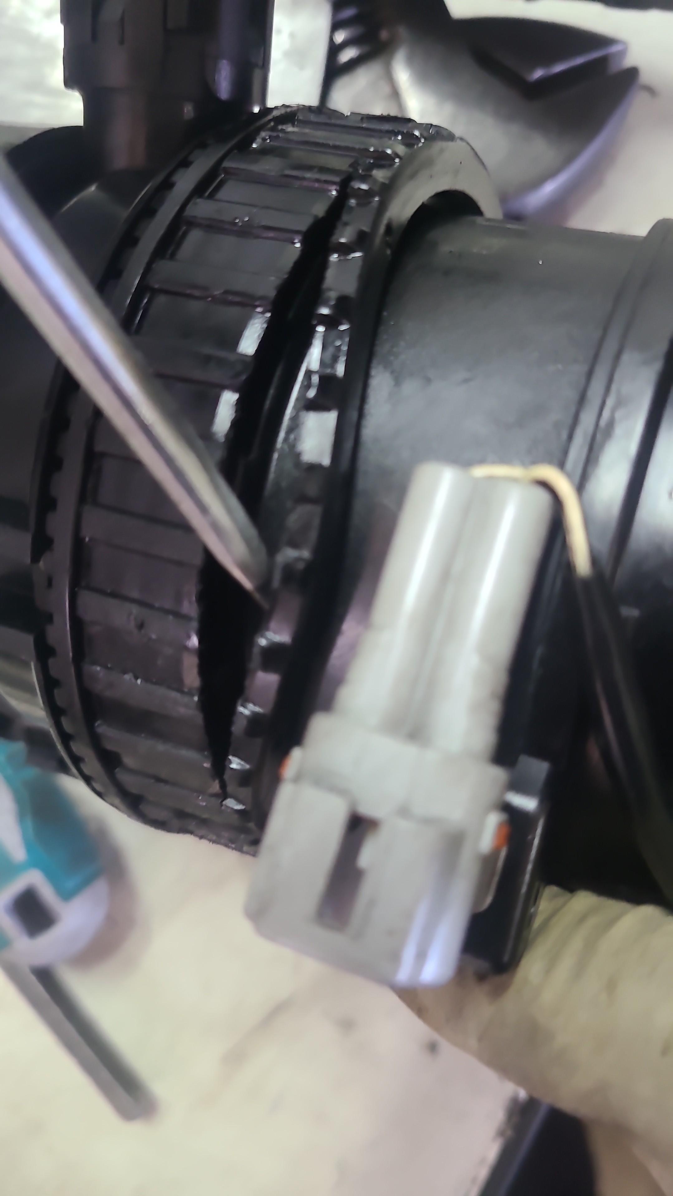

My Toyota Hiace full system keeps building pressure and causes the fuel filter to burst open and ideas why IMG-20241004-WA0005.thumb.jpeg.c80aba1200ef3152aeed5ace37cb0647.jpeg
