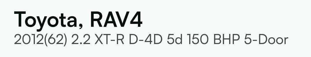

Hi sorry ,, I suppose it all did sound alittle vague,, so the whining starts once I get to and over 40 miles an hr and by intimitant I mean it's there pretty much all the time but varies in pich ( sometimes it sounds like it struggling more than others- no specific pin point) I have no loss In power and no lights on the dash . When I take my foot off the accelerator it's stops completely changing gears braking , stopping etc and as far as where it's coming from well just infront of me I guess so the engine area , it's manual Screenshot_20240710_144354_Gallery.thumb.jpg.22890b1d2d081f49675944da36eb4da4.jpg
