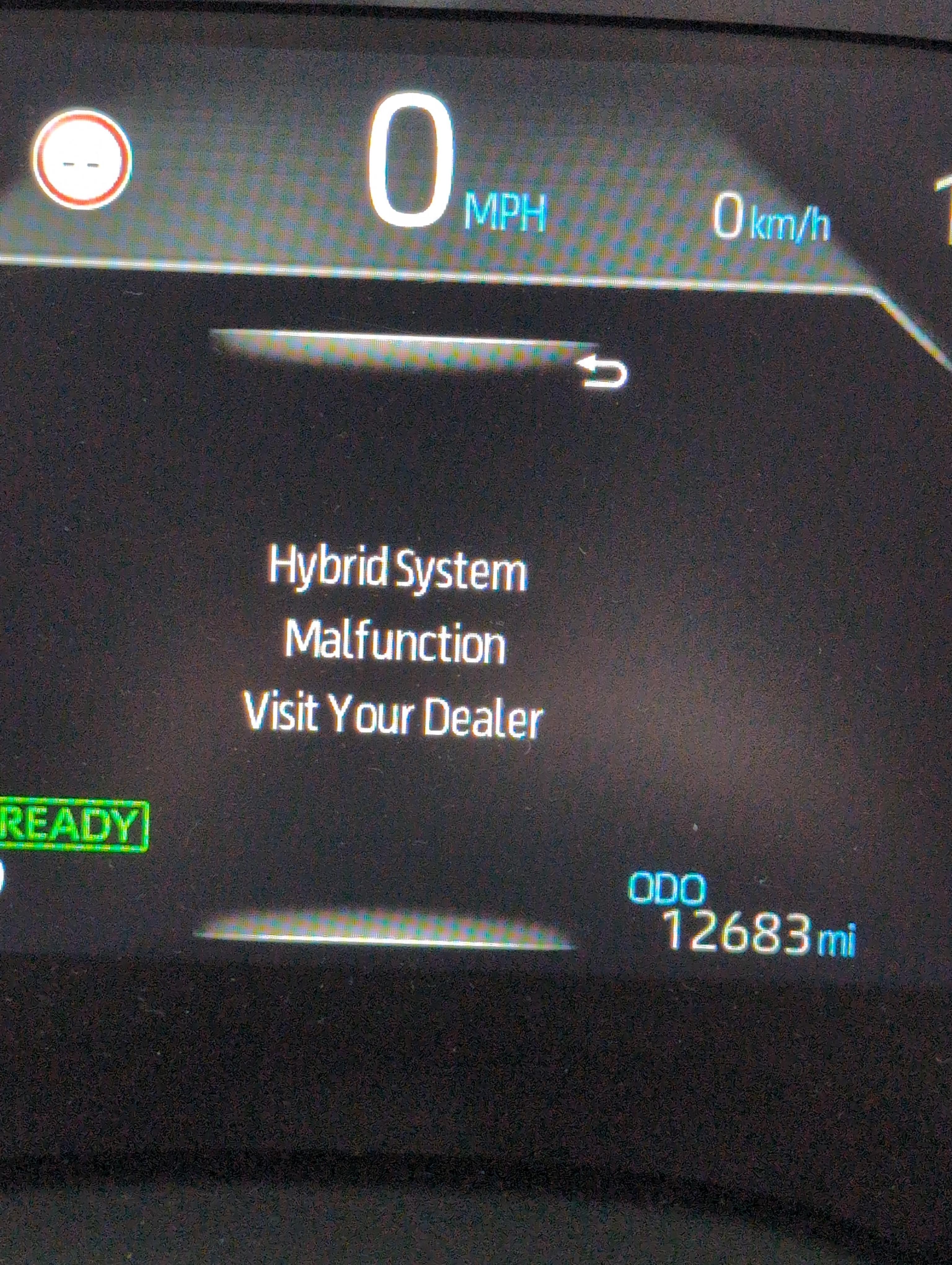

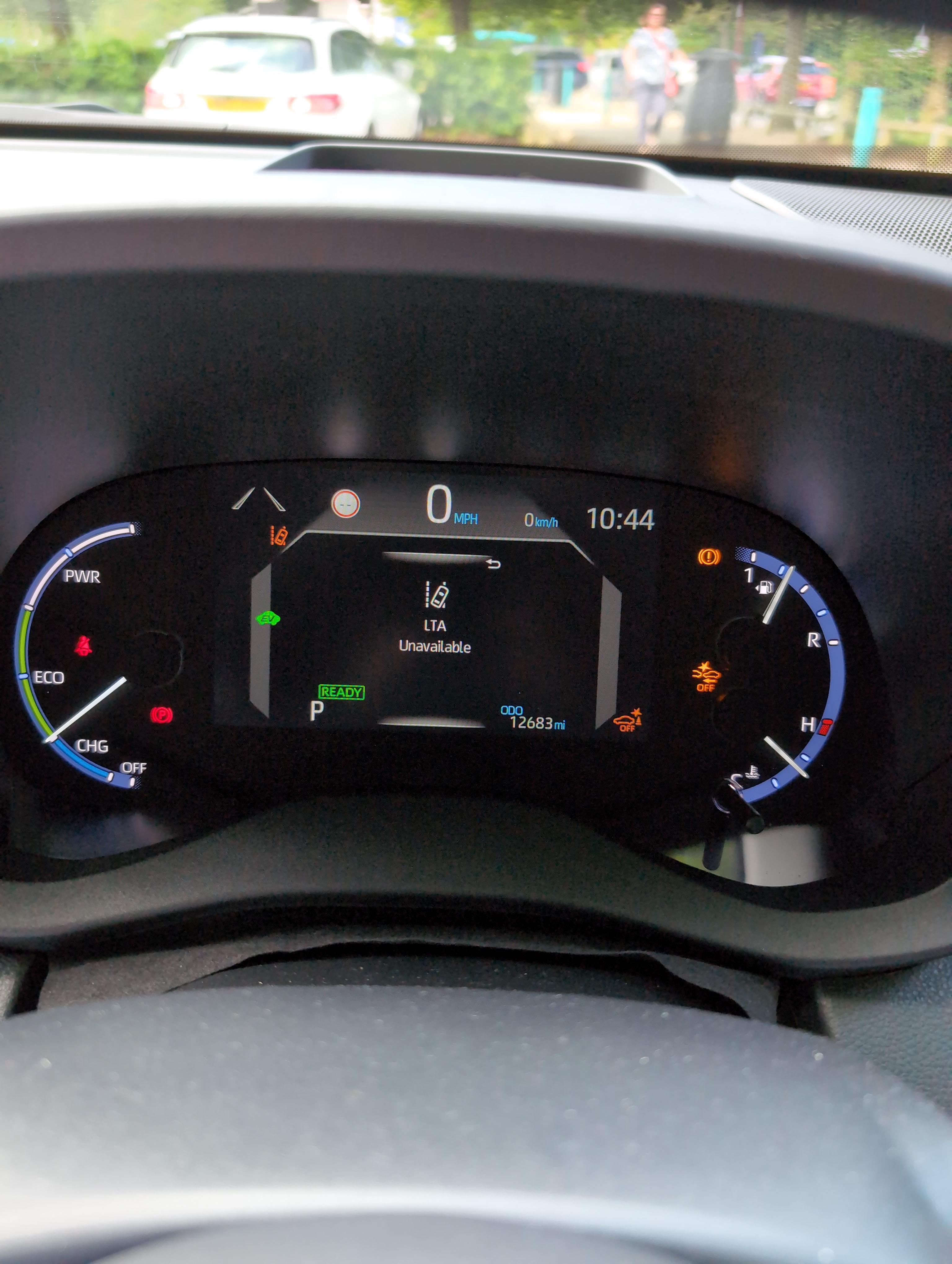

Just came off a roundabout to get onto a slip road to M3, put my foot down to accelerate, car felt like it braked for a second and then I got Blackpool Illuminations and beeps on the dash.  Everything is coming up as Malfunction.  Crash Detection, Parking Brake etc.

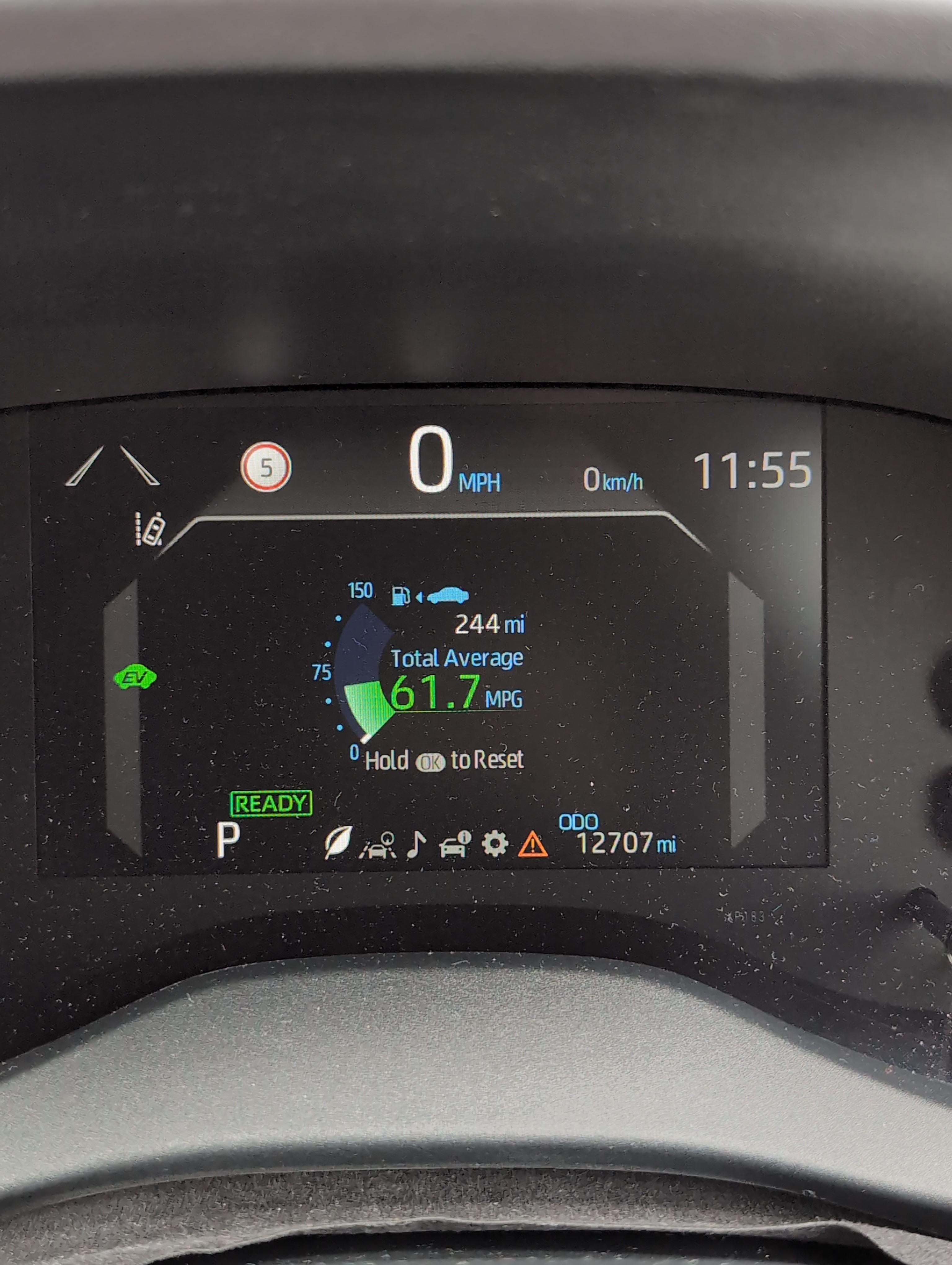

Stopped at Services, took these photos and turned the car off.  All lights have went off except the warning triangle and the Visit Your Dealer warning.

do not clear any codes take it to the dealer, if it has a certain code they will replace the engine damper

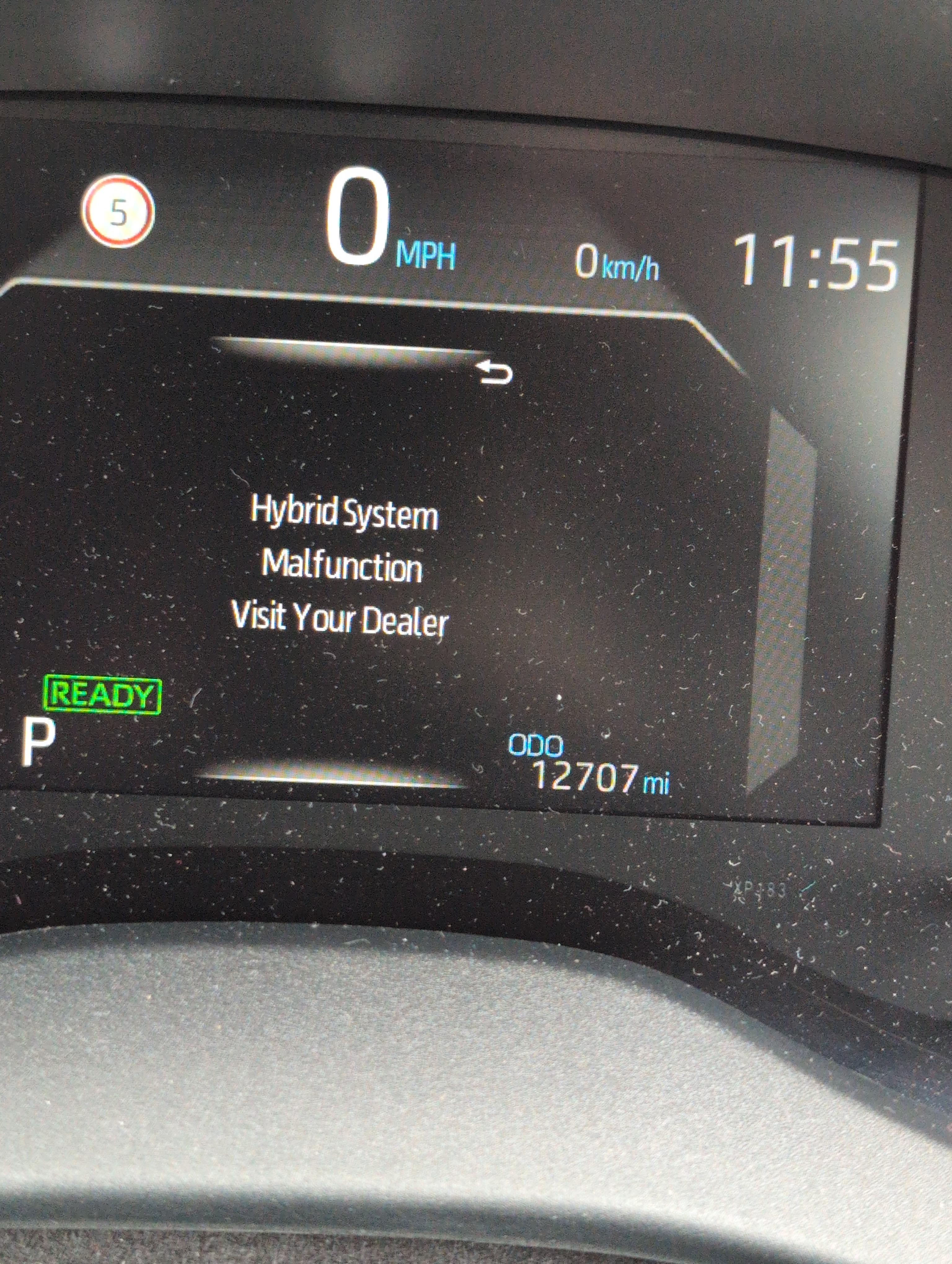

Ok, I'll assume it's still ok to drive, because it's not telling me to stop.  After turning the car off and then on, it reset cleared more or less everything itself apart from the warning I stated and a triangle.  Why does this never happen when I'm popping to the shops and Toyota are open and up the road !!
I'll pop in and see them on Monday.

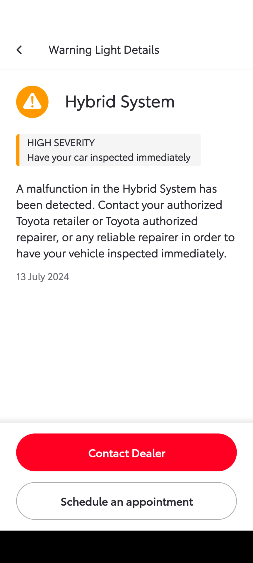

Yes everything seems fine and everything is working.  The MyT app shows this..
