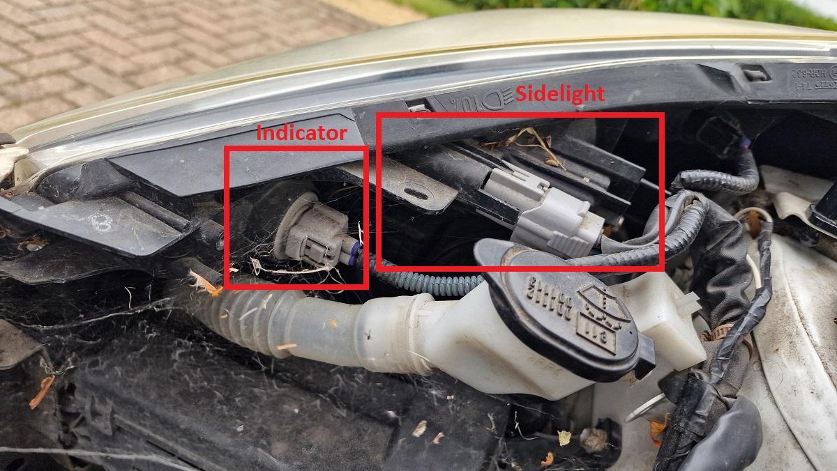

No I remembered it wrong, they are not i n the same place as the headlight they are separate, see picture.
Ah okay thank you so much! I have been fiddling but they don't seem to budge is it recommended to try using so pliars? Or wd40?

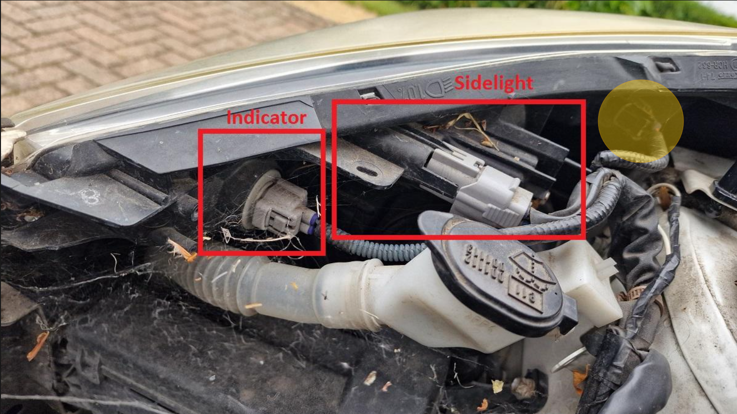

If the question is for the front position light, it is not correctly marked in the picture above. I added it in a yellow circle:

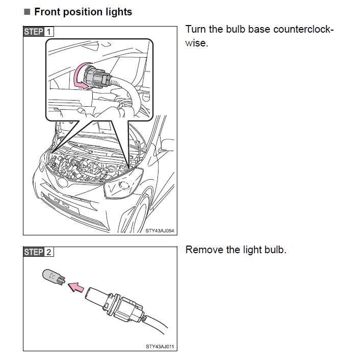

How to be replaced is explained in the owners manual:
