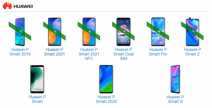

1 hour ago, hind said:
This is the problem
That was my thought - it's a 2017 phone and Huawei have been 'disconnected' from Android since then (possibly hence the response in the link about the AA app not being available), so not being able to update the o/s seems a probable cause.

Ah, you're right - missed the part that it worked on previous YC. Odd indeed, did some quick research and it looks like that some P-smarts do support Android Auto and some don't (or struggle). Anyway if the one author has did support it, maybe the change of USB cable can help? Because I assume the wired connection is used?

1 hour ago, TonyHSD said:
these phones can run 10 or even later ones!
I don't think so and this depends on the model as there are many "P Smarts" available
Android 9 suggests 2019 model
The original P Smart is a 2017 phone that came with Android 8. It likely got updated to 9 but possibly no further.
The HPS 2021 came with 10, but given the sanctions may not have got further. Recent Huaweis have come with their own os, but I don't know the exact break - probably in Wikipedia somewhere.
