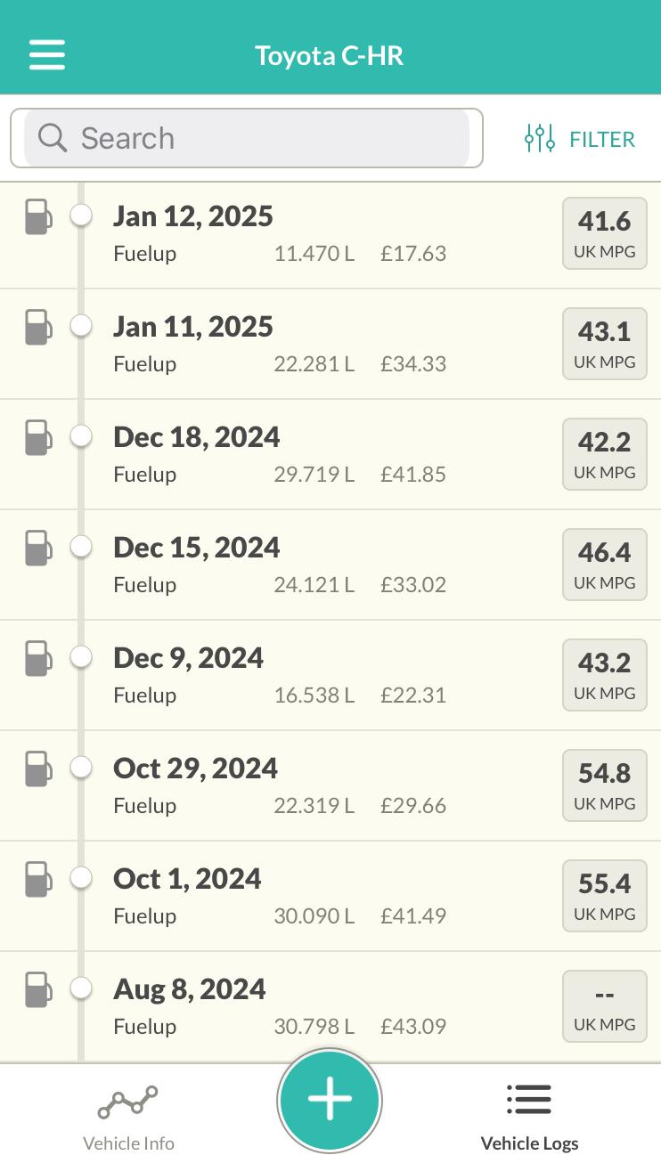

What is the largest amount of fuel that you have ever managed to add to the tank when you refuel? I suspect that it is around 33 / 34 litres?
Toyota has a habit / tradition of holding a significant amount of fuel / tank capacity in reserve. In your case, it seems to be around 9 or 10 litres - this is not unusual for Toyota.
