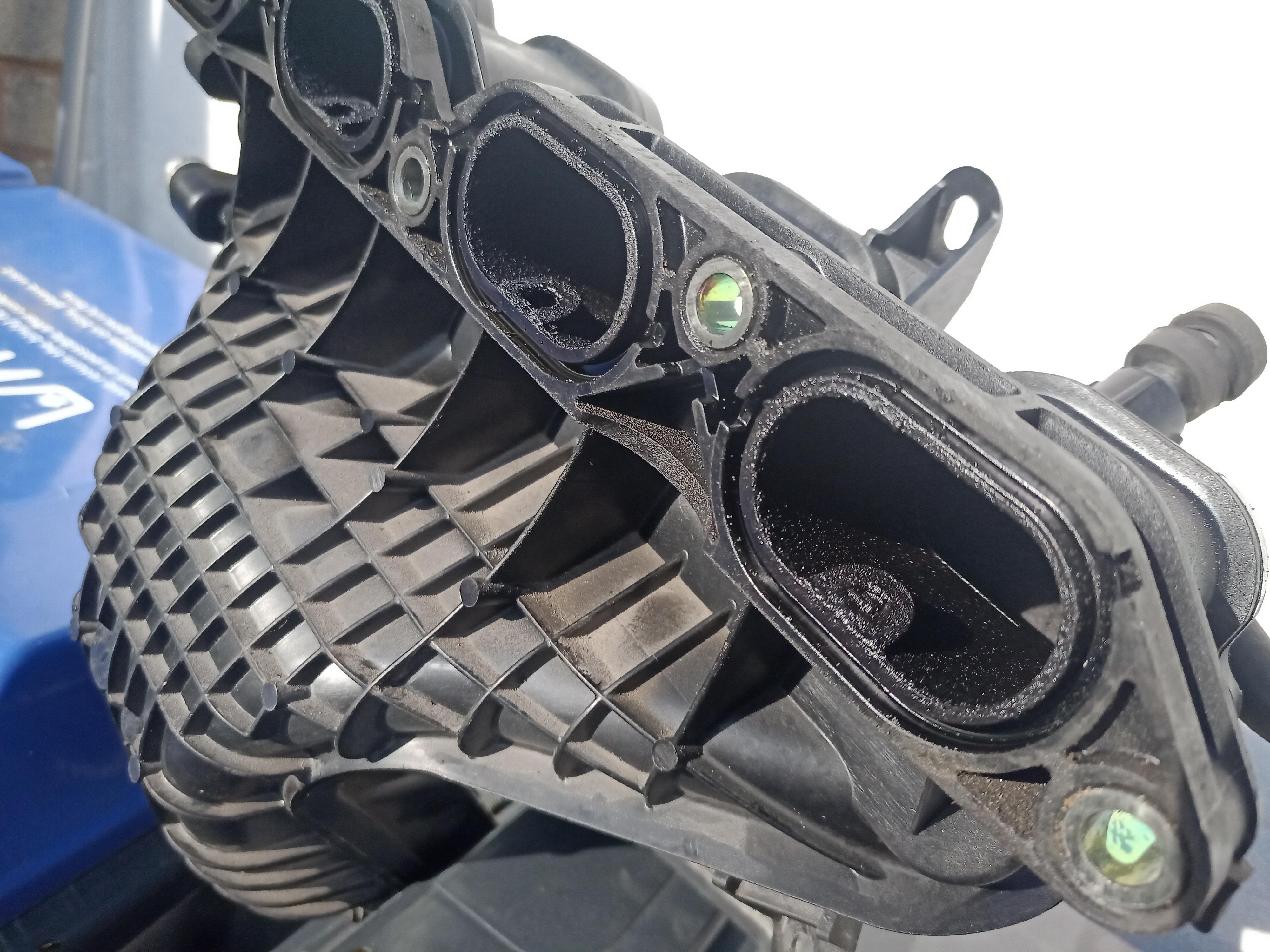

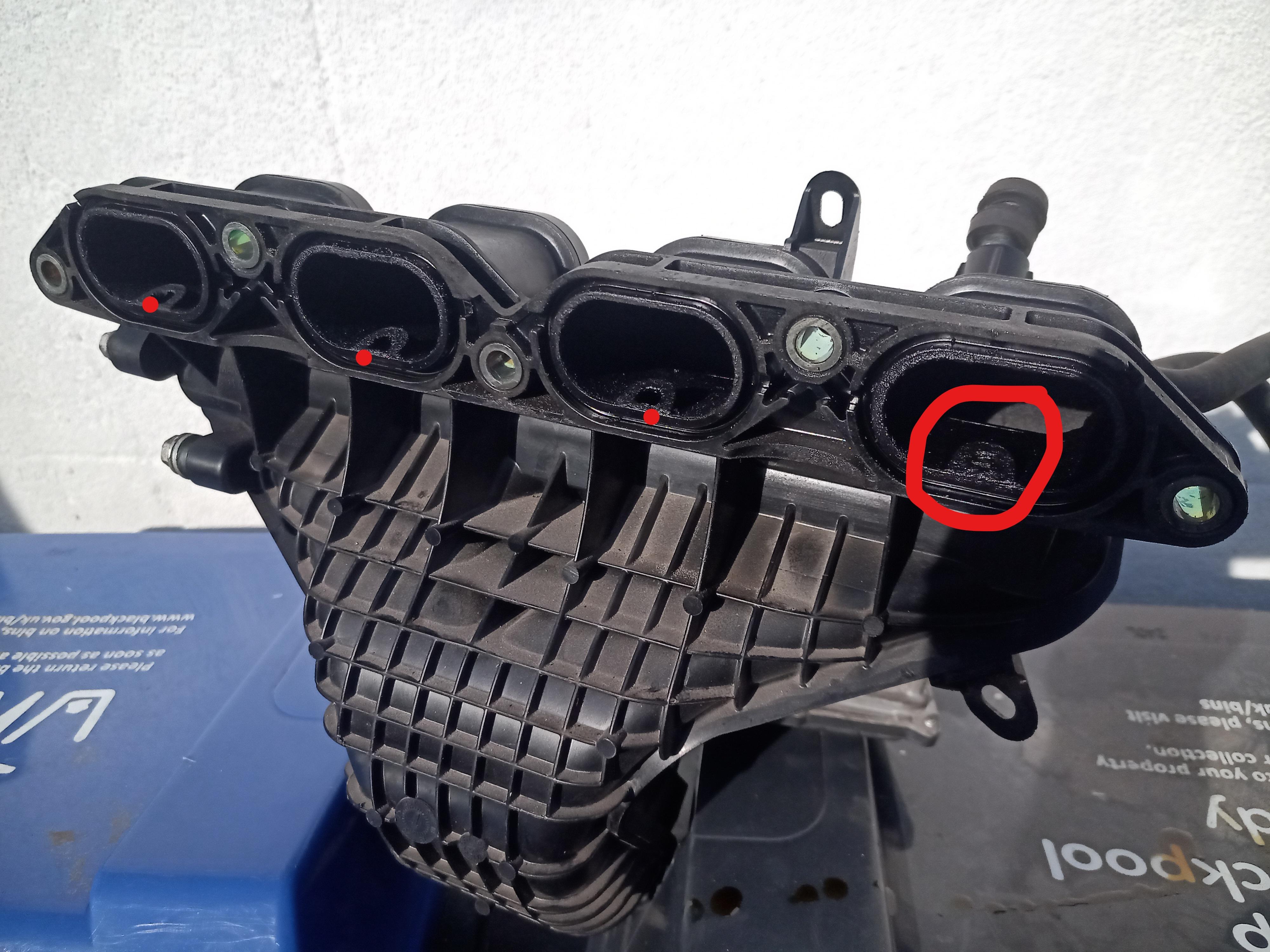

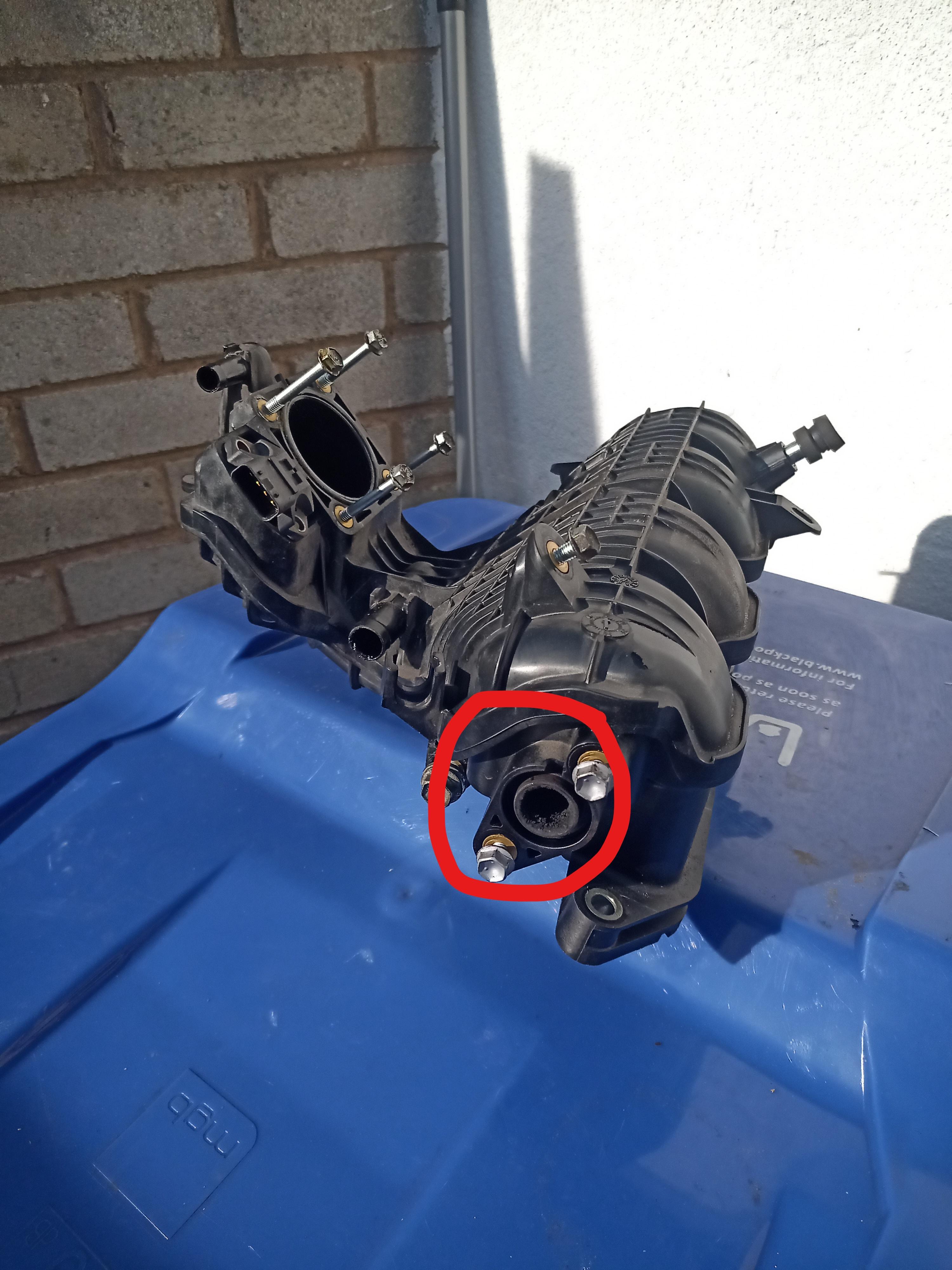

Ive fixed this issue on Both 2017 Auris and Prius...,
The main issue is the air intake manifold will be full of coke etc...
its best to clean everything together, EGR, Cooler and all associated pipes from egr to inlet manifold.
Once it can breath, it will be smooth as ever......
It feels like the plastics rattling under the car or as stated the engine mounts, but it is a breathing issue caused by coke build up. This Auris was having the issue nat 27-29mph and a couple of other ranges, NOW runs like a dream.
Below is a pic of the recent one ive taken off an Auris, this little blocked port (top right) was the issue.
See youtube for very easy DIY job.
