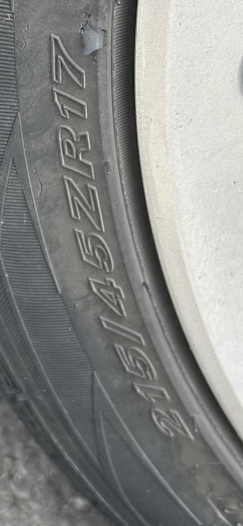

Prius tyres are 215 45 17.
My Prius has clipped a couple of speed bumps so is it possible to put deeper tyres on such as 235 45 17?

Making the tyre wider will make the sidewall slightly taller, as the 2nd number is a ratio, however it will make very little difference.
The only way to make a real difference is to get smaller rims, then you can use tyres with a higher sidewall ratio - e.g. if you went to 16" rims you can use 195/55R16 tyres
The sidewall height has to remain the same on your current wheels so that speedometer accuracy is maintained.
In order to keep the speedometer reading accurately the circumference of the wheel/tyre combination must be kept the same. The Prius wheels as in the handbook are 17in with 215/45R17W 87W tyres, an alternative is specified as 15in with 195/65R15 91H tyres. I use the 15in wheels and they are much better for comfort on our British roads. Replacement wheels are not cheap even the steel rims.
