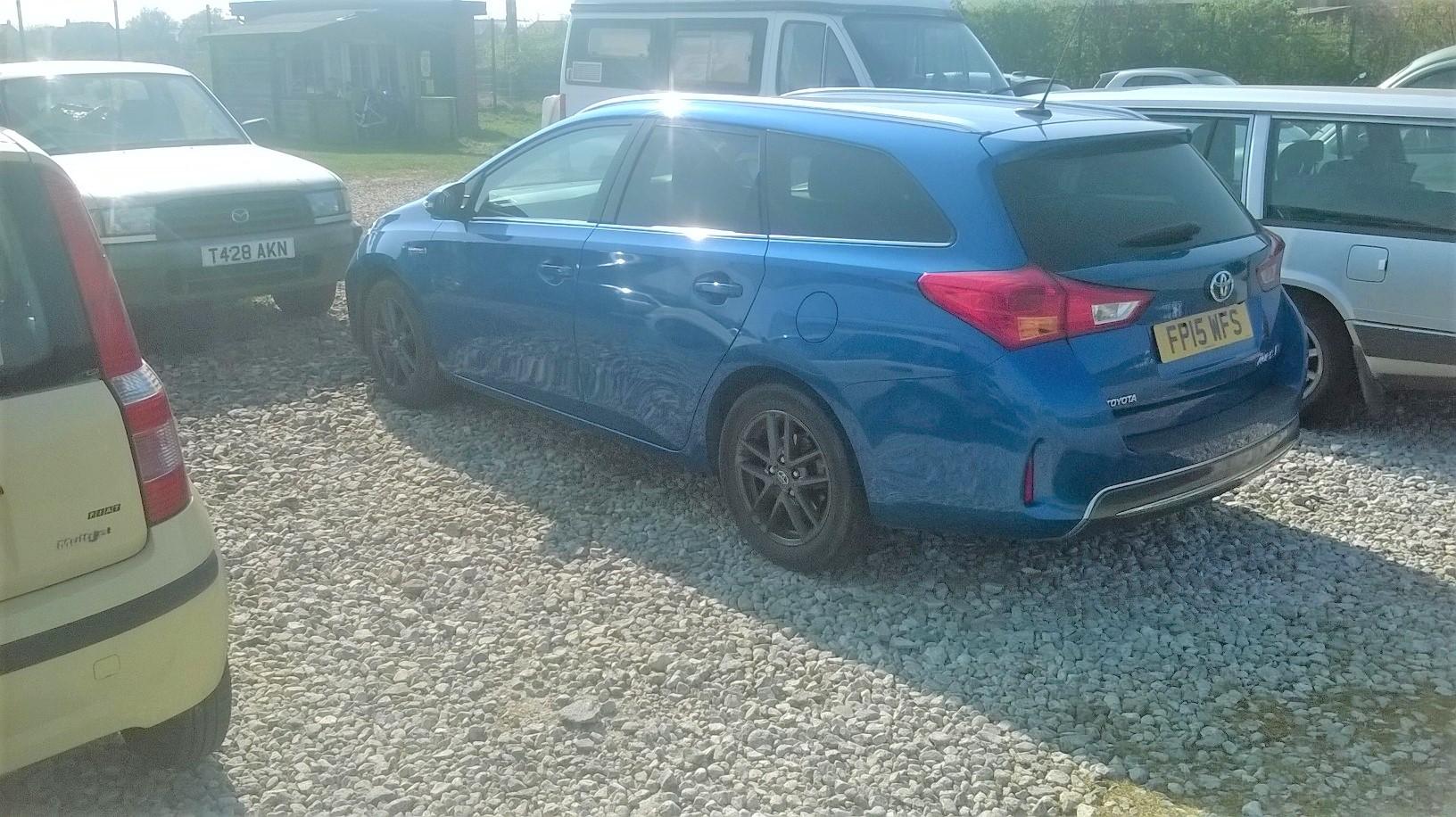

On my 2015 Hybrid auris TS the "orion" alloys are starting to corrode and flaking paint. The car has full TSH and has now done 50,000 miles. The colour matches other trim on the outside. Would have them powder coated one day if I knew the colour or RAL Number.
