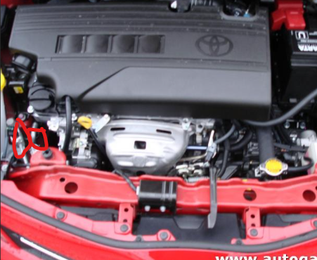

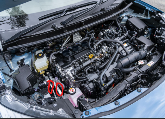

If you look under the bonnet you should spot a couple of thin pipes coming from below the windscreen area that may have plastic caps on them (which are valves... don't touch the caps and may be marked LO and HI) and one of these should pipes should feel quite cold when its all running and will more than likely be dripping wet with condensation. The other should be warm to hot.
If that is so then it means the parts that are meant to get cold seem to be doing so. Its not an accurate test of refrigerant levels but is a basic go/no go test.

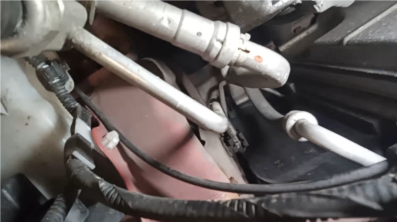

Thank you! I don't have the car right now so can't look, but the Halford's guy said the problem was likely to be somewhere in the high pressure part of the system. Toyota sent me a video for the initial repair, here's the screen grab from where they say the small leak is at the clip.
  • Like 4

I'd guess the stripped threads may be due to corrosion so they failed when being undone, but the pipework in the picture looks very clean.

In the video he seems to say the the clip on the high pressure pipe has a leak... but I think the thin pipe is the high pressure one, the thicker pipe he zooms in on is on the low side.
