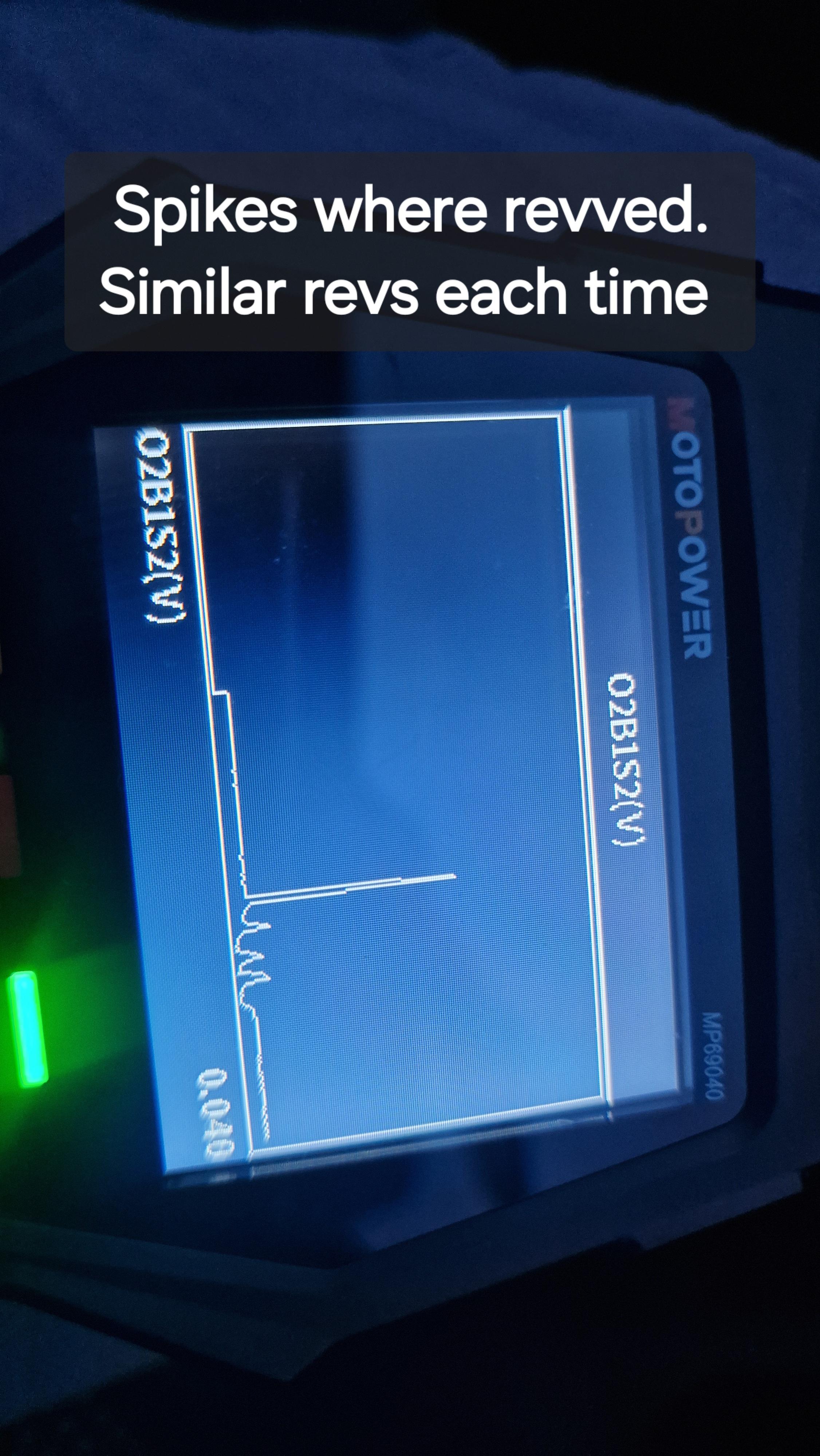

However, I have been investigating further and checking the real time graph data for the voltages of both sensors.  I understand the downstream sensor 2 is supposed to stay relatively steady at about 0.45V regardless of load.  It does seem to do this for a period of time but then the voltage drops (even to zero) and stays very low but spikes when revved, sometimes very high, sometimes just slightly even with a similar amount of revving (see pic).  I don't know if this is a broken cat or sensor 2 is faulty.  I'd have thought if the cat was faulty it wouldn't read 0.45V at all unless it only becomes apparent once heated up.  At least this is an interesting learning exercise!  I'm trying to spend as little as possible on a cheap car which we probably won't have all that long.
there are a lot of factors inc fuel trims and open and closed loop, as you rightly said the car needs to run a drive cycle let it correct trims and ignition, OEM sensors are Bosch or Denso the toyota items are around £140-160
