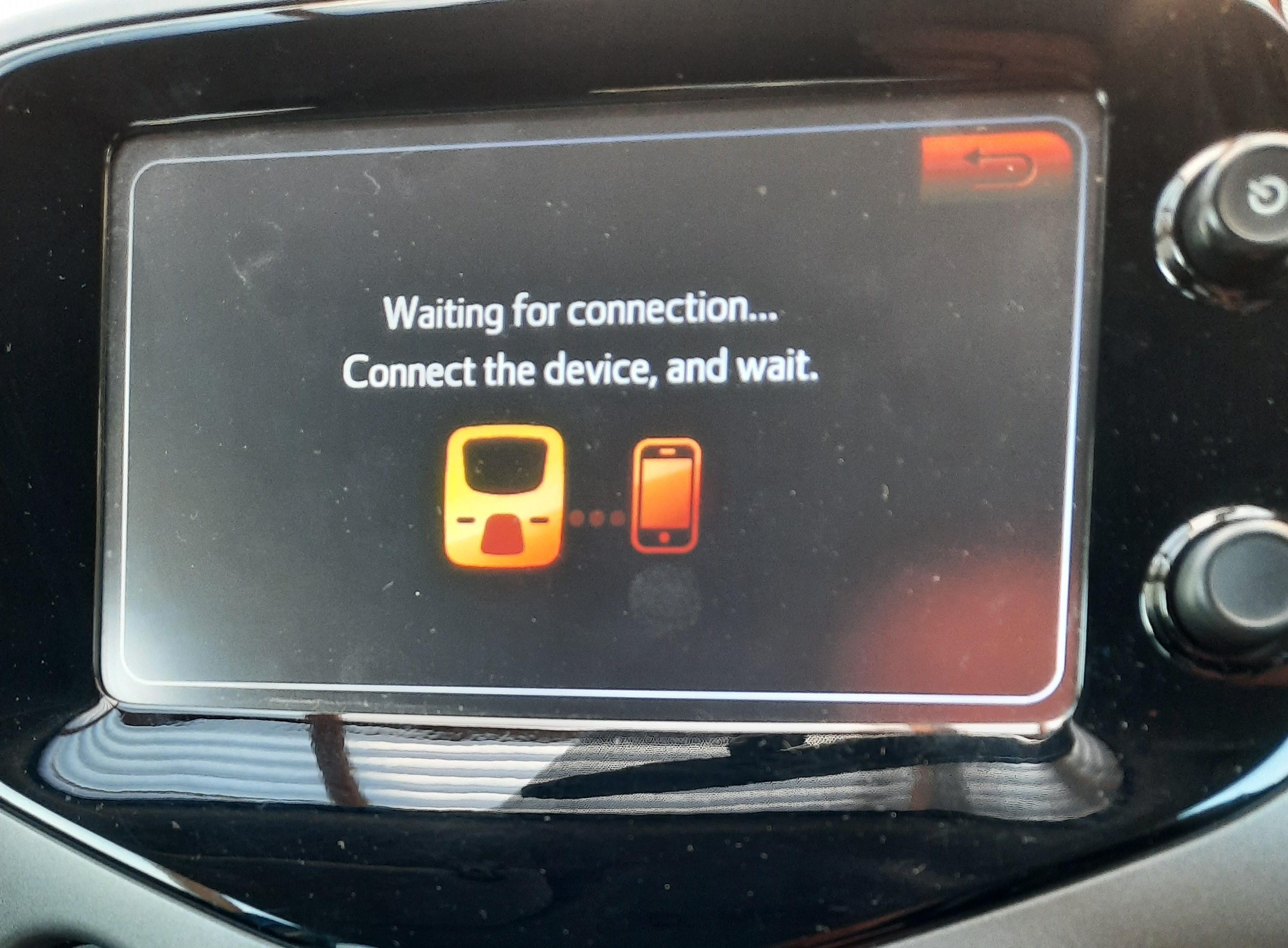

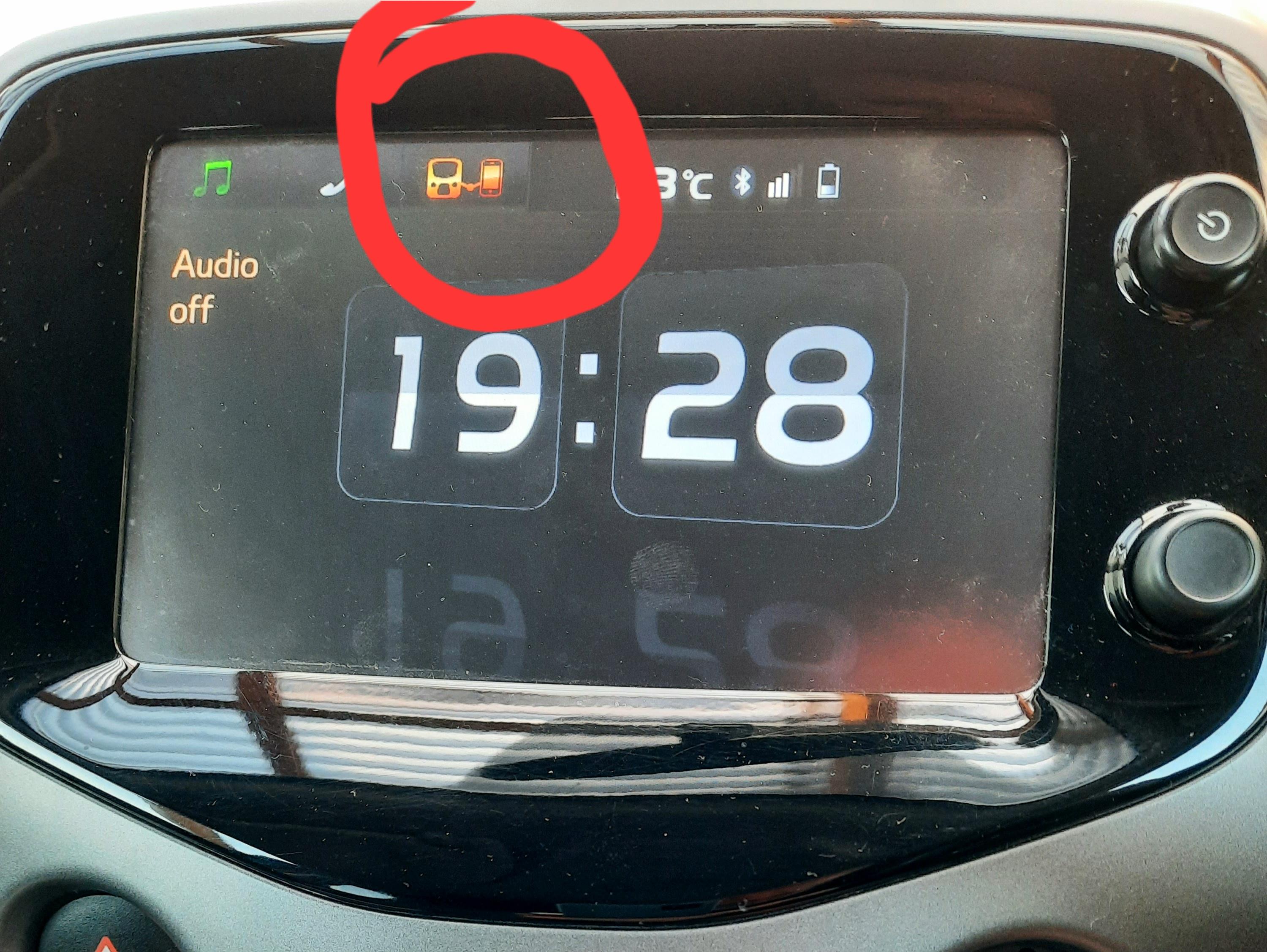

I've just bought a 2019 Aygo X-plore VVT-I, and I'm really pleased with it. My only issue is in connecting my phone to it using USB. I've tried using both my own and my wife's phones, both fairly new Samsungs. The result is the same for both. When I select the connection icon (circled) on the car screen, it goes to the "waiting for connection" screen. I connect my phone using the USB cable, but nothing happens. After a short while the "waiting for connection" screen times out and disappears. I'd really appreciate any advice that anyone can provide to try to resolve this.

I've found a solution to this, or at least a partial one. My Aygo has a two button infotainment unit, and I now understand that only the three button units support Android Auto.
I still have a question though. Why does my unit have an icon for connecting my phone to the car, when it's impossible to actually connect my phone to the car??

Clarify:
It is impossible to connect to connect through USB.
You need to connect it with bluetooth (wireless).

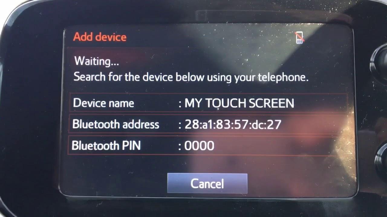

Bring up this screen:
Open up bluetooth on your phone, then look for "MY TOUCH SCREEN".
You'll need to give it permission to use phone contact / messages / audio etc.
Open up Bluetooth on your phone, then look for "MY TOUCH SCREEN".
Yes, thanks, I know all that. The icon has nothing to do with bluetooth. It seems to serve no purpose.

Re the connection icon, that only works with much older phones from around 2014 (when the mk2 was introduced) and then you could get a nav app, but later operating systems are not compatible with the system
