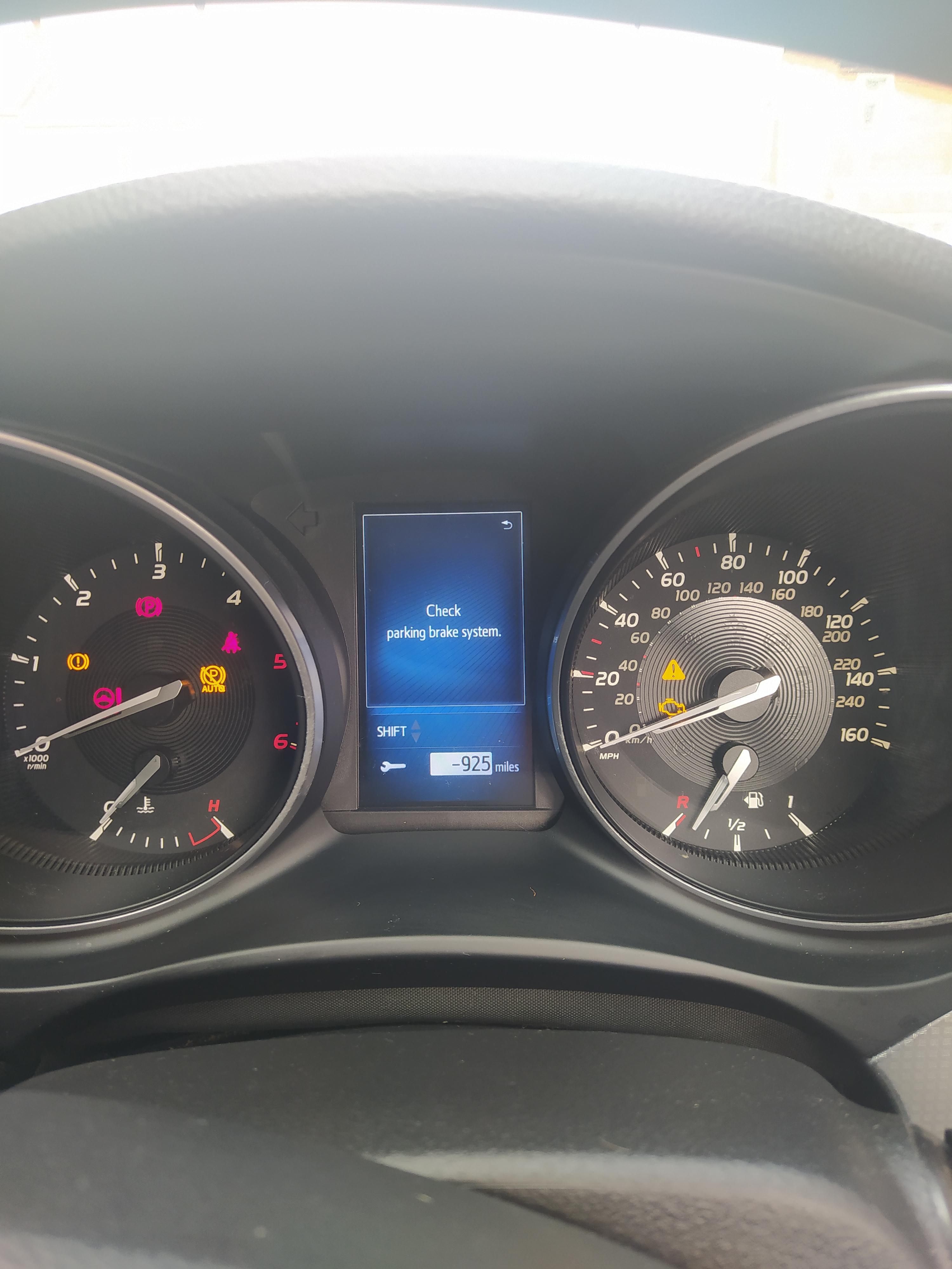

Even after obdll reset many many many times, even main dealer Wigan branch they come back.. Display says check parking brake system.
Had these faults 2yrs my head gonna explode...HELP....
These errors are MAF sensor and EGR valve so why would check parking brake system show on dashboard...
Hi Shaun,Since you’ve been dealing with these issues for two years, it seems like they’re quite complicated. IMO I think it might be a good idea to see an auto electrician. They’re specialists in electrical problems and will find the issues that general mechanics can miss. They use advanced equipment that can read specific codes and diagnose the electrical systems in your car, including the ECU and sensors. They can give your vehicle a thorough check to find any underlying problems affecting the MAF sensor, EGR valve, and parking brake.They can also perform any necessary software updates to the control units, which might help fix these ongoing issues. The other option is to get a second opinion from another dealer.
For some reason, the check parking brake warning message is often displayed when there is a problem with any system on the car. So in short, your car has a problem with one or more systems, and probably not with the electronic parking brake, especially as the codes you quote are for the MAF sensor and EGR valve.
I can only echo what Bper has already said. Ask a good auto electrician to look at it, or take it to a different dealer.
