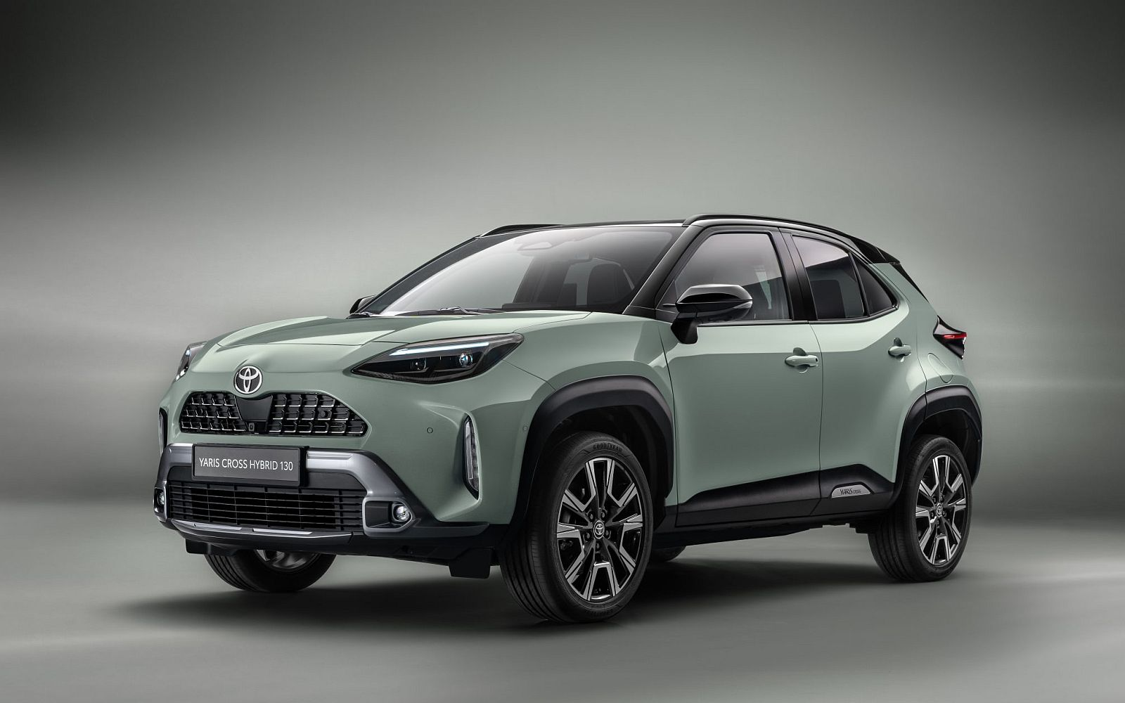

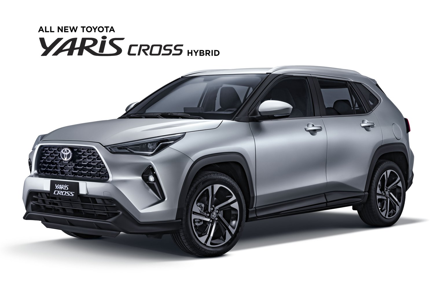

Aside from the above, some Asian/South American markets have a different bigger Yaris Cross to Europe:
Europe
image.thumb.png.0b8f9dc1394471ae920680bf03249f57.png.
Asia/South America
Is that not the Corolla cross?, not available in the uk.
No.
No. Developed by Daihatsu and launched in 2023. Built in Indonesia and exported to 25 Asian/South American countries.
Not much bigger that eu version but totally different, and smaller that Corolla cross.
