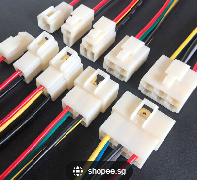

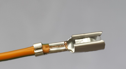

Intermittent faults like this can be very very difficult to trace but a big clue with this one is that it seems to respond to a good 'whack'. Personally I would look at waggling any and all connectors around the dash and under the dash to see if the fault can be recreated.
Typical issues could be a poor crimp in a multiway plug socket or even a bad earth where a bunch of wires are bolted to for example the body work around a door frame.
These kind of connectors can be problematic if the wire crimp is faulty. This is one wire in for example a multiway socket.
