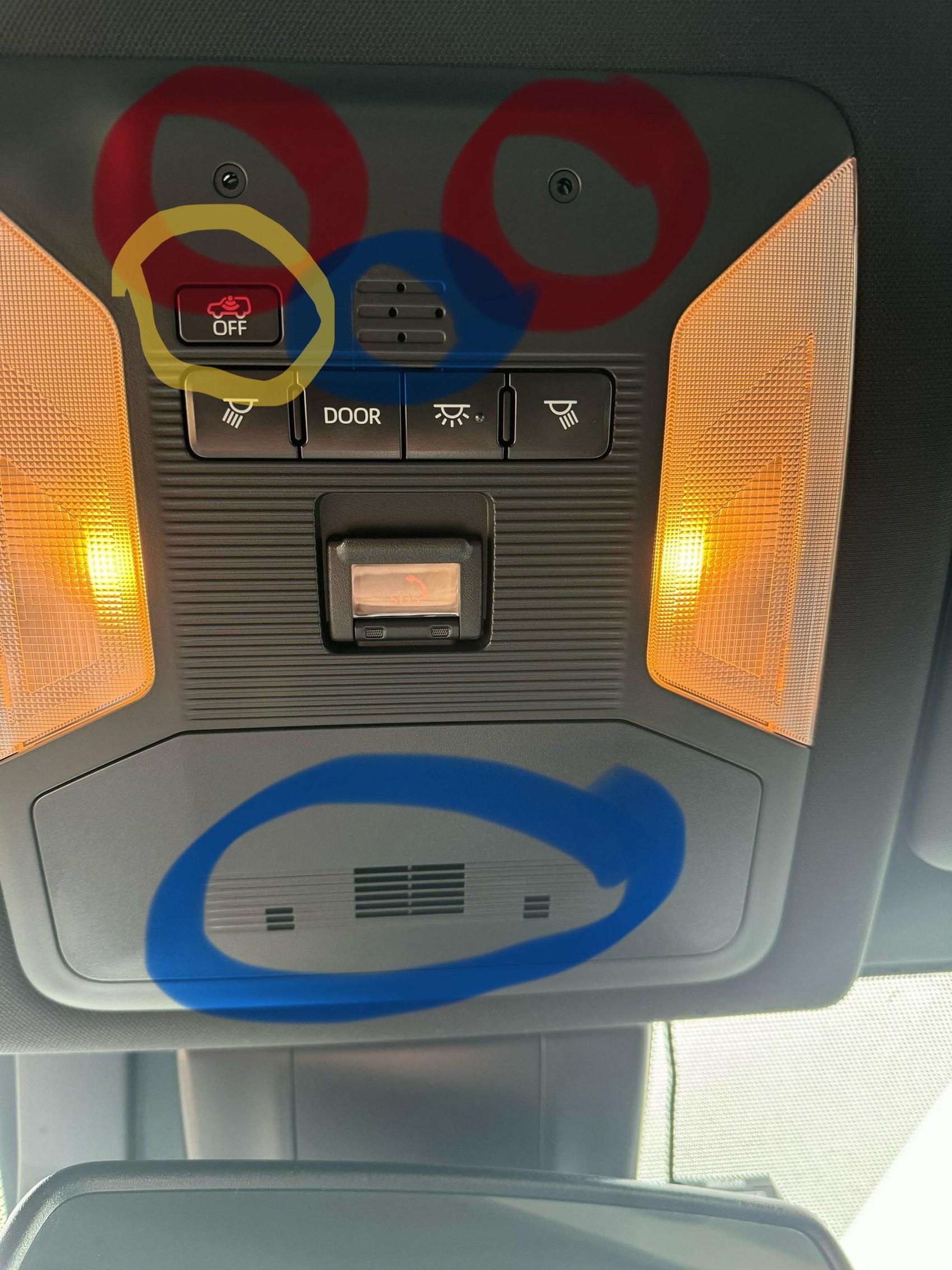

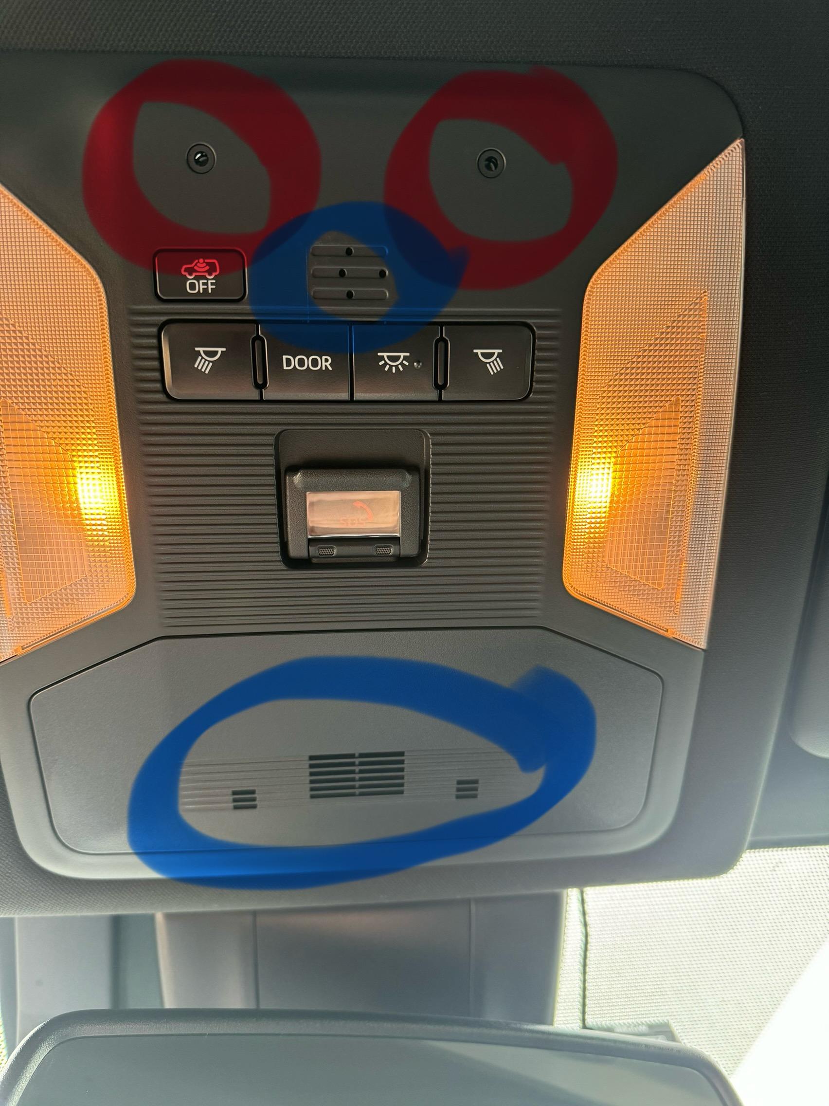

I’m sure the holes in the red circle are the alarm .. and I also hoovered the slits circled blue …I don’t think there alarm related but I did it anyway….
is there anything else I can hoover or try 😊
The things circled in red are, indeed, the intrusion sensors.
The things within the blue circle are the microphones and SOS speaker.
Low frequency noise will set it off. But not in an obvious way.
The sensors are ultrasonic and detect changes caused by movement.
So flies, moths, and other critters will set it off by their movements.
Low frequency noise caused by a variety of sources from aircraft to tractors cause soft furnishings in the car to vibrate and that movement is what sets the ultrasonic intruder detectors off.
Either way it sounds like they are too sensitive.

Press the button ringed in yellow before you get out of the car ...
