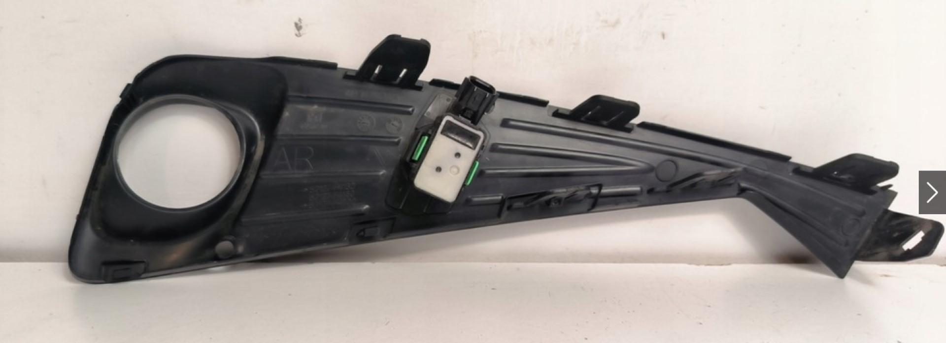

Here a picture of the bumper to familiarise yourself.
Good luck
https://www.ebay.co.uk/itm/335512394768?mkcid=16&mkevt=1&mkrid=711-127632-2357-0&ssspo=t8XwiQdsTJS&sssrc=4429486&ssuid=p34UK1z2T4m&var=&widget_ver=artemis&media=COPY
the fog is screwed to the trim, the trim is screwed to the bumper a total of 6 screws the hole cover is just clipped in place
links are just for reference they are just picked at random
eg.
https://www.ebay.co.uk/itm/355476415395
the GR sport has a different front bumper from the other c-hr's (apart from the excel)
standard hole cover
52127-f4160
GR-Sport
52127-YP440
